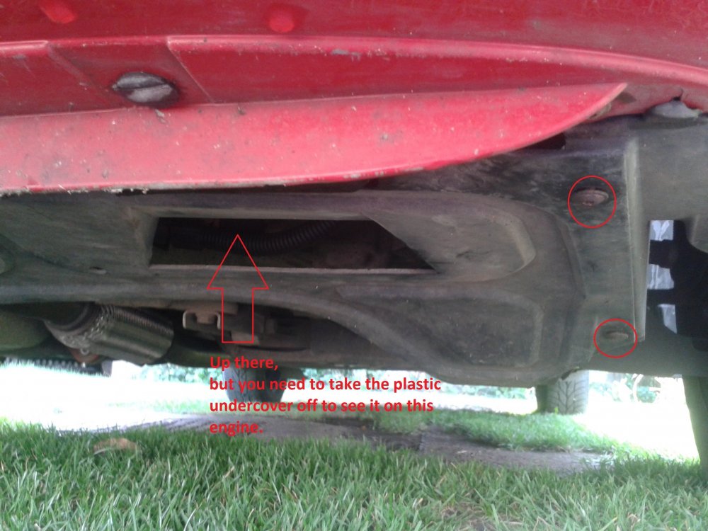

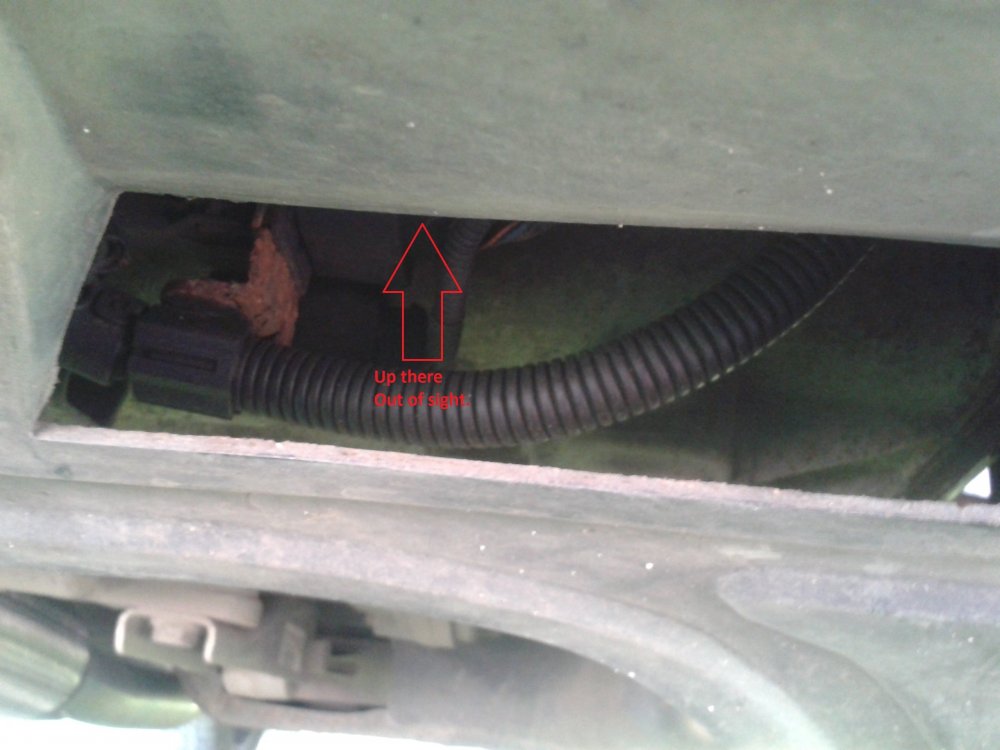

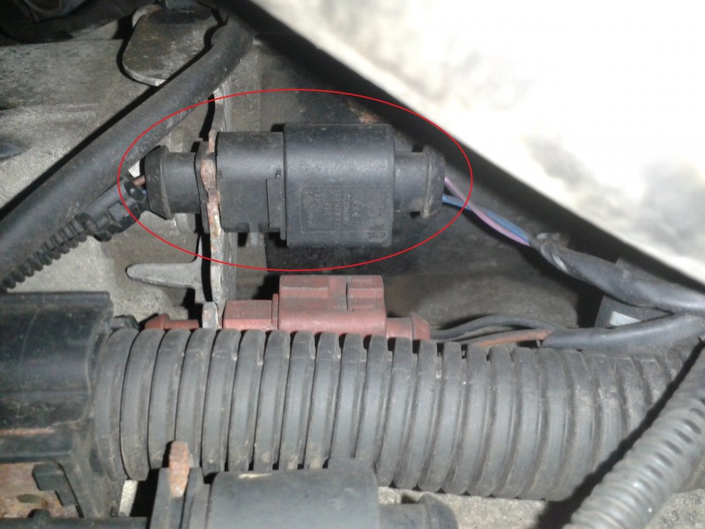

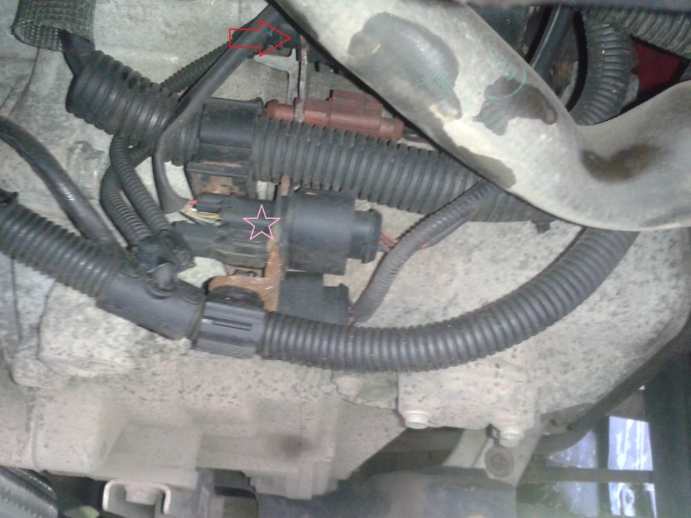

  • Its a connector pair, a plug mated with a socket, which side of the metal bracket is yours busted left or right?   One side (left in my pictures) goes off to the alternator, the other (right) side t
