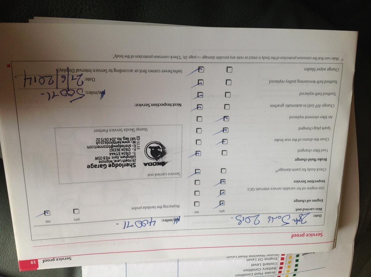

No guarantee that the Drums were removed at the 2 year 20,000 mile service, or 40,000 mile, did you get the Brake fluid changed at 30,000 miles or 40,000. (or being left to 3 years)

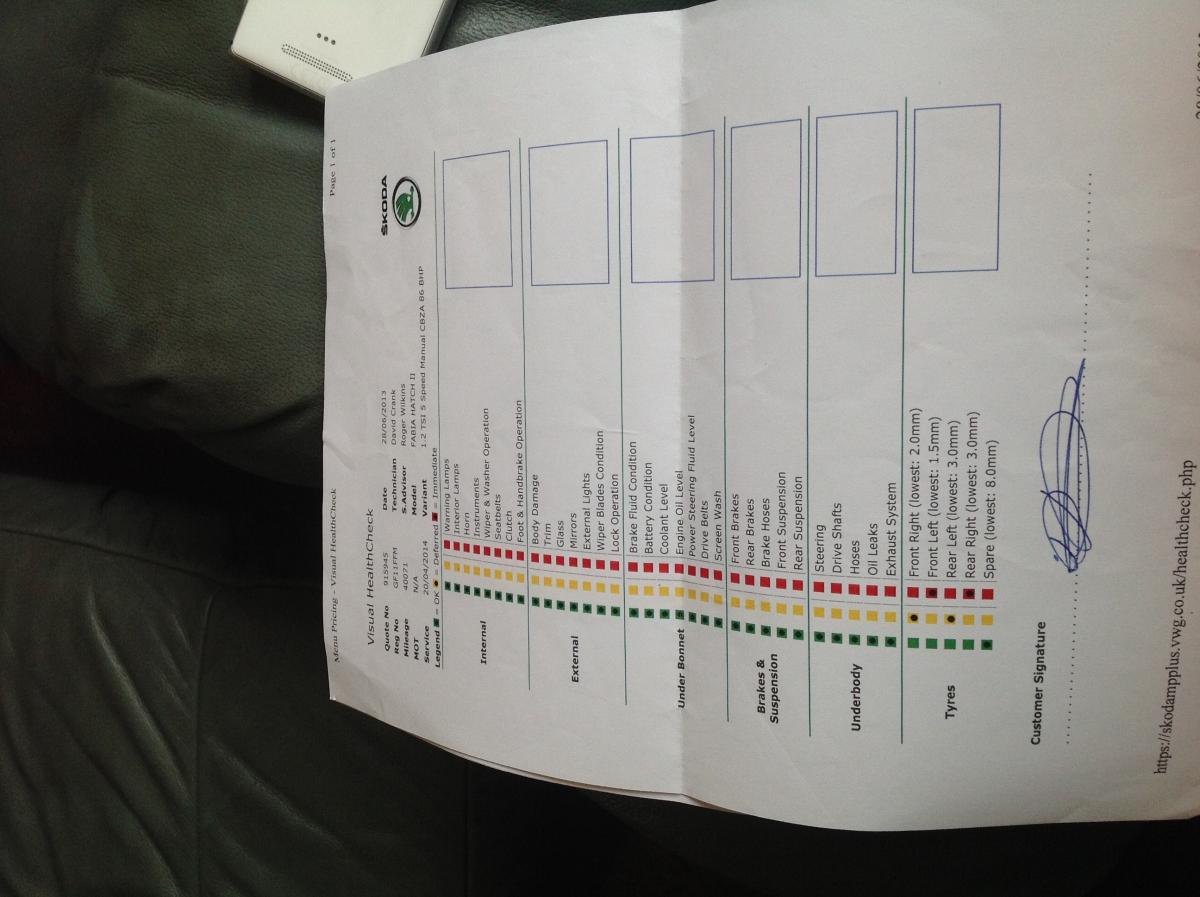

Is there an invoice & a '40 point Health Check list'  ALL TICKED,or the likes, that you got after servicing? 'The Inspection Service'.
Maybe the Hand Brake cable was adjusted at 40,000 miles, maybe the drums were off,  but you need some indication from those that serviced it.

Well its done 42,000 last service 40k marked everything (except my tyres at the time) as green service book also states drums removed and cleaned.
Ive noticed onces or twice the handbrake stick on the same side put kind of ignored it as lack of use.

The garage will know if their technician did remove the Drums when doing the service and check he Brakes or just cut corners and save 20-30 minutes.

The problem with that is, at the last service my tyres needed doing which got done else where so i have no reference point as such, other then that the tyre company that done had trouble removing the wheels (ie they needed a bit of thump) but this was 2-3 weeks after said service so tbh i didnt think id get any joy by making a point of it.
Now should it be a adjuster do you think its something you would notice an issue with 2months before it could fair???

ASK THEM,  ?? Did you remove the wheels at the service or did you not?
Where the Drums removed and the Rear Brake Shoes inspected?
**If the wheels were not off, then the DRums were not off., obviously.**
They know if their Technicians do or not do the job they get paid for.
