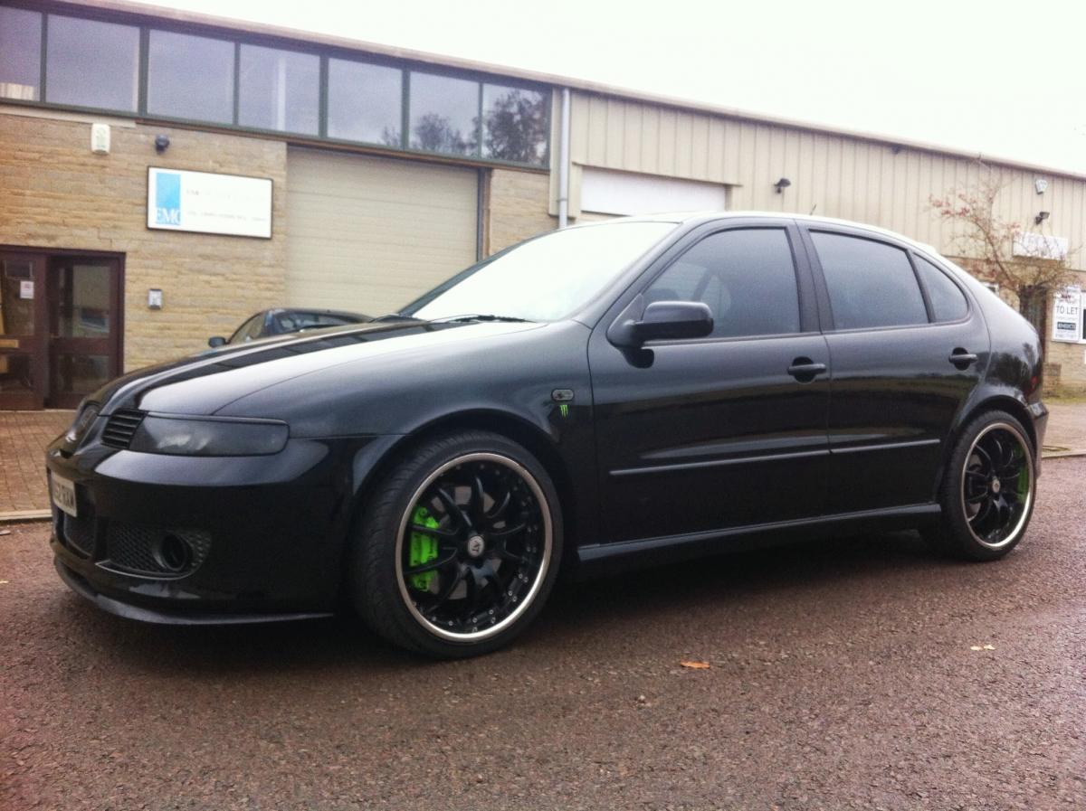

My old LCR had green brembos...
Think I will get my mate to powder coat them black..keep it stealth..
EVO 8 BREMBO calipers on Mercedes Benz ML500 discs(345x32) on special mounts.
Rear AUDI S3 front discs(312x26 machined to 22)on AUDI S3 rear calipers.
sure can lol
spiders wont fit without 5mm spacers tho, and the TD pr 1.2 there need 3mm to clear them
car wasa undergoing a lot of work here hence the mess.
last one
They look smart Billy,
Where did you get them?
got the callipers and carriers off ebay then spent a few weeks totally rubbing them down and sorting them out, masked off the pistons and had some paint mixed up at the local paint place to match the vRS calliper colour.  took a lot of prep on the callipers but got there.
also had the carriers blasted too and painted them lol.
was all so the car looked like new again but ended up breaking her instead.
gutted!
