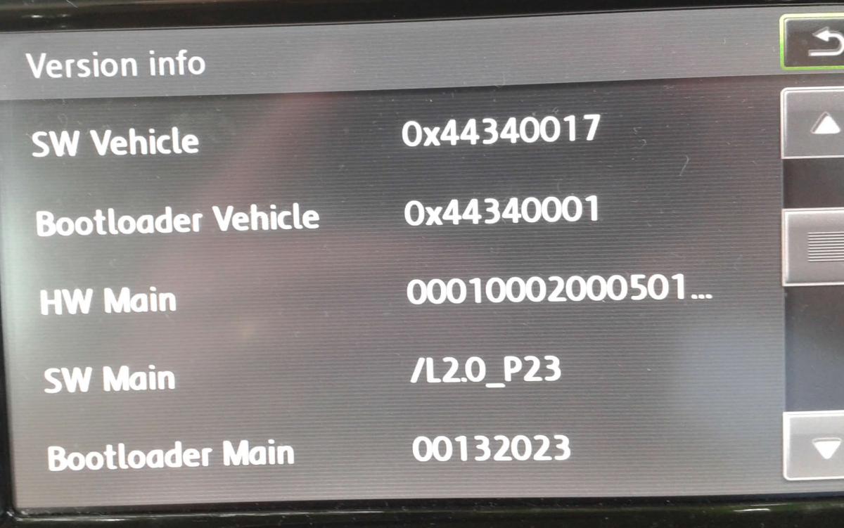

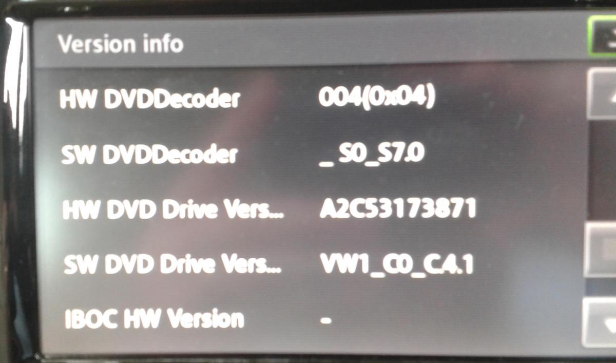

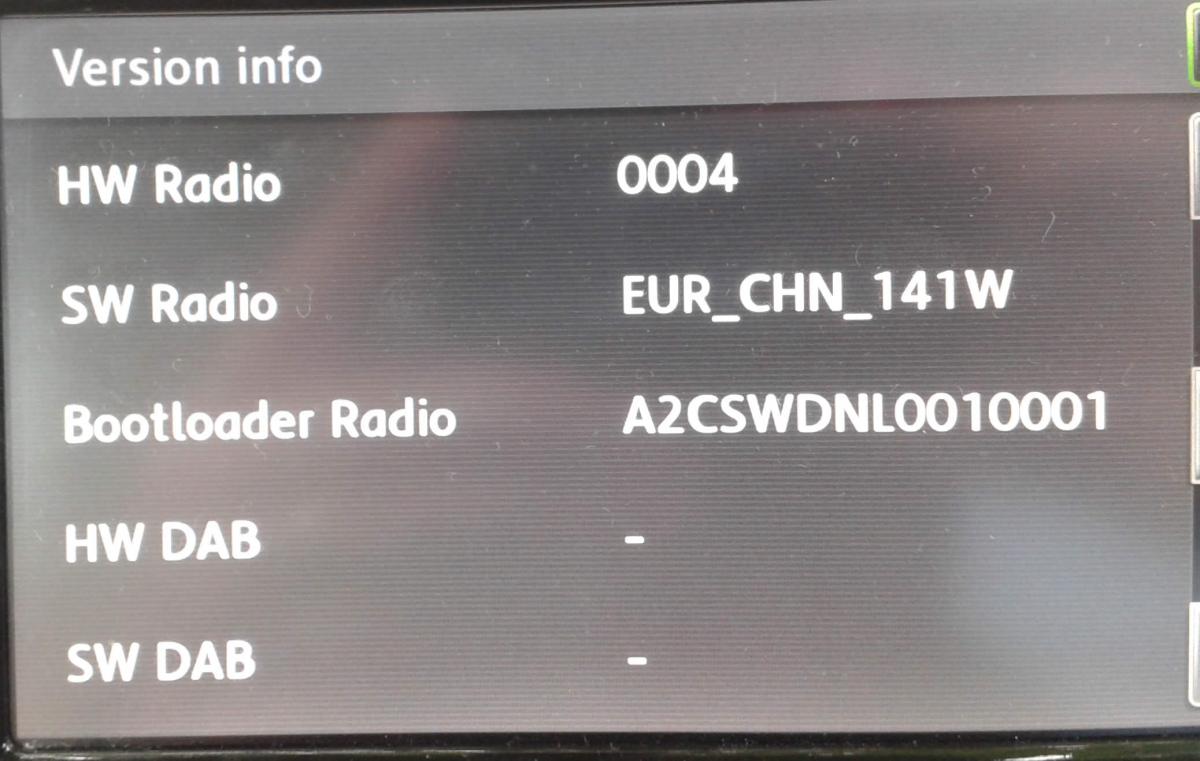

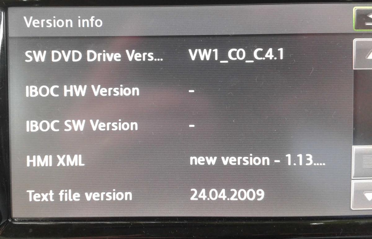

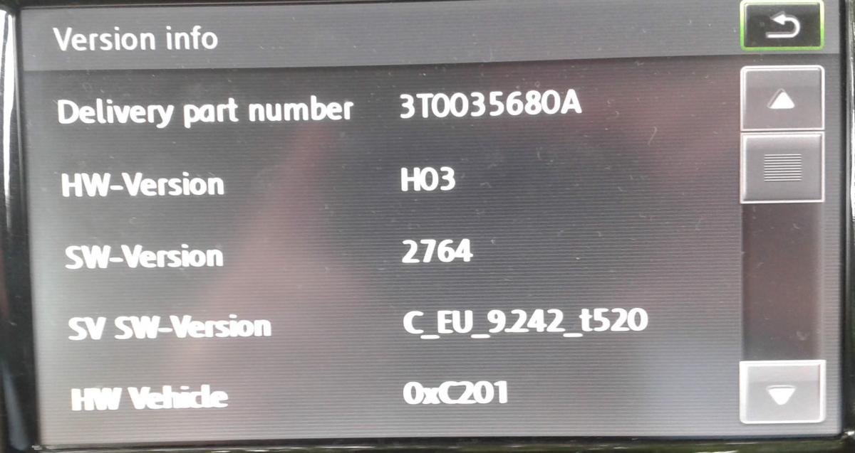

I have a copy of ver 4020 but I don't know if that is too recent for my unit. Not sure what revision Columbus I have but have attached the screen shots of the setup screen.

4020 should be fine.
Yours shows the same part number as mine and I'm on 4020 without issue.
HTH

No need for a modified firmware. I've help several people (including myself) go from 3T0...A units to 4020.
The confusion comes over the part number suffix and the revision letter. 3T0...A is actually a 'C' revision, which explains why it works without modified software.
I went to 38xx first because that was the best available at the time, then went to 4020.
I've have supplied firmware to several people with 3T0...A units to go from 2xxx or even 1xxx firmware straight to 4020. This is the firmware linked to on the My Gti website. Nothing special.
