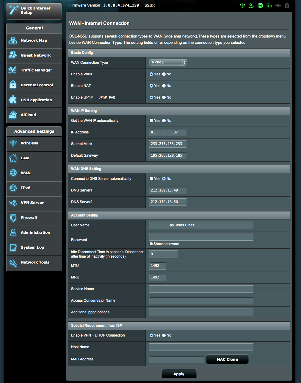

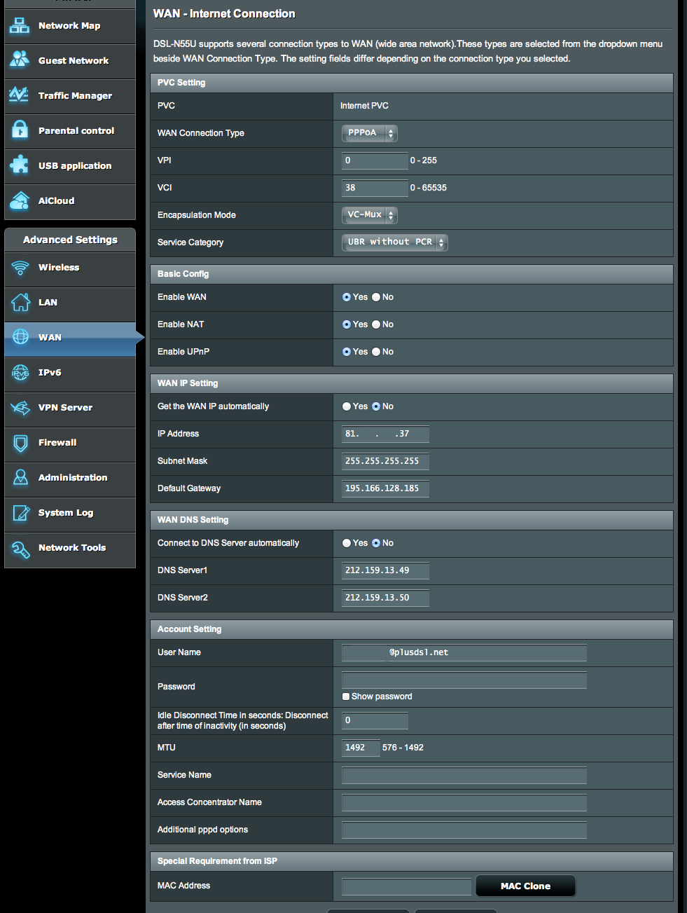

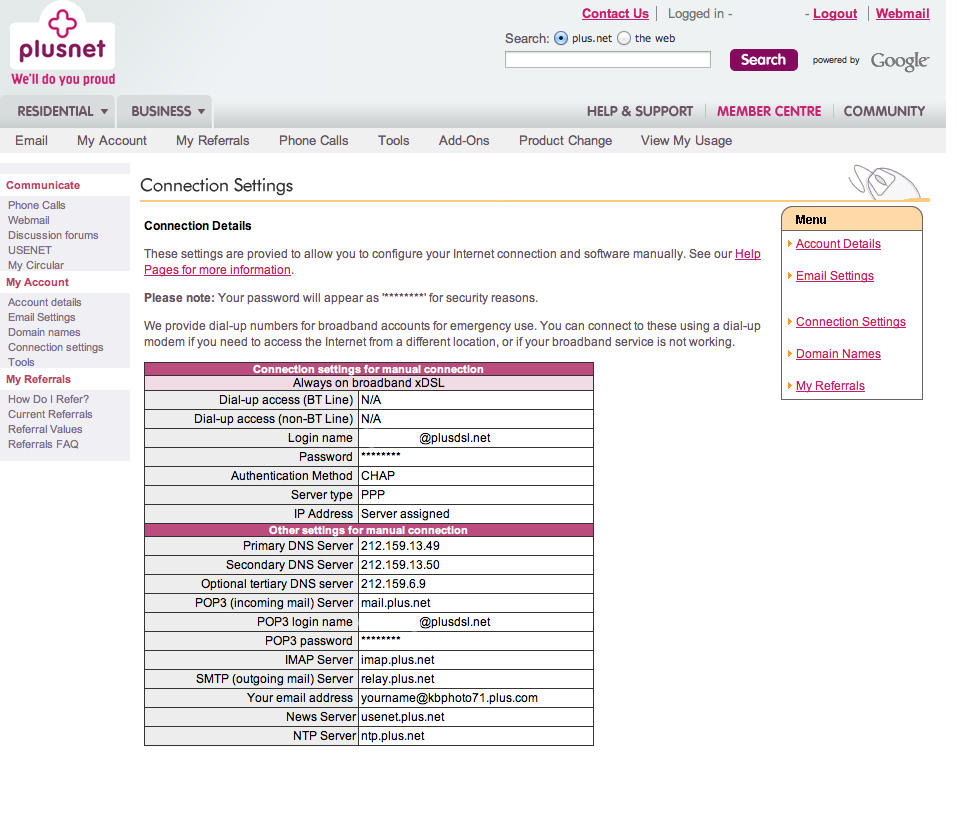

Screen shot 1: Details provided by ISP (along with a static IP address and a netmask)
Screen shot 2: Router config page accessed by clicking on WAN in the menu down the left and creating a PVC setting... PPPoA is an option and selected (Parts of IP address and password, etc, have been blacked out)
Screen shot 3: Second way to access WAN settings (note it is not highlighted on the left) is by going to 'Network Map' > Click on the 'globe' > the 'Go' under internet status.
I'm wondering if I should delete the PVC settings (whatever that is) and allow the router to do its own thing...

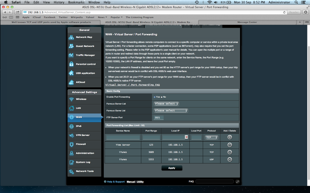

Simple question: I'm supposed to 'open' three ports on the router to allow home sharing to work (no idea why as it works when connected via ethernet).
See screen shot:
How to do forward the ports correctly (the IP address shown is the static IP allocated by the router to my server - the server picks it's IP address up from the router using DHCP)?
I'm trying this in the vain hope that it might overcome the problem (but I doubt it).
See screen shot:
You are in the wrong section, you are in WAN.
You shouldn't need to set that port forward up unless your clients are connecting from the internet into your private LAN. Your server shouldn't be picking up DHCP - You should have set the server with a fixed IP address and then created a reservation within DHCP so that the router doesn't give out the IP address you have chosen for your server.
Not sure why it wouldn't work for home sharing over wireless, some setting within the wireless settings may need changing - Do you mind taking a screenshot of the LAN, Wireless and sending me via private message a screenshot of the Firewall section - obviously blanking out anything that is personal so I can take a look see what settings you have enabled that might be causing your issue.

I think I've followed mannyo's instructions to the letter (substituting my IP addresses).
Although there are some differences in terminology on the Mac, I'm pretty sure I've got it right.
Mac Server is dishing out IP addresses;
Clients can log on (wired or wireless);
However, still no home sharing on wireless devices (Ethernet connection works fine).
Any other suggestions on this one?
Can all your devices browse the internet, have your tried pinging all the devices (including the wireless ones) from an ethernet connected device. Perhaps from your mac server, go into utilities and terminal and ping from there.
Make sure you have restarted each device, make sure that they are actually using an ip address from your mac by checking the address leases.
Check the mac firewall settings as well, system preferences, security and privacy. Also check the sharing settings.
Unless your going out over the internet, the ASUS router should just be behaving like any other 10/100/1000 network switch and not filter anything.
If you want to revert back to how you were before, disable DHCP and DNS on the mac server, and turn DHCP back on in the router.
