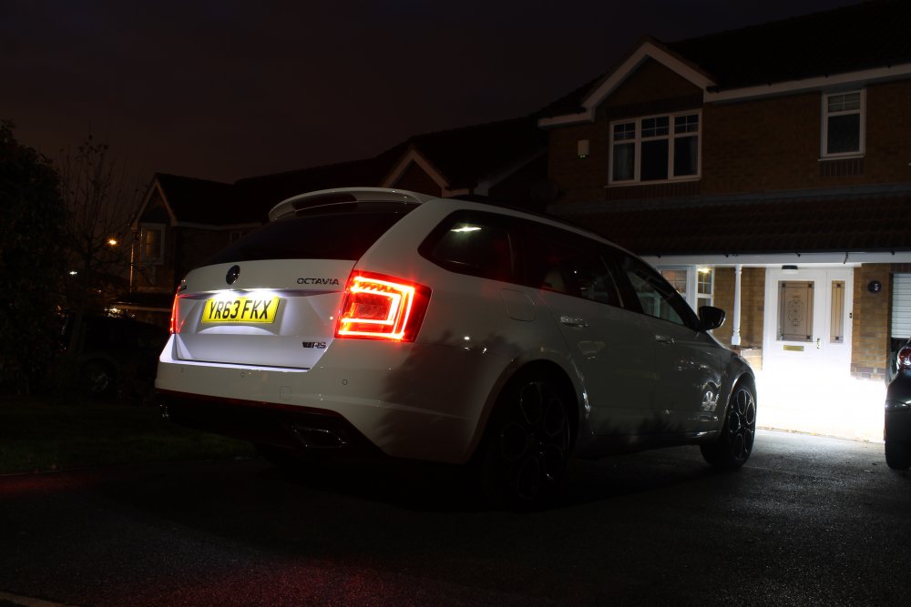

Tried these today, they work however out the light on the maxidot as expected. They don't fit in due to a piece of plastic on the inside of the unit, this can be cut off and will be so I'm happy :)
Fitted and working perfectly :) love them looks miles better and much better OEM coloured light unlike the cheap ebay ones i had in my mk2.
