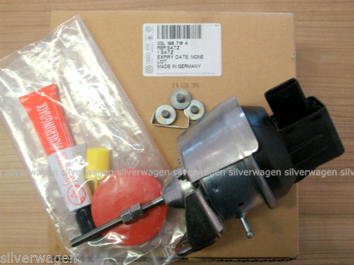

Skoda sell actuator repair kits for the 170 PD/CR turbos, have you checked with a dealer?
Do they? The electrical connection on the top of mine seems to be the issue though!?!
Yeah, quite a common fault. They started doing repair kits for them 18 months ago or so.
Says it won't work on a Garrett turbo, mines a garrett :(
Yes but I said like that. I believe VW/Skoda do the kits for both.

Hi guys. Any info on what could of happen to the actuator.
Skoda superb 2011 2.9 170
Looks like silicone grease.
