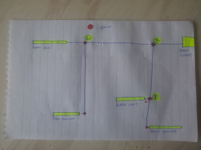

These will all be wired in to the main light unit upfront, Passenger side to the passenger reading light and drivers side to drivers reading light, this will mean that when the doors are opened all lights will come on and go off but if you turn the driver or passeneger reading light on then that sides LED lights will come on also.
The light strips i have chosen are the same ones as i used the boot lighting thread, however if i find there just to bright then i can cut the strips down, which i think i'm going to need to do.
So heres my plans for the wiring of the lights, there not to scale but show a rough idea on how im going to run the lights wiring and connect them all.
This is an overview of the whole side wiring loom:

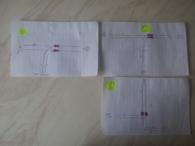

Next this is a close up of the numbered splices from the above diagram:
1)
2)
Please read on.....
http://www.flickr.com/photos/79164476@N08/10098900575/
Splice No. 1: http://www.flickr.com/photos/79164476@N08/10098936066/
Splice No. 2: http://www.flickr.com/photos/79164476@N08/10098961023/in/photostream/
Splice No. 3: http://www.flickr.com/photos/79164476@N08/10098964563/in/photostream/
Over view of all splices: http://www.flickr.com/photos/79164476@N08/10098967683/in/photostream/
Ill get some photos in a bit of where i plan to mount the lighting in the car and upload them.
Any views/points please let me know!
