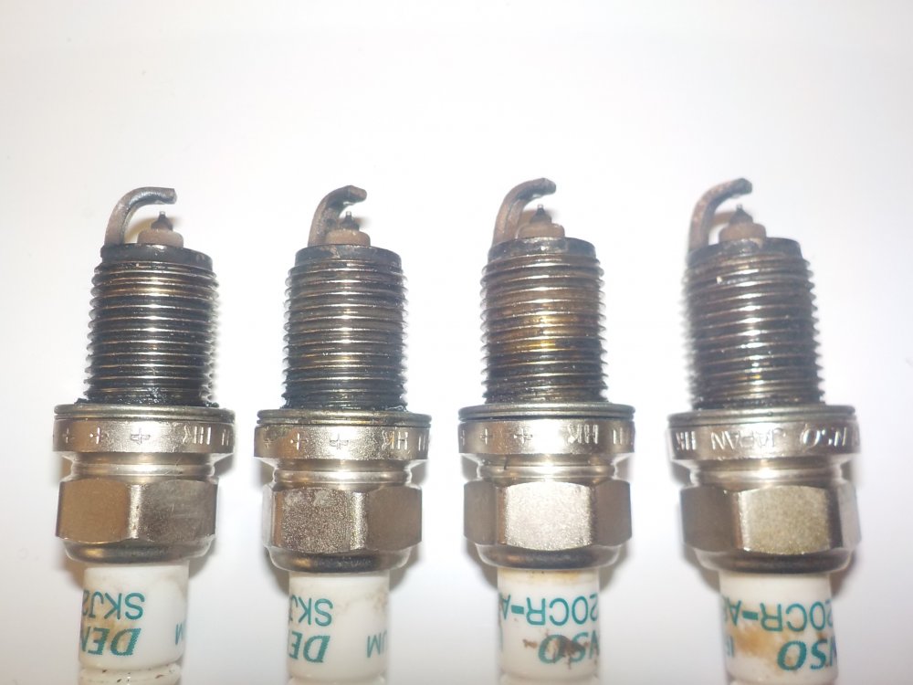

  • Here's mine today when I removed them for compression test, 11,000 km on them currently. I think they can comfortably go to 20K (km) ?
What do you think to the condition of these Denso plugs?
Been in about 5-6 k

Look OK apart from the one that is getting oiled and then cooked.
The cylinder you probably have the misfire in and that has the valves might be looking ropey.

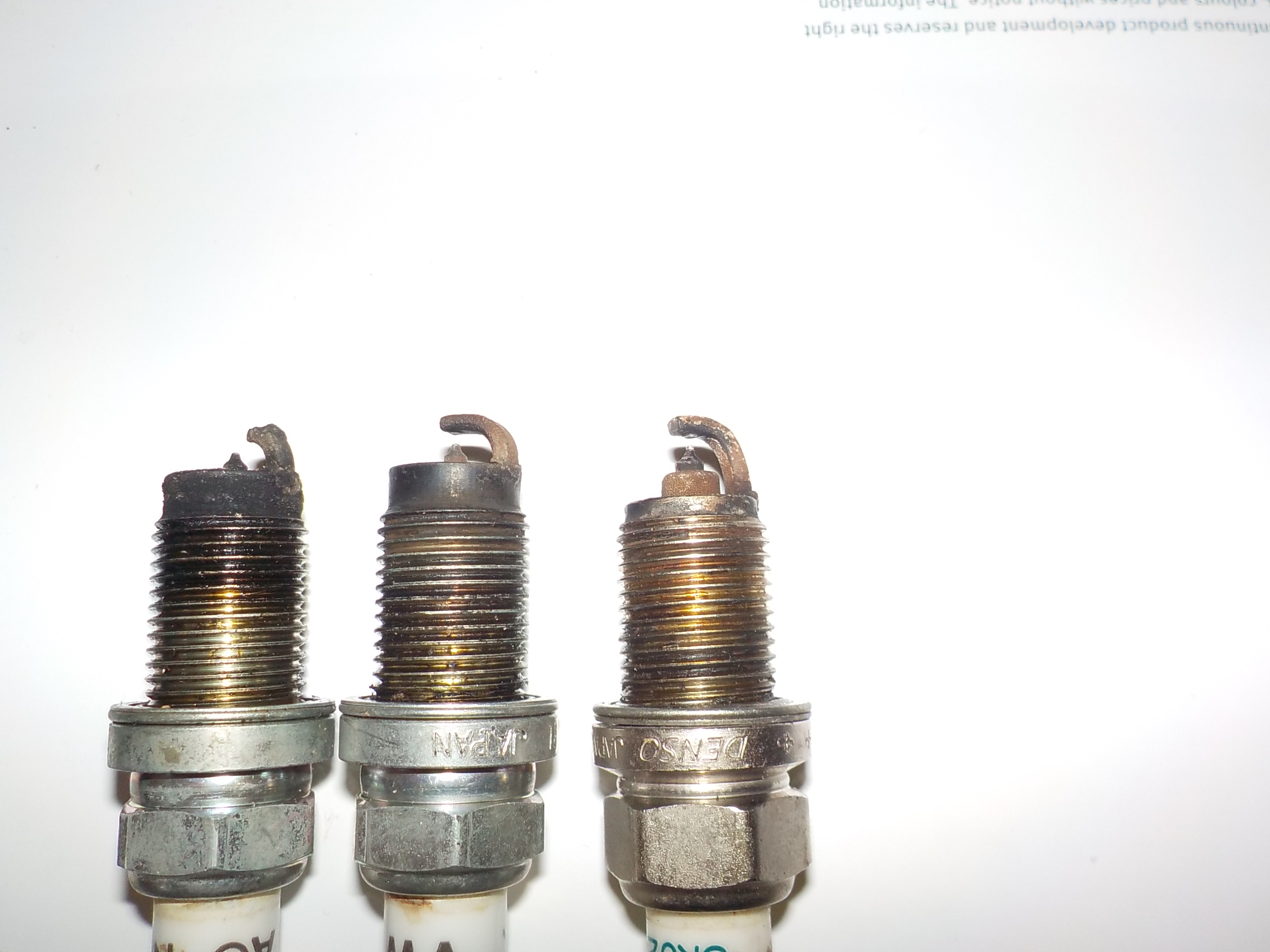

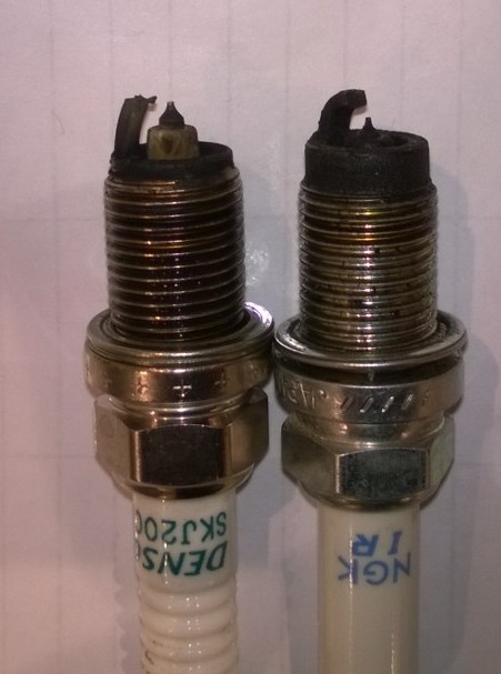

Is the second picture of Genuine, NGK & Denso?
OEM VW 2nd issue plugs on the left after 25,000 miles,
 the Denso from the same cylinder the VW/Audi burnt out plug was in after 30,000 miles.
Edited by Awayoffski

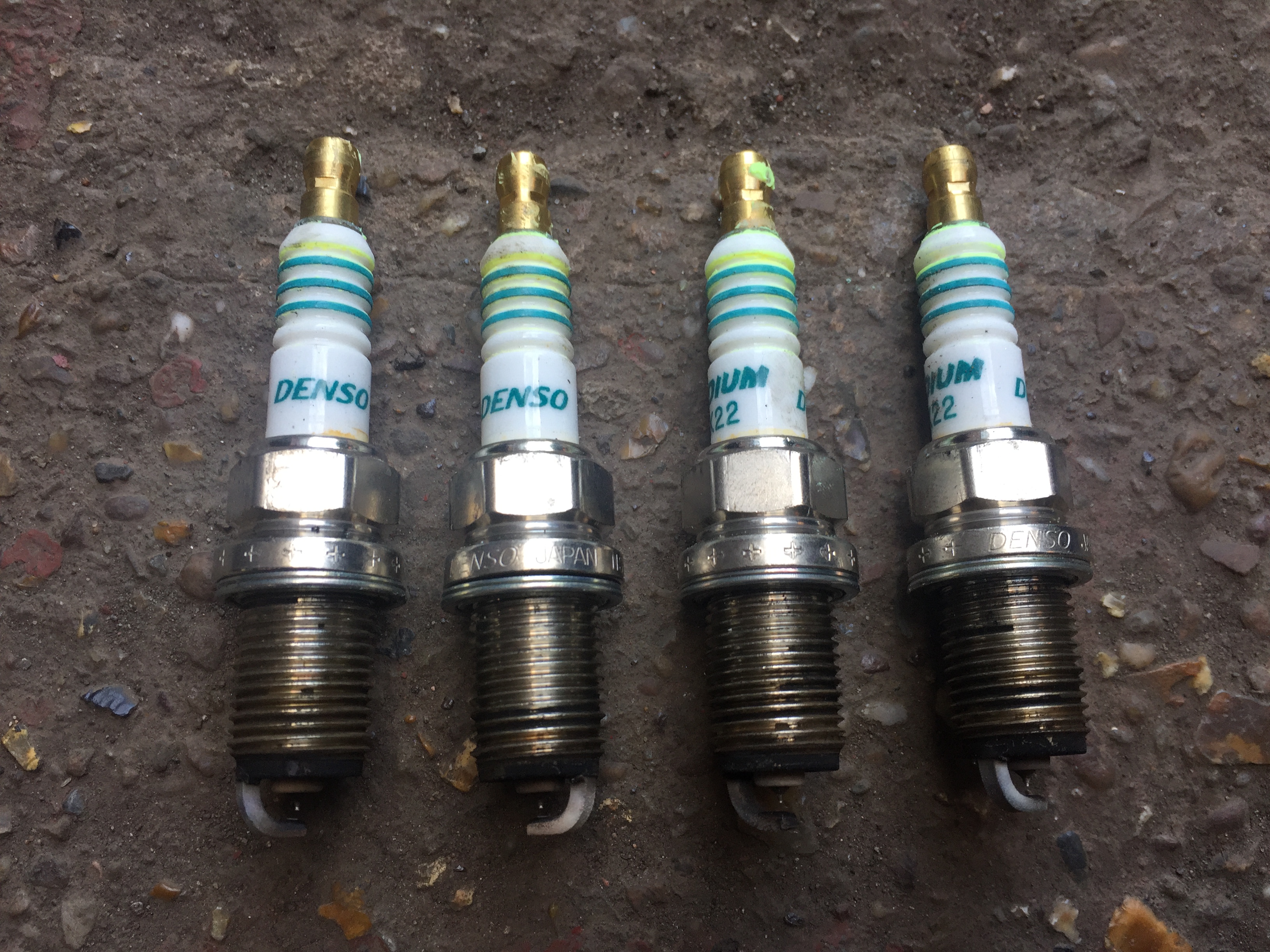

These are the Denso plugs i put in after oil fixes i think they are the same. Decided that i am changing them every service anyway now even though only 5k a year in mileage.

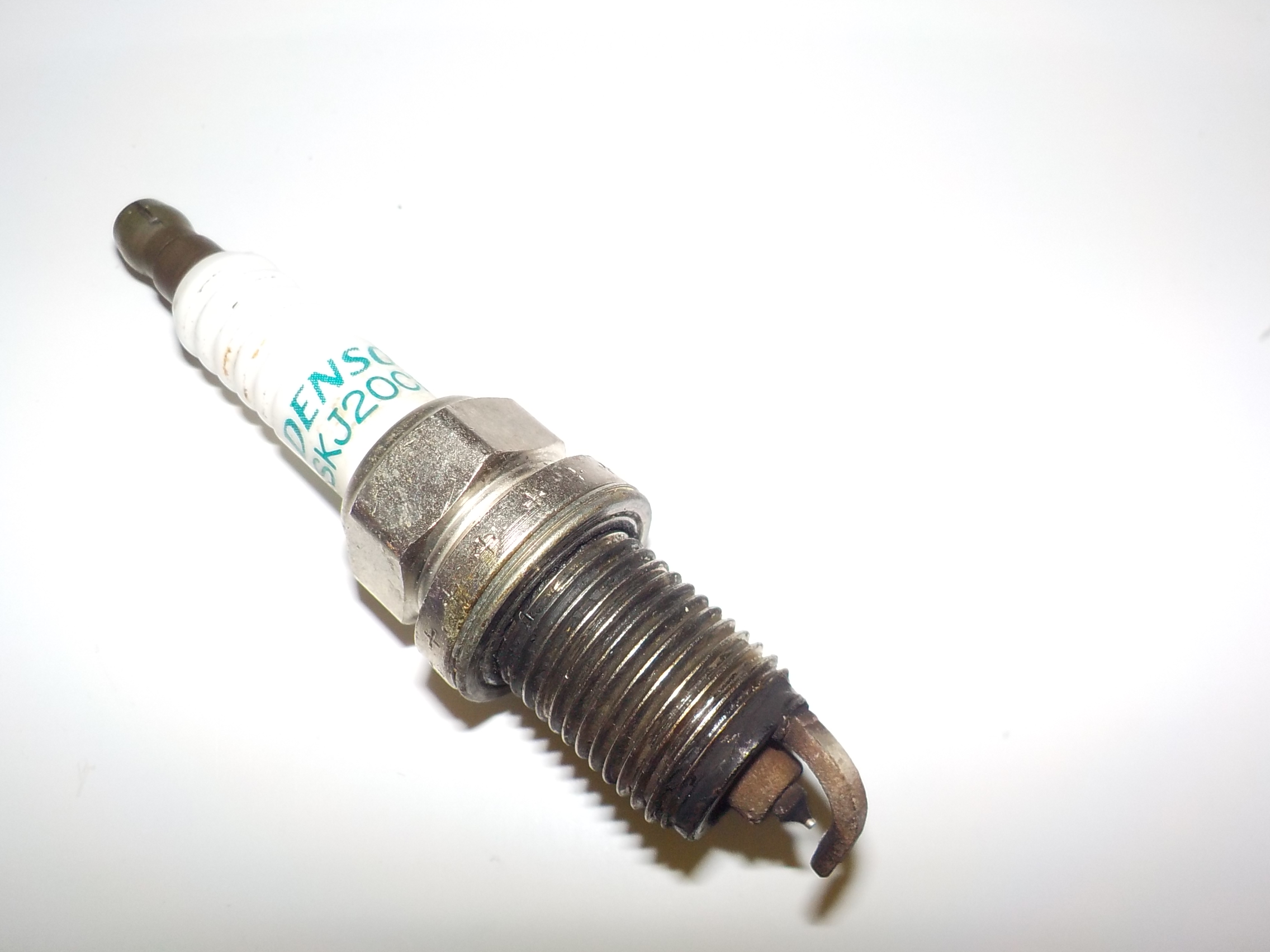

Tuning shop has confirmed my 'boost problem' was a spark plug problem, The iridium tip has broken off on cylinder 3 again. Said no damage to engine, or at least it sounds ok....
The tech guy@ tuning shop said he does not reccomend iridiums and he did warn me of this before i put them in when he mapped it. Said he prefers Platinums
For now he has put some bosch in.
Will upload picture later when i pick up. Anyone know any good links for platinums? Not impressed with the Denso's & i if myself and 'S27 VEJ' has seen improvements taking the Denso's out then they cant be that good.
These DENSO are IRIDIUM / Platinum .   They have run well at Stage 1 & Stage 2 and i have never heard of a premature failure before.
Are these what you had fitted, and how long ago and how many miles?
It will be good to see pics of the burnt out one.

Broken Denso on the Left has managed only 1200 miles (4months) since car was tuned. (Cause of my recent loss of Power) - no EML Dash lights though
Broken NGK on the right lasted around 4000 Miles (9 months) - but this one came from an untuned oil burner.
Tuning shop has advised against Iridiums as has blown many of them on the ramp on Audi, VW Subaru's and advised to go Platinum.
So the hunt is on for some Platinums that are the right size.
If a platinum breaks a tip (which is also unheard of) then said it could be injector issue.... as the problem plug came from cylinder 3 (AGAIN)
Edited by Kobayashi

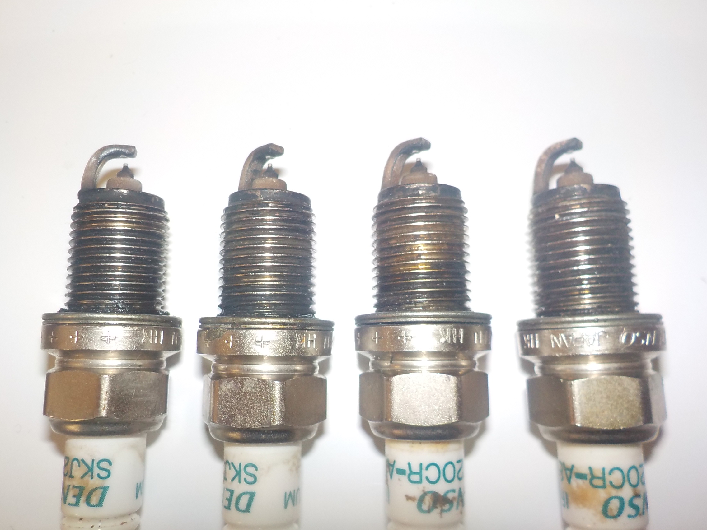

These are out of a Stage 2 CAVE after over 15,000 miles.
17 minutes ago, Awayoffski said:
Not good.
How many miles has your engine done?

47 minutes ago, Awayoffski said:
Not good.
on your pic the 4th tip looks the best compared to the others.
