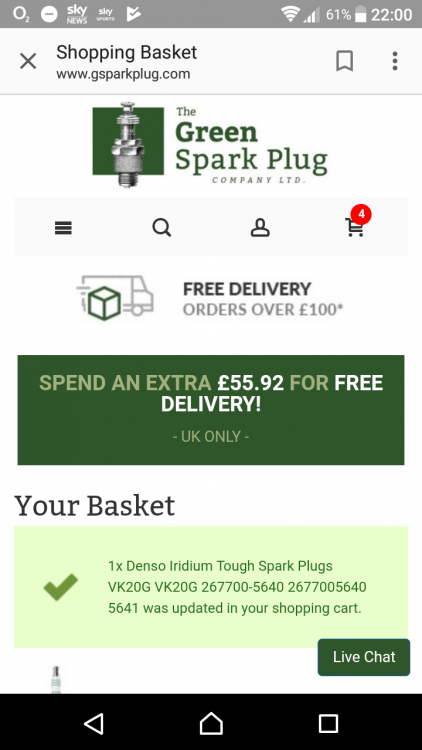

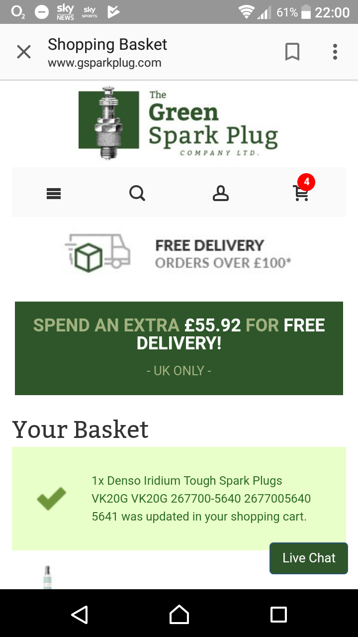

Anyone used green spark plug company. Gsparkplug.com.... looking at four denso iridium tough. Coming in just under £40 quid. Too good to be true ?
That is the price sometimes for the DENSO VK20. Euro Car Parts or where ever.  Seemingly they are OK, no idea about that seller.
Maybe just go for SKJ 20CR plugs instead.

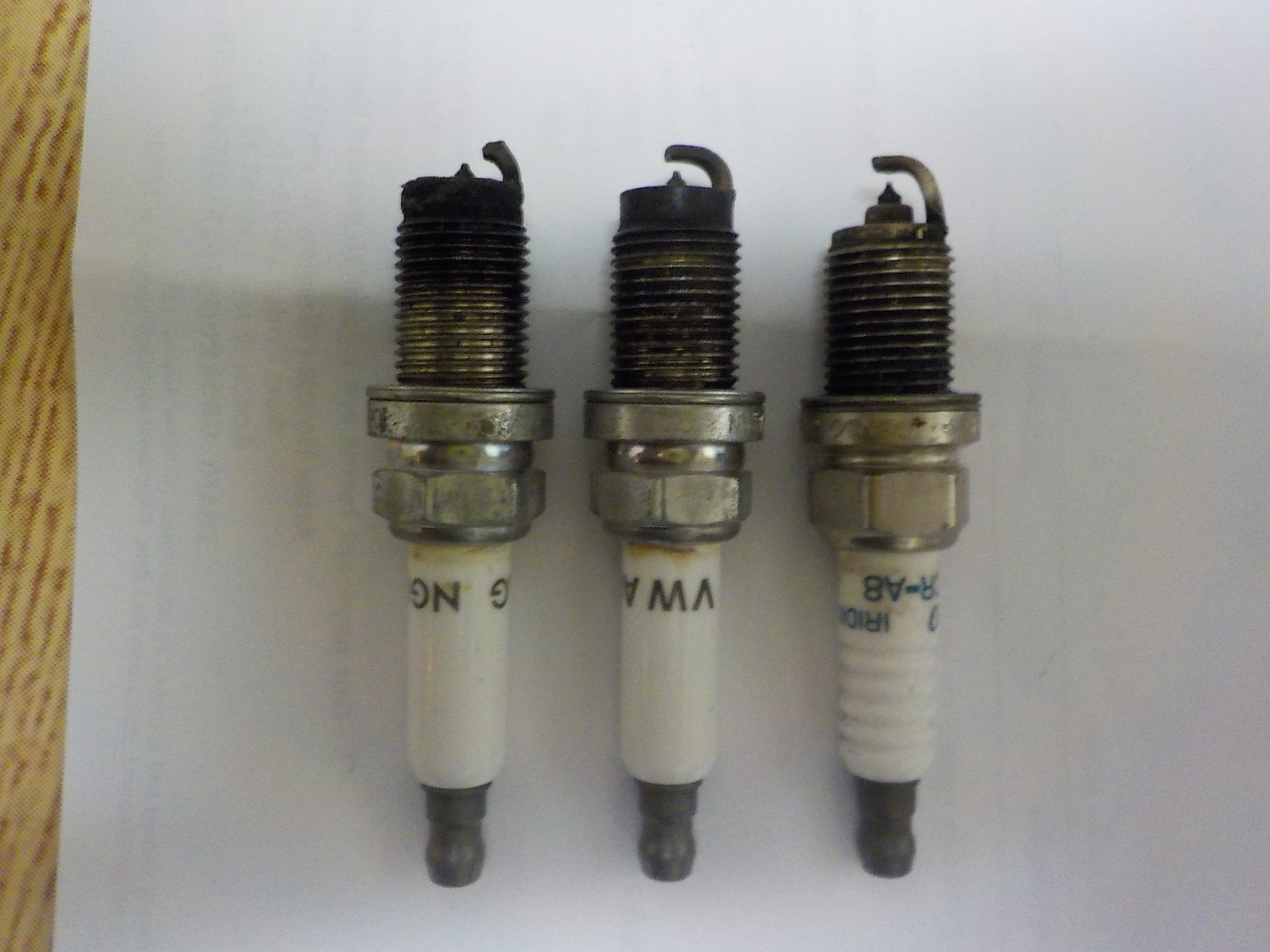

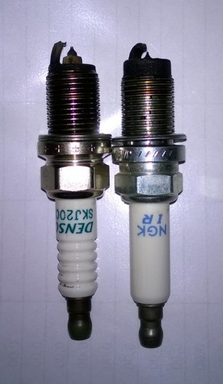

Here is the difference in reach and the tip of the DENSO SKJ plug & the Original plugs fitted to the early Twinchargers with VW / Audi on them,
they were PZFR6R if you bought as NGK,s 03c905601A
before Skoda started using 09c905601B which are the SIZFR6B8EG
Left original as one was burning out and could wreck an engine, and did with a few.
Below, the DENSO SKJ that Kobayashi had burn off the tip.
Edited by AwaoffSki
^^yes the right one NGK was unmapped oil burner, left was Denso mapped car no oil problem.
There could always be batch issues between different years of exact spec components (spark plugs) even though technically they look the same.
