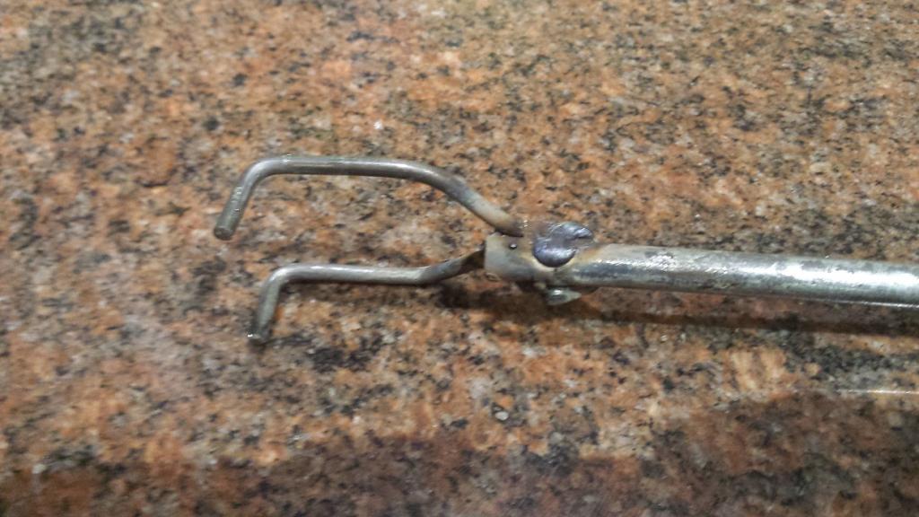

Not my home made job, pic taken from another thread.
