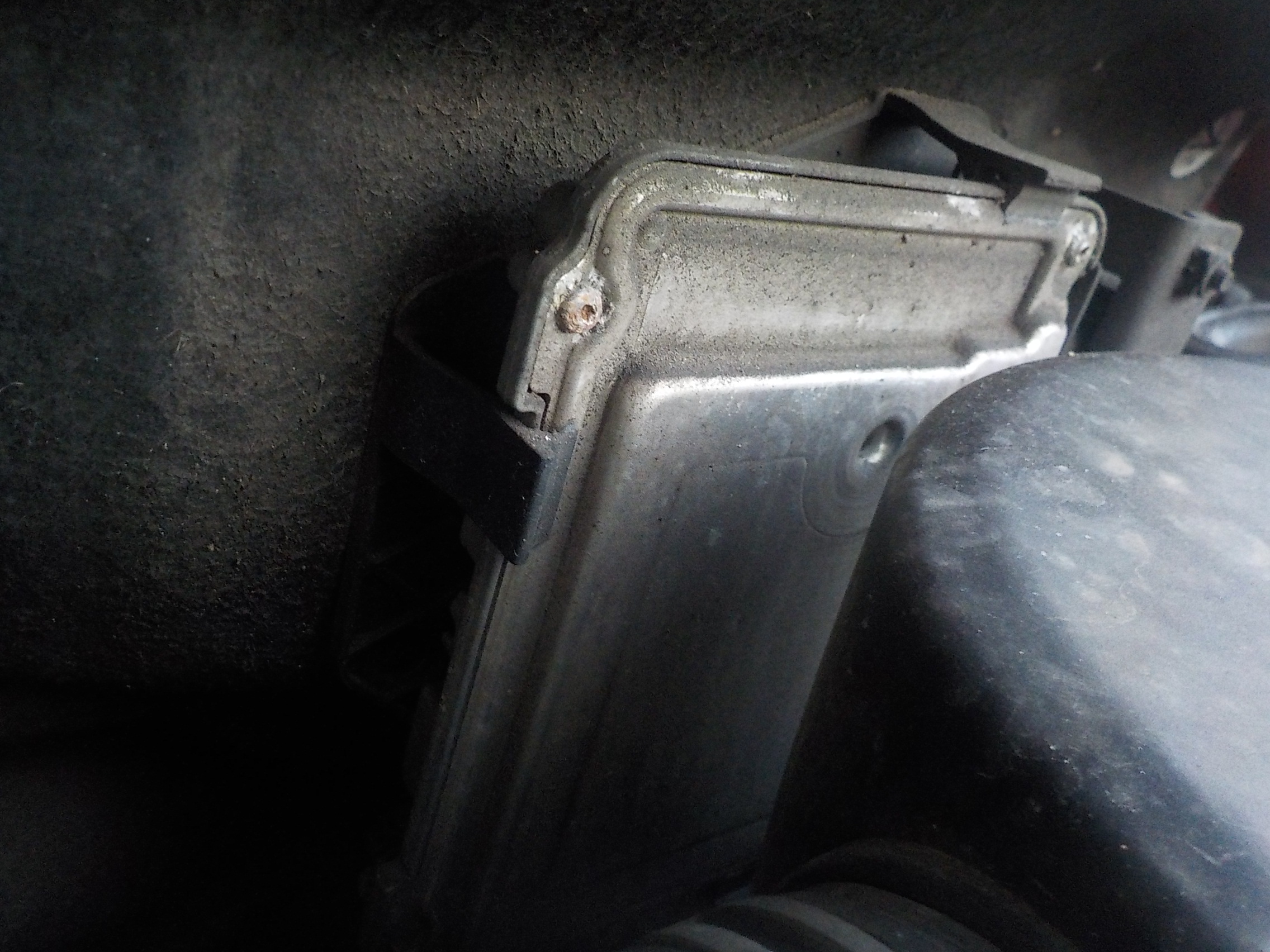

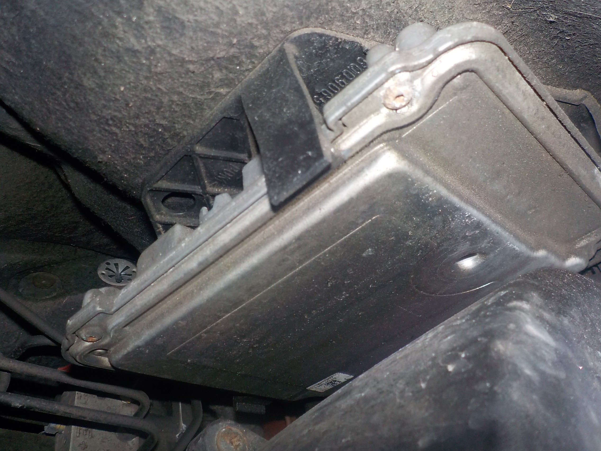

What did the Fabia vRS get as Revised Ignition Coils in mid 2010 and who told you this?
If it is different Ignition Coils from the SEAT Cupra Twincharger from 2009 then all Skoda Fabia vRS in the UK would have them from the cars arriving in the UK.
The First Fabia Mk2 vRS were only on sale from June 2010 and Brian69, NathsVRS & Me owned the first ones sold or that were media cars.
Different ECU's on our cars if you look, and Brian & myself had ones we drove with Original Engines and parts fitted.
(I have one outside now that is bog standard if you want to see what a Mid 2010 vRS engine and coils looks like,
pretty similar to a later CAVE but there were a few changes before 2012 and the CTHE being launched.)
