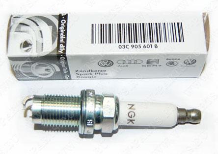

Choice, first plugs as fitted by Skoda until 2012, they were with a 0.8mm gap   'A'
then they were the 2 nd ones Skoda fitted and the gap reduced to 0.7 mm  'B'
Or the 2 types of DENSO VK20 or SKJ,  (SKP as well forget that.)
or the Bosch plugs or what ever else cross checks for a 1.4 TSI / TFSI 132-136 kw CAV / CTHE
Dead simple. well it should be.
These are what Skoda Main Dealers stopped fitting after they had a TPI to stop using them. PZFR6R,
(some just kept on and might still do.)
The 2nd ones are what they were told in the TPI to stock and fit to CAVE & then CTHE when the engines changed late 2012.
Those at the bottom are the same as those in the middle, just in VW packaging.

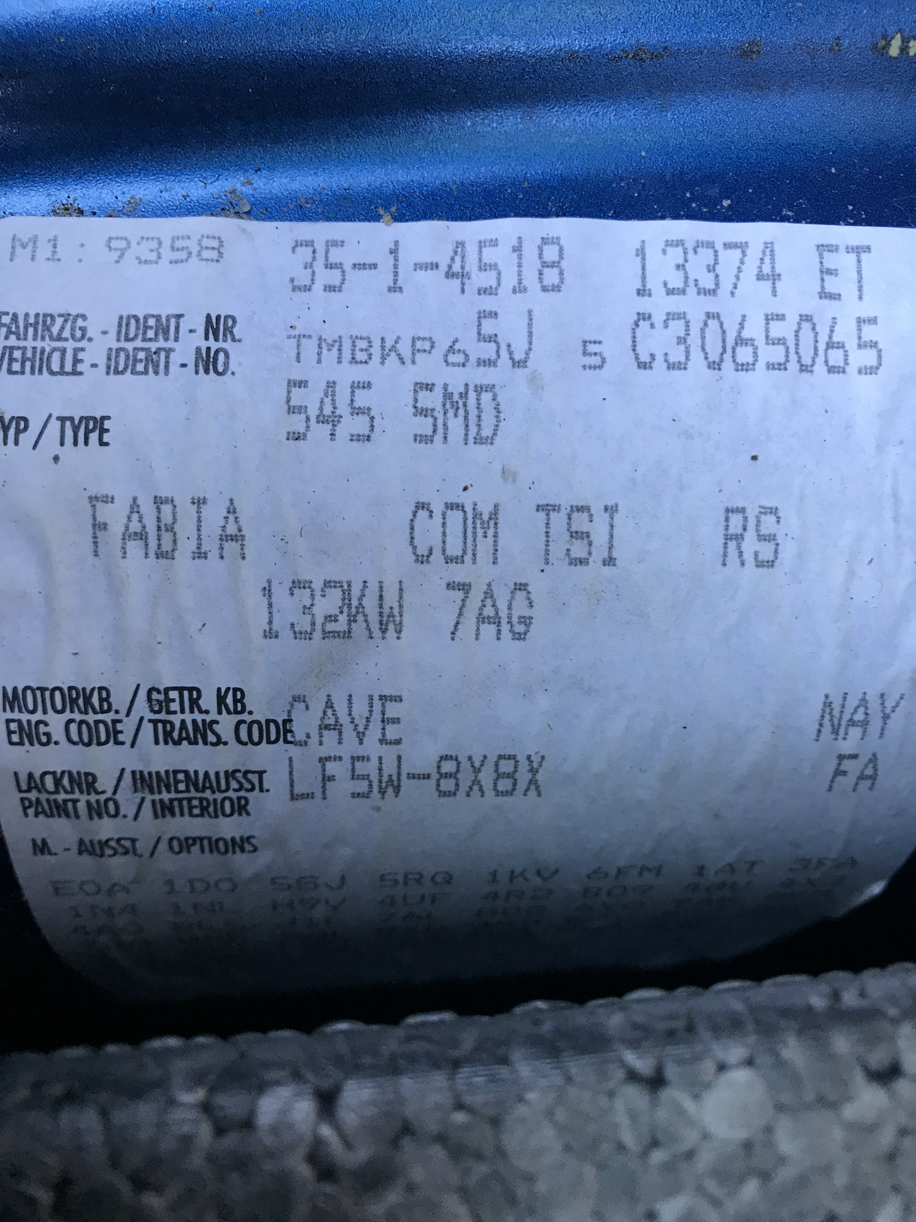

There is a sticker at the bottom of the drivers door pillar as well with CAVE or CTHE.
Does not matter, what ever engine is fitted it is still a CAVE as far as the DVLA are concerned,
If you can be bothered post a picture of your ECU because i am nosy but it ios not important.  People often say their CAVE got a CTHE as a replacement.

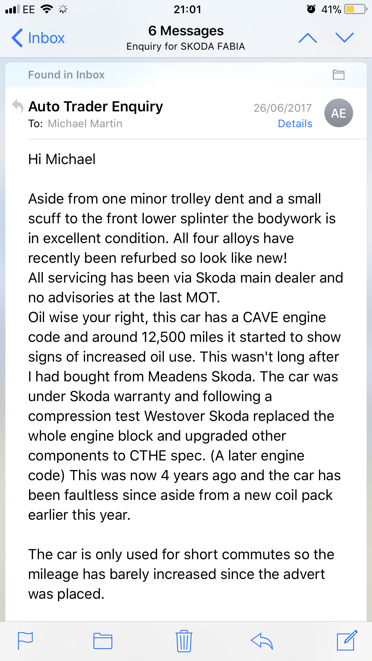

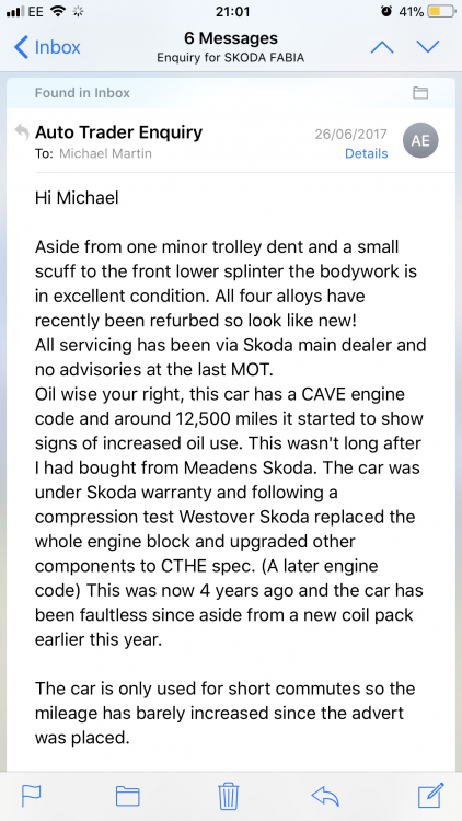

Here’s  the email from the previous owner before I bought it, Best thing I can do is call westover skoda?
have the relevant paper work for the coil pack getting changed but nothing about an engine replacement.
Edited by Mickmartin
Black sticker bottom down near the sill, it has the car weights on it, and should be there. Not something usually removed.
& there you go then you got a new base engine apparently, no idea what other components they upgraded, unless they are making out it is oil squirters.
Should all be on the Skoda System if a Skoda Dealership did the job.

It wouldnt surprise me if people have been told they were getting new CTHE engines & just had the latest fixes done at that time (cost saving) -
Which would have been the oil jets off the CAVD engine VW Scirocco)
Also would  a CAVE have a reprogrammed ECU for a new CTHE engine?
Edited by Kobayashi
Yes a reprogrammed ECU, or a new ECU to go with the CTHE when one was fitted.
Reason being there are 3 different ECU's for the first 2 years of Production, Locked and easy to open and remap, locked and difficult to remap, and then Locked not able to remap, then there are the one that came after that.
There were members that did get a CTHE engine fitted, in a CAVE or a CTHE, and even one that had a new CTHE and then needed Breather Mods and Oil Spray jets fitted, another one i know quite well who had an extreme oil using CAVE and a new CTHE was fitted (Base CTHE Engine with head from the factiory) and 3 weeks later it would still not run until a new CTHE ECU arrived,
then it was perfect, and got remapped before other CTHE's could be remapped.
There is a thread someplace with pictures Dandanfings CTHE with his cars ECU on the desk opened with a APR dealer trying to remap it and failing.

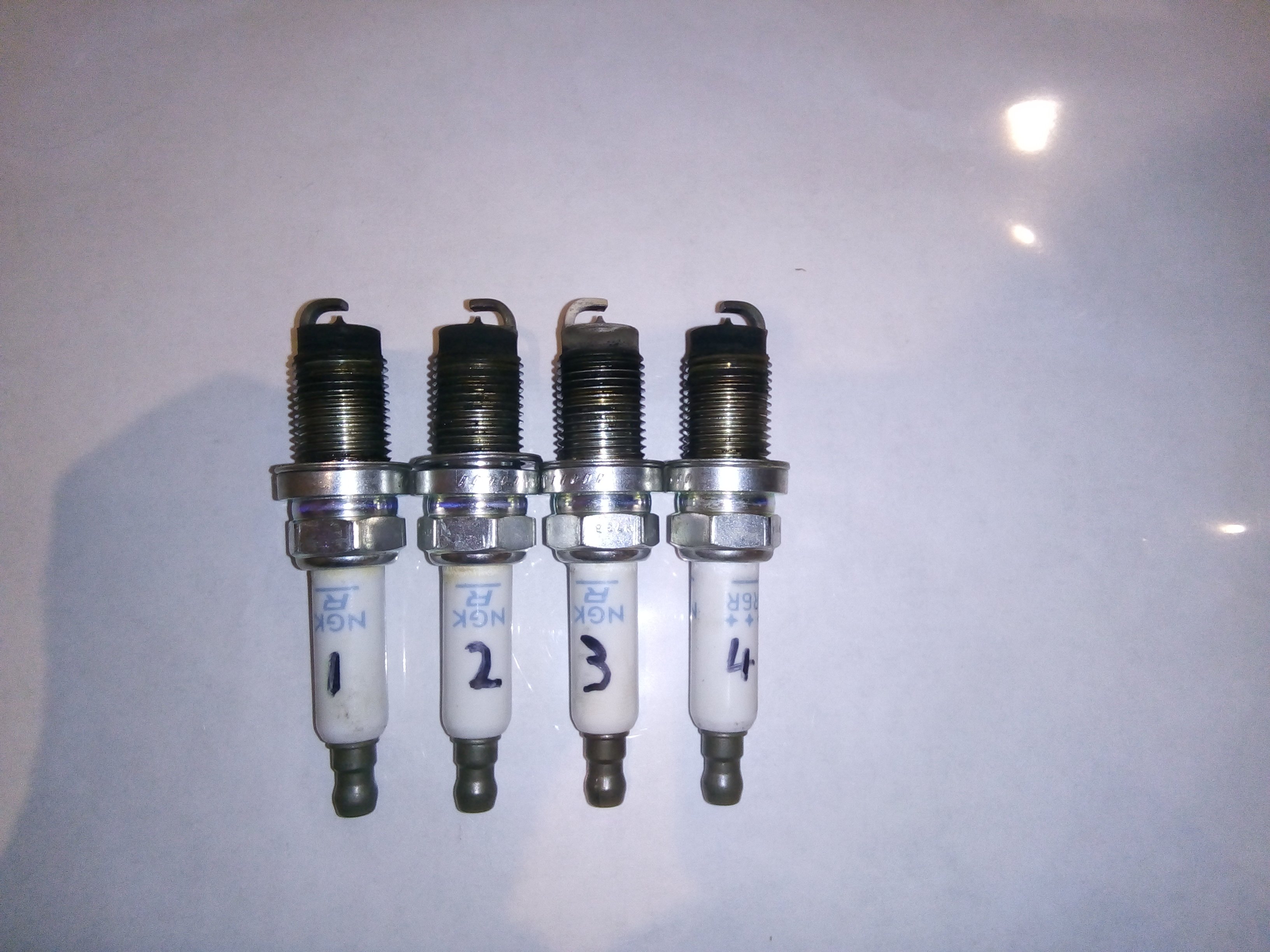

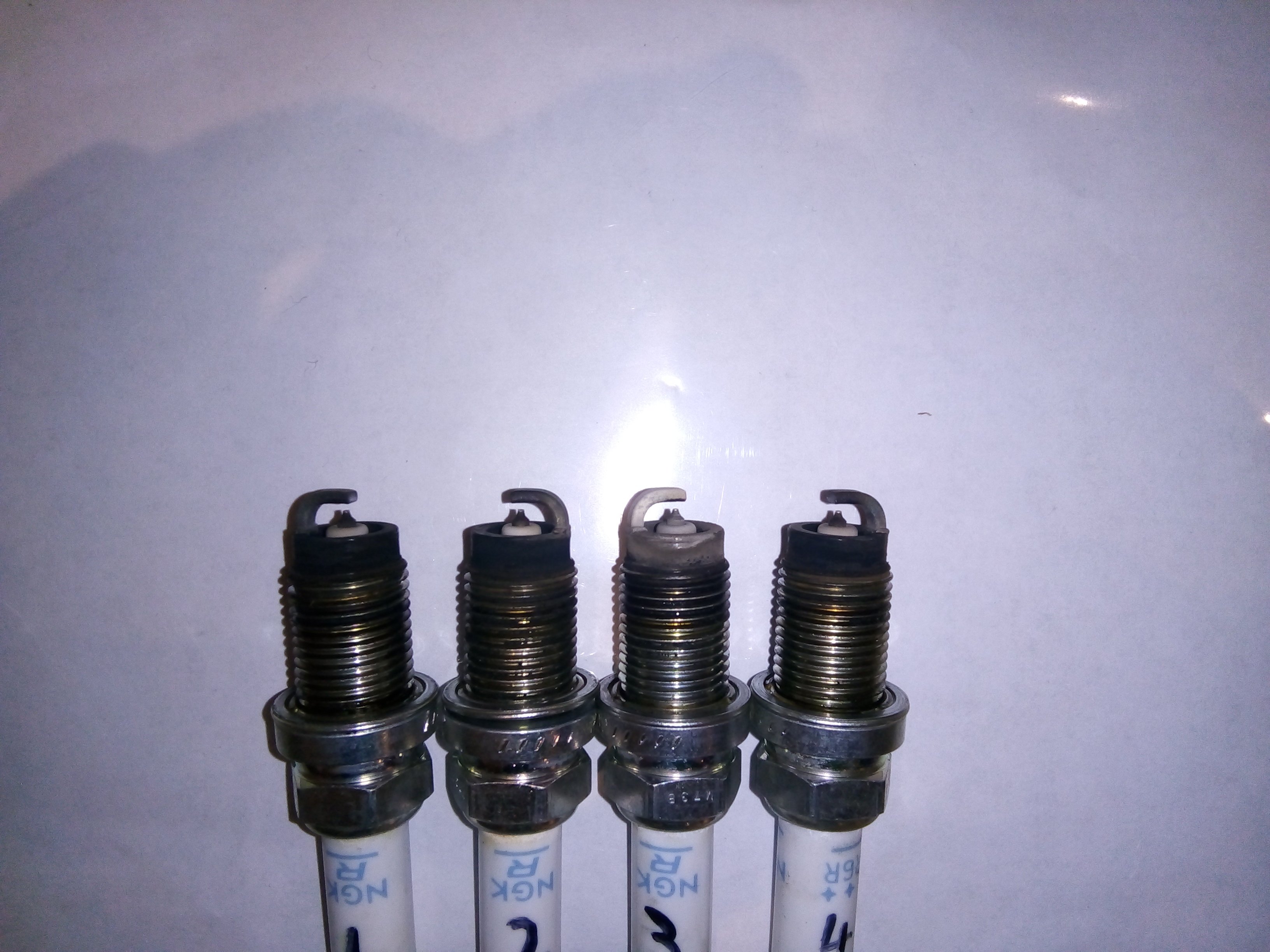

Another service so another year of Platinum NGK's, only 5000 miles done, so replaced like for like, still more heat going through Cylinder 3, though not worried.
So the final summary :
2015 NGK Iridium (Car burning oil Plug failed in cylinder 3)
2016 Oil Fixes + Car Mapped - Denso Iridium Failed after 3 months - replaced with Bosch FR6HI332 (these were ok)
2017 Bosch FR6HI332 replaced with Platinum NGK's - Bosch noted to be OK.
2018 Platinum NGK's from 2017 (Cylinder 3 more heat on tip but ok)
2018 Swapped out for another set of Platinum NGK's at service.No.3.thumb.jpg.bfa26c7f742572aa2f01687341cff749.jpg
Really worth going for a try again of DENSO next time, bought from a trusted source so that you know they are the real McCoy.
They should be good for 15,000 miles or even more. That is all 4 of them.
