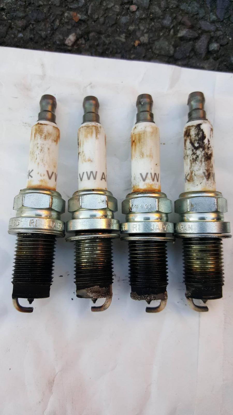

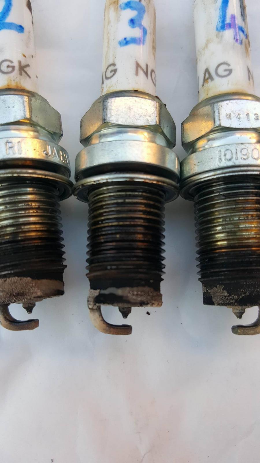

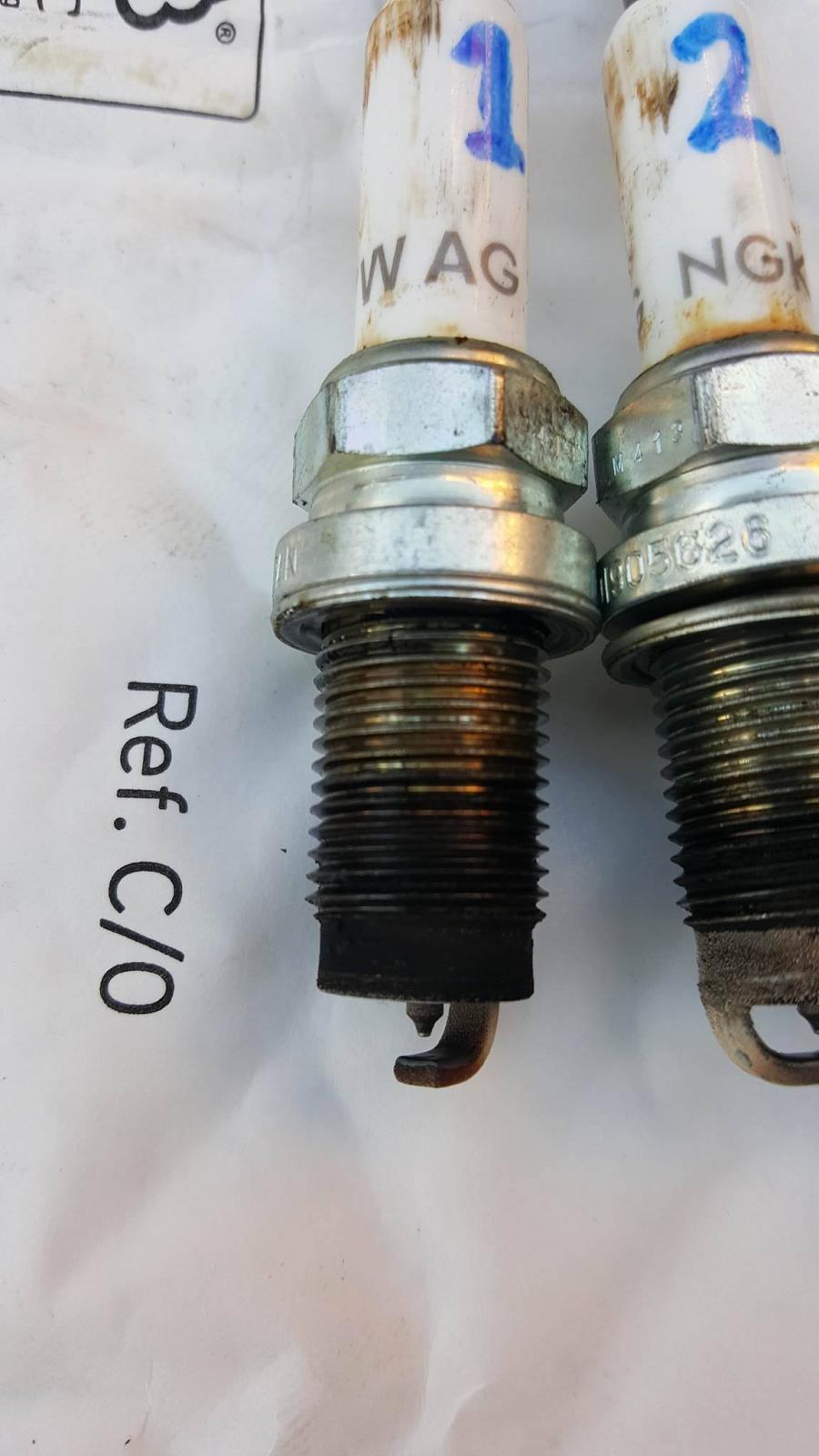

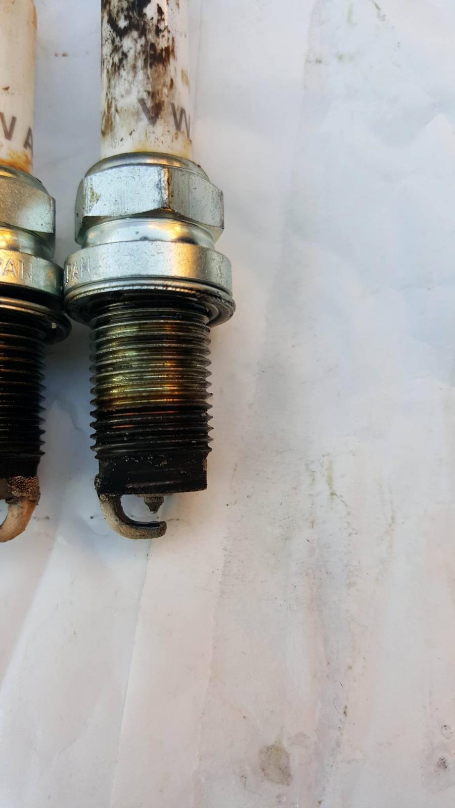

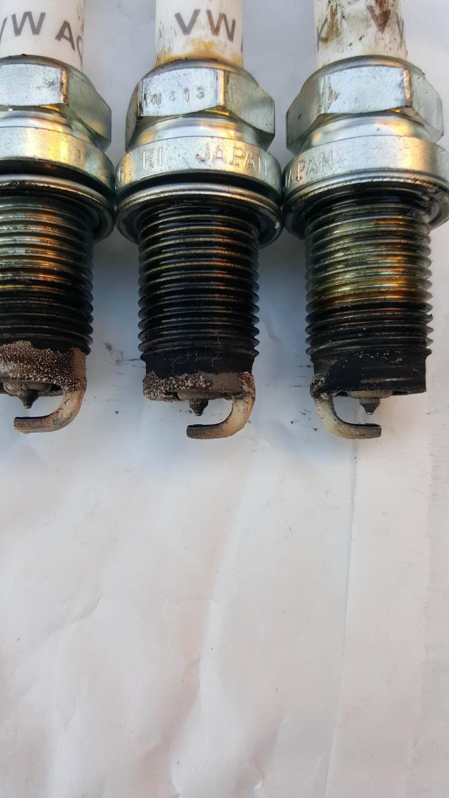

Right, Finally got round to fitting my new plugs today! Easy job.. 45 mins max and i was taking my time. I didn't have coil pack pullers so a pair of grips and gentle careful persuasion done the job. I did buy THIS  and i reckon it saved a lot of swearing and dropped plugs!
The reason for me changing my plugs was because i had a misfire on cyl 4, i swapped the coil packs around and everything was fine for a few days then i was greeted with the EPC light and CEL leading to limp mode after a bad misfire. original thread is here
She seems to be running much better now and no misfire so far so fingers crossed she's fixed! MPG does not seem to be improved but that might be because of my driving to test for misfires.
Car is a 2011 CAVE always run on either Shell or Tesco 99 Ron, 46400 miles on her & doesn't really seem to have taken a taste for oil.. fingers crossed. topped up about 1ltr in 3k miles.
Full SSH and no record of the plugs ever being changed.

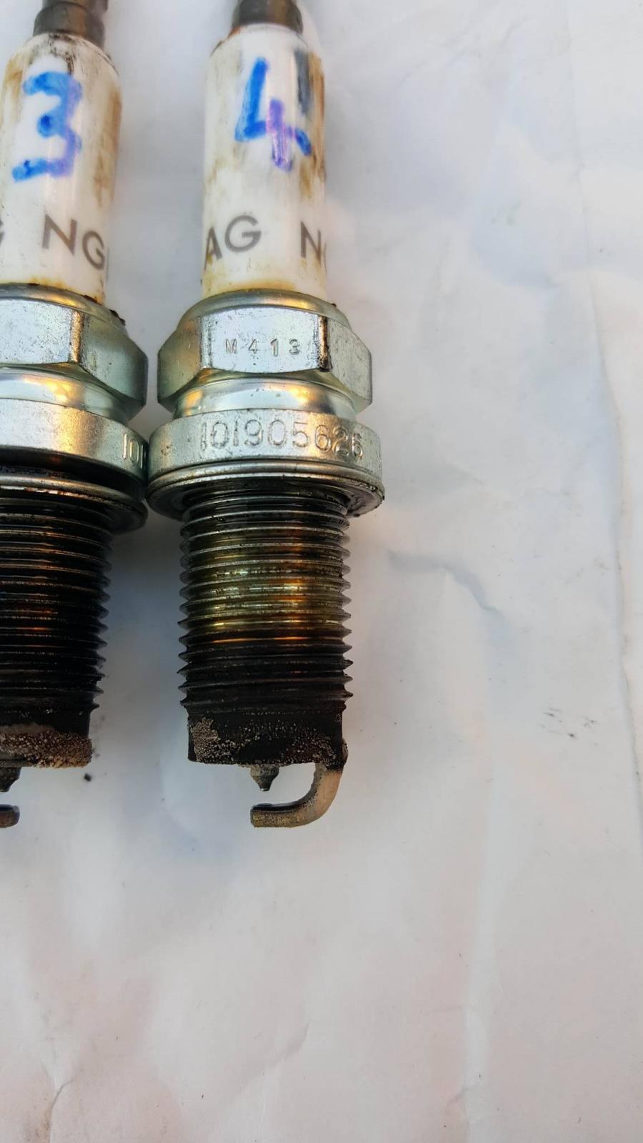

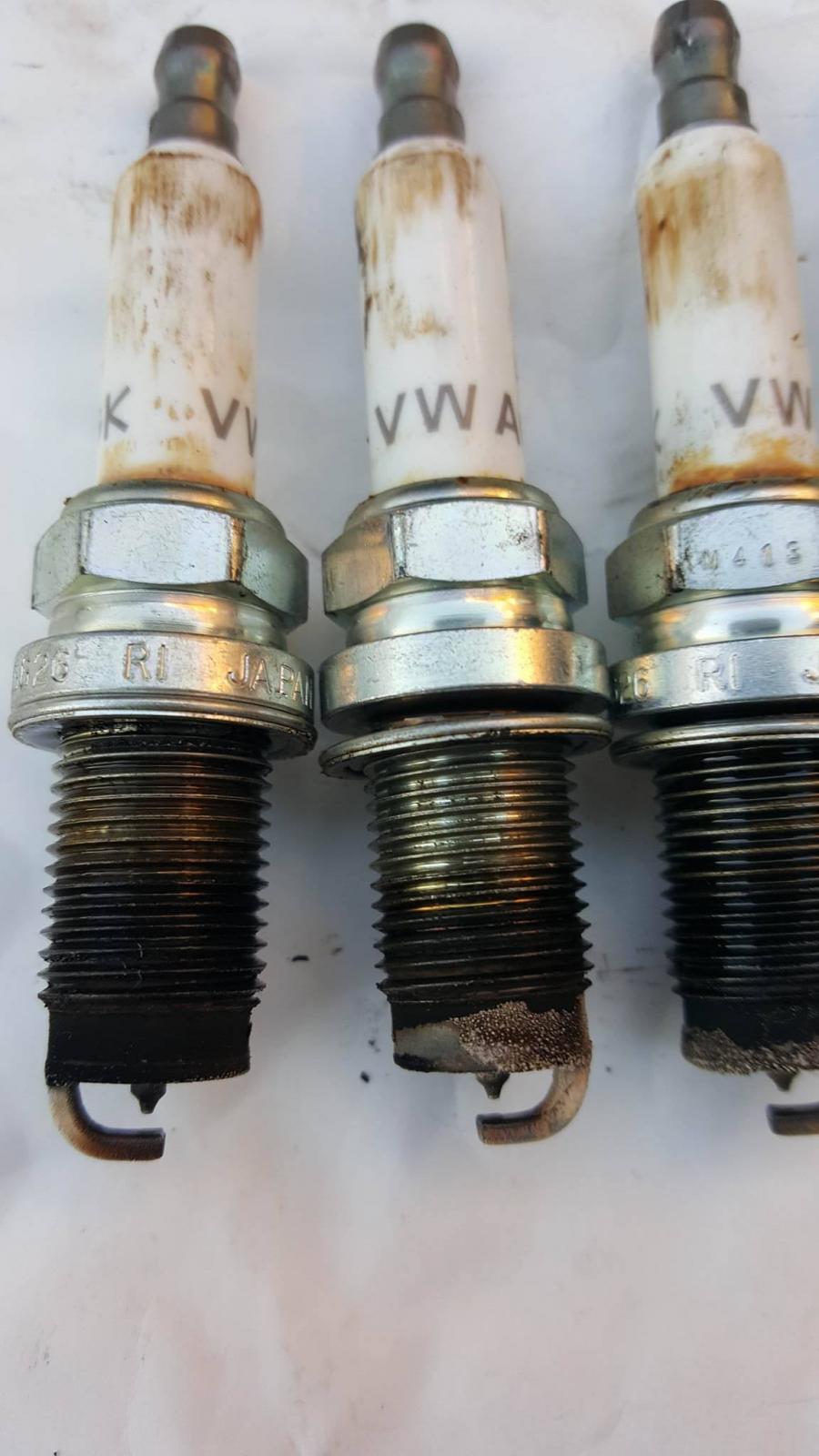

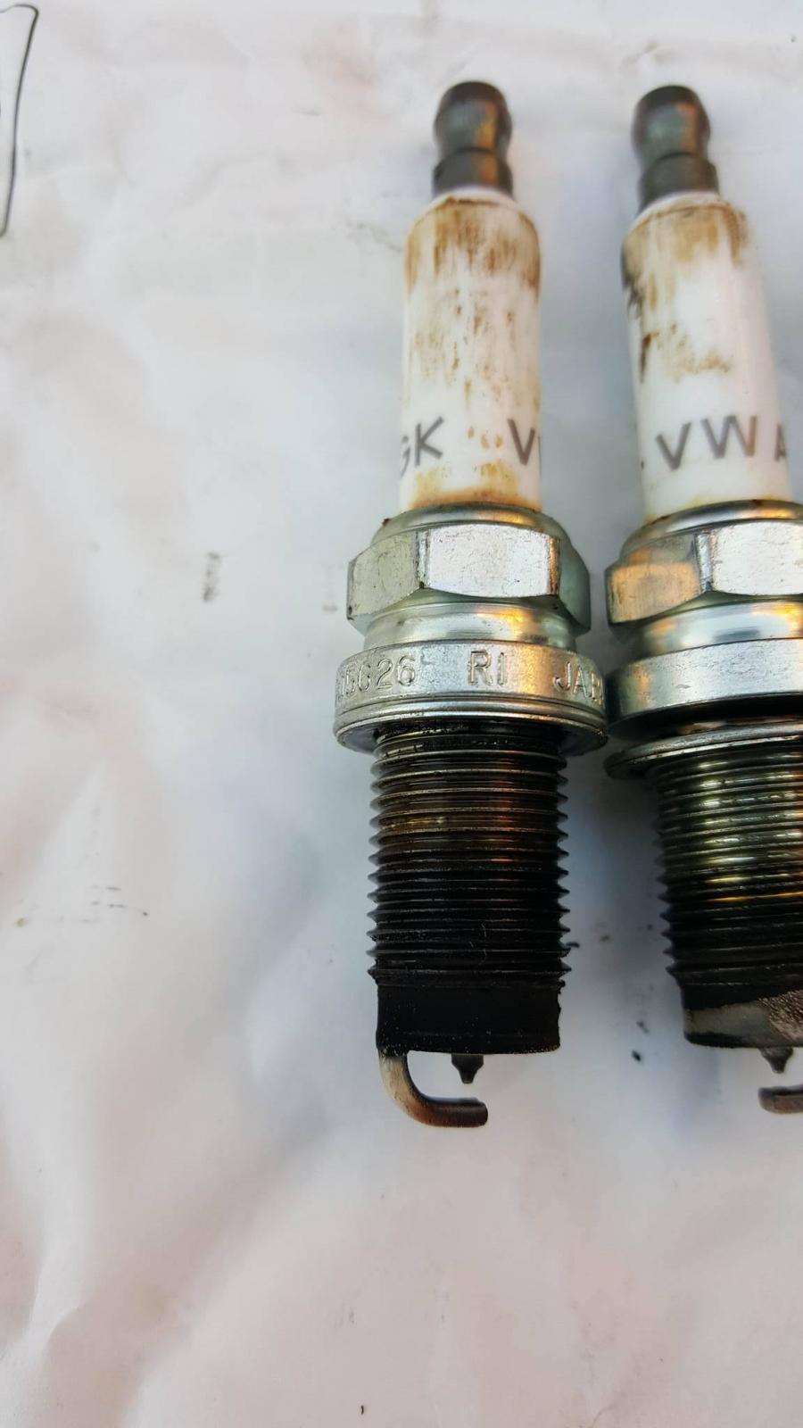

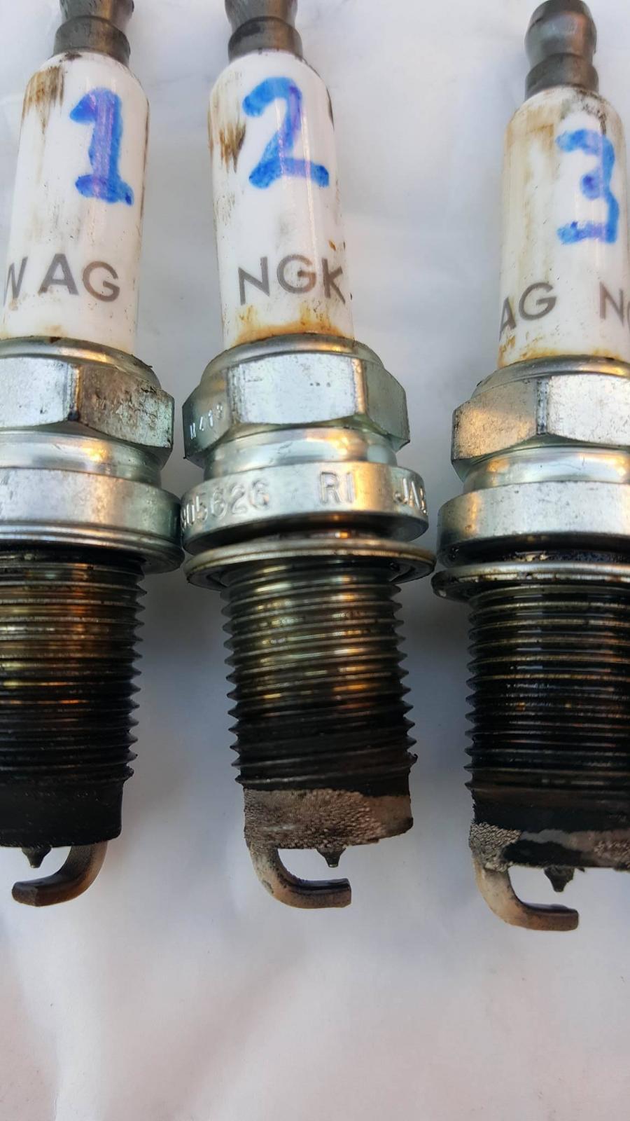

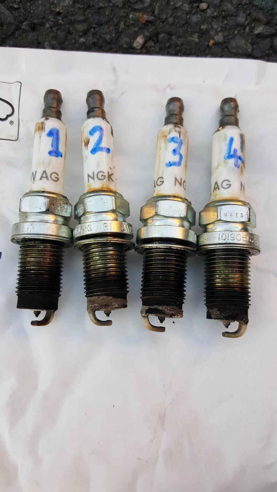

Here are the pics of my plugs after removal
post-148551-0-49096300-1482942408_thumb.jpgpost-148551-0-60870000-1482942404_thumb.jpgpost-148551-0-20793600-1482942405_thumb.jpgpost-148551-0-90295300-1482942407_thumb.jpgpost-148551-0-74520600-1482942409_thumb.jpgpost-148551-0-02039300-1482942404_thumb.jpgpost-148551-0-89946800-1482942406_thumb.jpgpost-148551-0-73805200-1482942405_thumb.jpgpost-148551-0-15418900-1482942409_thumb.jpgpost-148551-0-30437000-1482942406_thumb.jpg
Edited by DamoR
Use your feeler gauge and see what gap is on those plugs. They are obviously ones that have been changed and not the originals, not that bad condition.
But it would be interesting at least to me to know the gap.
Have you checked the 4 plugs gap were all the same before putting in,
what were they?
what were they?
Unfortunately a feeler gauge is another tool i seem to have mislaid so no gap checking was done.. i only had an hour to do the swap before having to go to work :( i did visually check them and they all looked the same.
I will try and get hold of gauges and check the old plugs.
Edited by DamoR
I fixed this by resetting my avg MPG reading.. forgot to do it before  :blush:
Edited by DamoR
