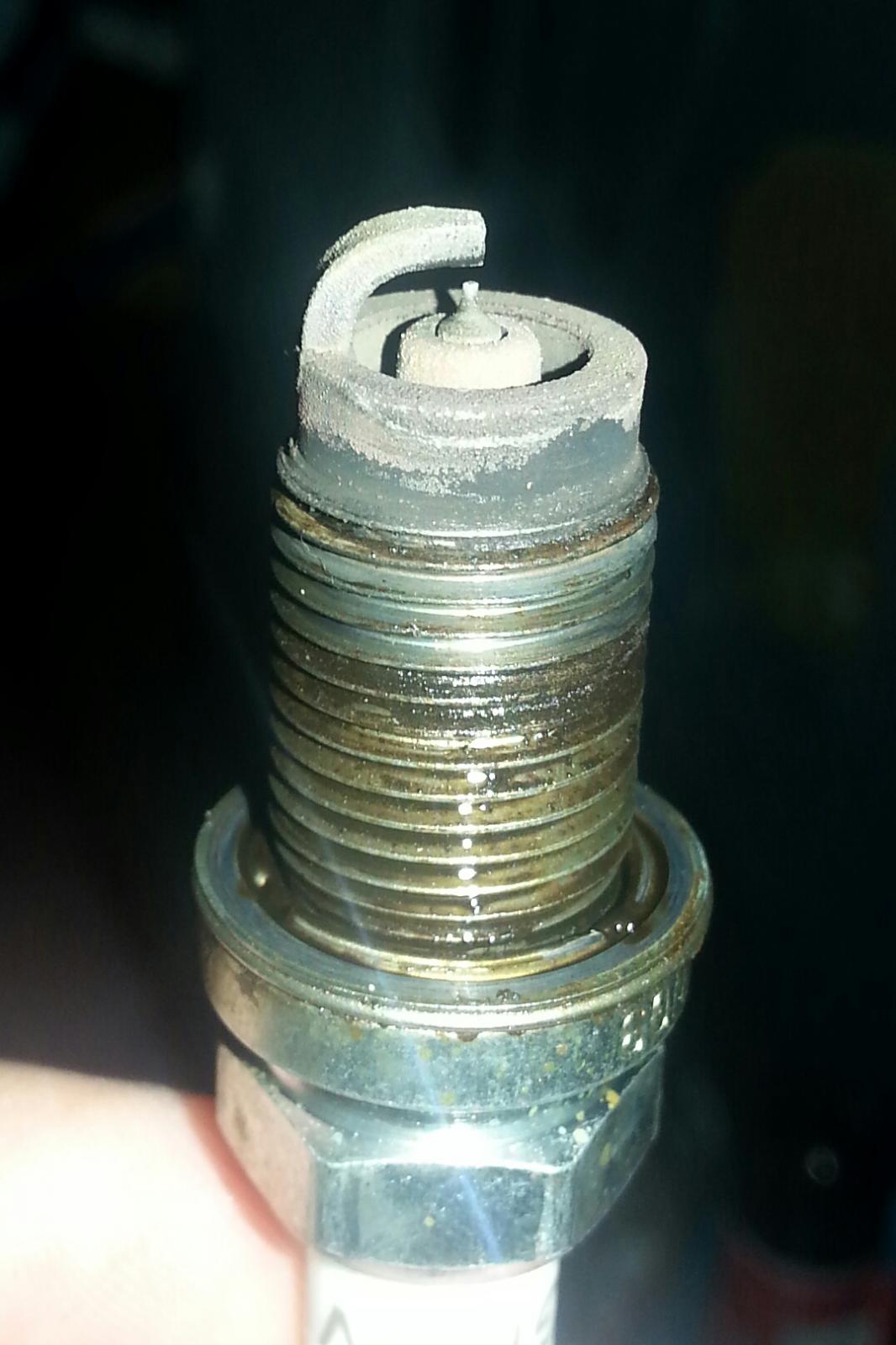

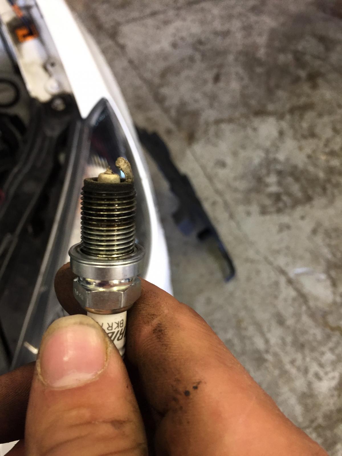

  • Here's mine today when I removed them for compression test, 11,000 km on them currently. I think they can comfortably go to 20K (km) ?

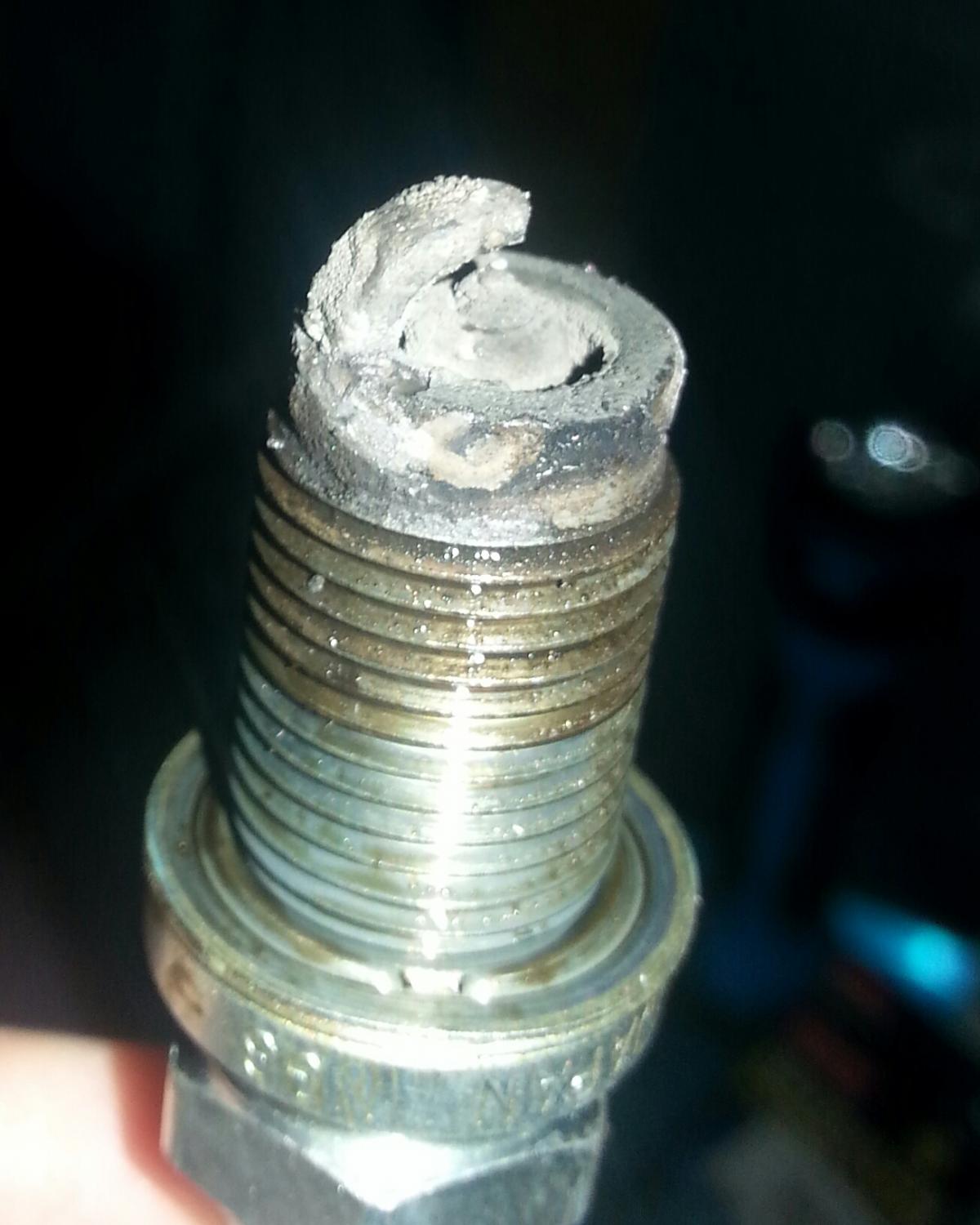

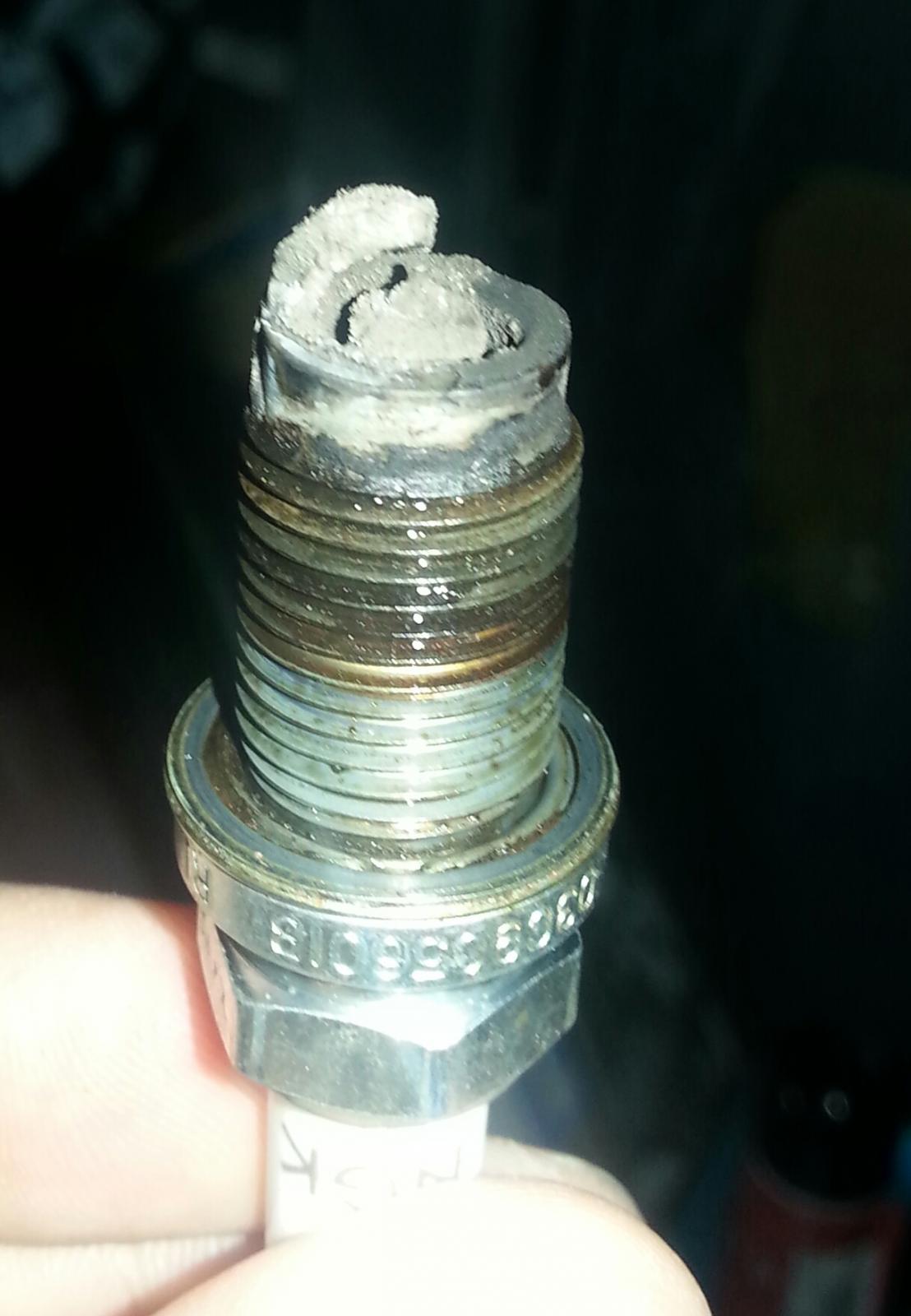

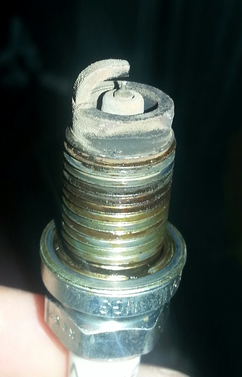

mine was fine at 60k then had it tuned by revo and put recommended plugs in and this is it after 1300 miles misfiring on cylinder 4 i have changed them again and swapped coils i think my engine is toast :( post-138124-0-11062800-1468025163_thumb.jpg
Hopefully your engine is fine as you caught that plug, or have you issues?
Are you getting that REVO Map off and an APR on or a Skoda Update.?
(There is a bargain Tuning box for sale in the For Sales that you could fit rather than the REVO Stage 1.)
Those Plugs as REVO Recommended were cr4p as is the REVO Map for a twincharger. JIMO.
http://revotechnik.com/support/technical/14tsi-twincharger-engine-issues
mine was fine at 60k then had it tuned by revo and put recommended plugs in and this is it after 1300 miles misfiring on cylinder 4 i have changed them again and swapped coils i think my engine is toast :( attachicon.gifIMG_1898.jpg
Sorry to hear this buddy, hopefully you've caught the issue in time to prevent the worst case scenario from happening. I've not been a member all that long on here compared to others but have been aware of the potential for problems with spark plugs even without a remap being done. Unfortunately it seems Revo in particular has had remapping problems with the 1.4tsi twincharger with many members on here reporting major problems after having their car done. No consolation to you at this time I'm afraid.

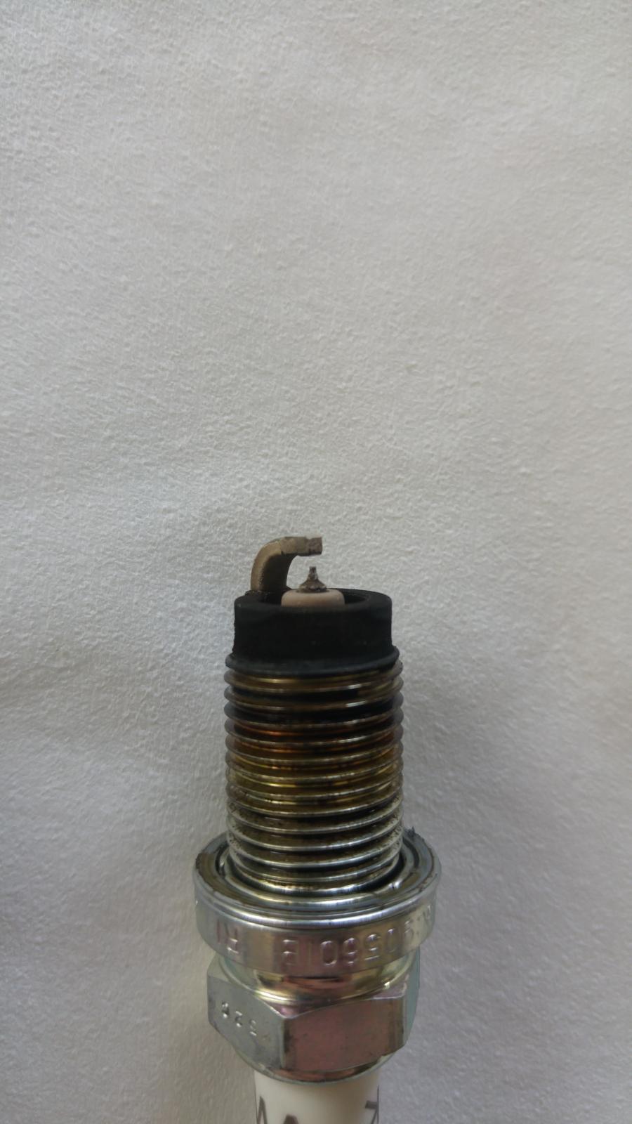

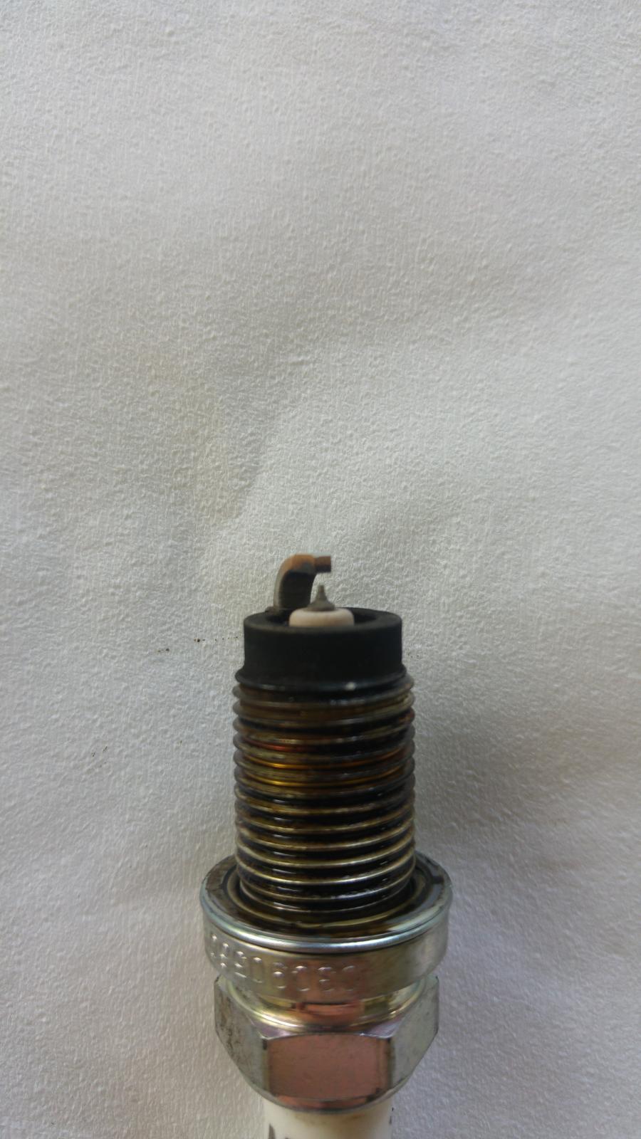

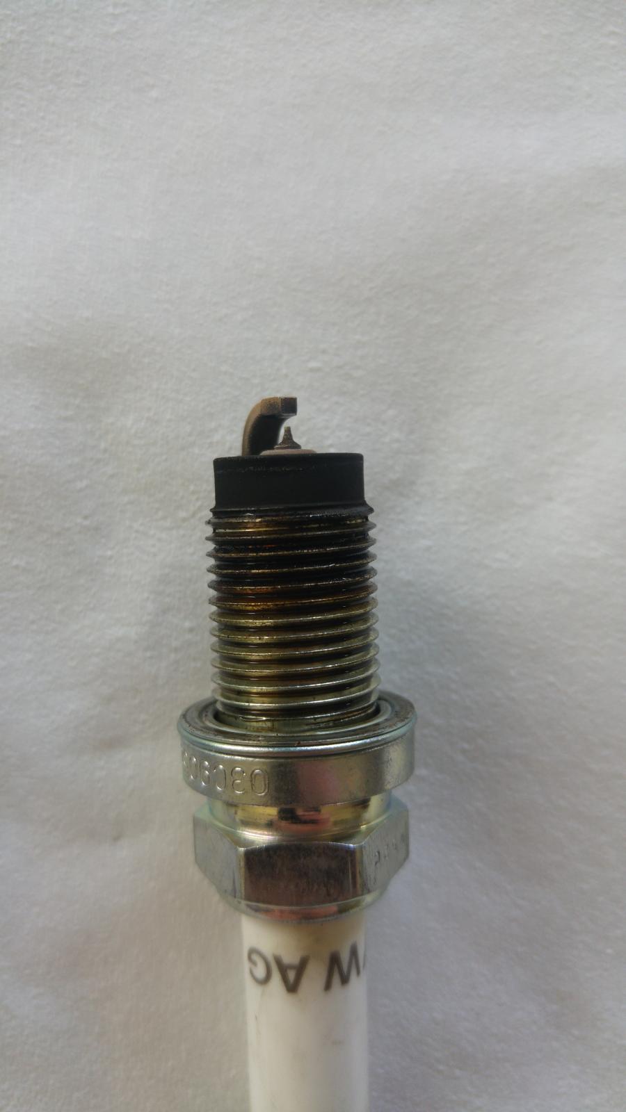

Sorry my usual bad photography.
These are DENSO SKJ plugs as removed after having done 35,000 miles in a Twincharger.
CAVE running APR stage 1 & using Tesco Momentum.
They are now starting to show wear and the gap is bigger than the 0.8mm they were put in at, but nothing drastic.
Worth every penny for the peace of mind rather than using NGK that VW / Skoda recommend.

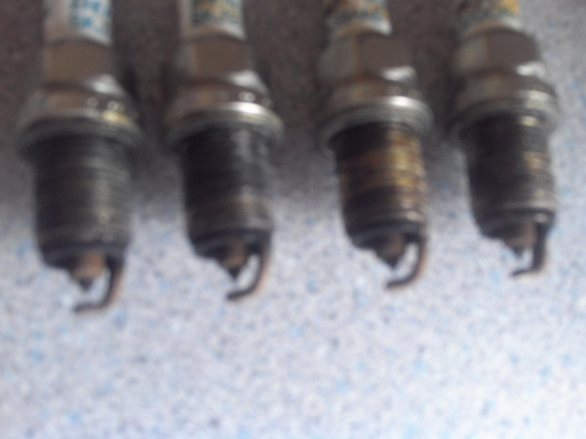

I too have had my sparkplugs changed (40 000 km), I put Denso SKJ in, the car feels much better ! Mainly pulling harder at part throttle.
I never had any missfire issue.
Here are the old plugs ... (the mechanic did not note the plugs order, but I can guess by their looks ...)

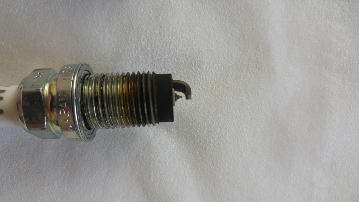

changed plugs today these nearly year old tesco momentum fuel not modified (yet) look pretty good by my eyes
How many miles is that in the year?
They should be looking good.  OEM Long Life plugs, the issue is that often they do not all last 40,000 miles
or sometimes even 20,000 miles.
Not many to be honest about 7000
