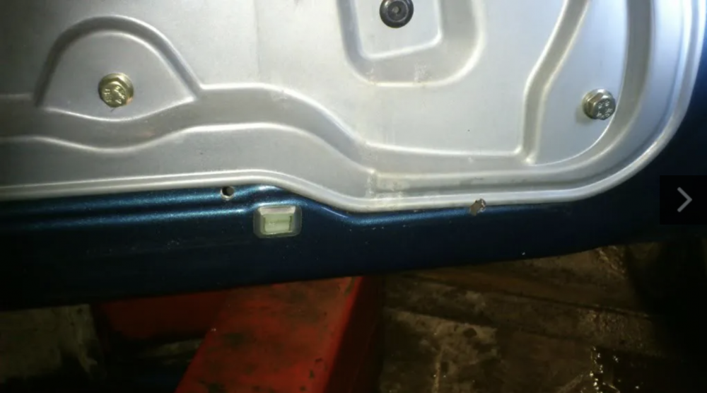

Hoping this fix will work for me and will be giving it a go next weekend. Can someone point out exactly where I should drill holes as I can' be sure where they are from the picture (rear doors).

As for the tape, search ebay for 'Class O ' tape.
It should be about a fiver a roll.
