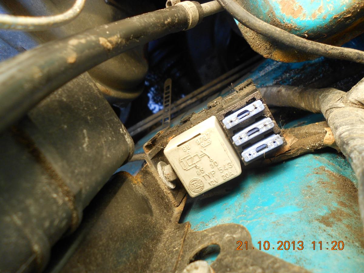

I'm convinced I need to replace the fuel pump relay but the type number and specs don't seem to match any available.
Fav 1994 136B 1.3 LXie
Relay type 543  12v,  20 amp,  5 pin
Can someone point me in the right direction
It looks that type of relay is out of production. I would take it out and compare it with a very easy to find 20A, 4-pin relay (having pin numbers 30, 85, 86, and 87). It is not the end of the world if it doesn't have the second 87 pin. Maybe it is not even used. But even if it is, it's quite easy to find a proper solution.
