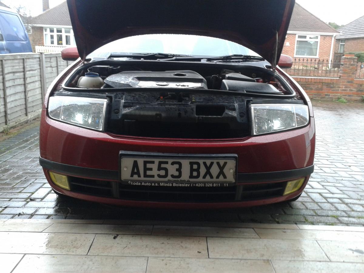

  • well, it's finally on. PITA this whole thing has been. Some paint flaked off in the process and there's some small amount of filler and paint needed. Still glad I did it (just about)!     SWMBO
  • well, having not done anything to the old fella over the year apart from fitting the GT bumper I thought I'd make a small update.   As some of you know my car was put on JKM's 'heartbreak' rollers a

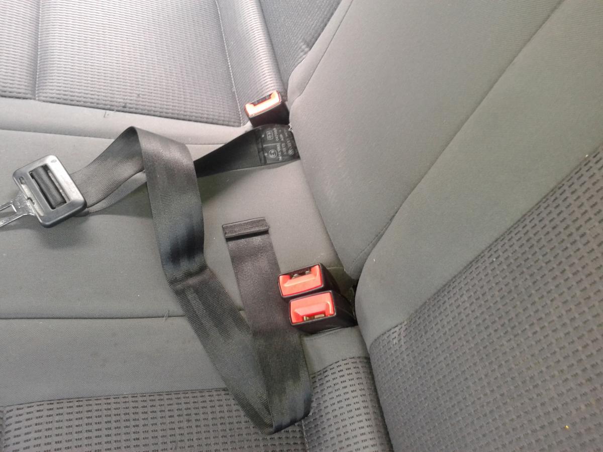

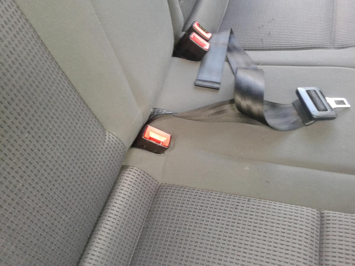

I put the rear seats from the Polo in to see how they look. Having never taken the rear backrests out before I was surprised at how damned easy it was. Push clip back with a screwdriver and pull away.  Overall not too bad but a couple of minor niggles with the fitment and the seat belt positioning.
Unhappy with the Fabia rear seat belt buckle misalignment, I nipped to the scrappers quickly this lunchtime and lo and behold, they had a Polo 9n in!
Buckles removed, £10 exchanged and a few minutes after getting back, aligned Polo 9n buckles in the old fella :thumbup:
Much tidier. :)

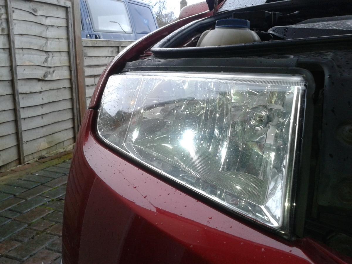

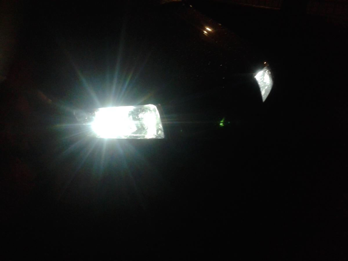

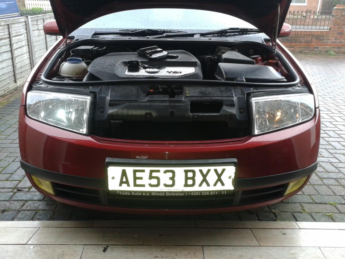

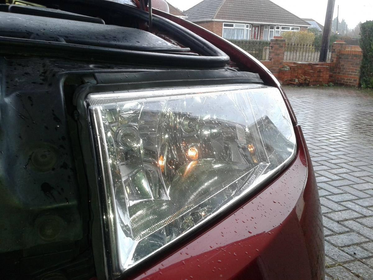

Thought I'd bring the old fella into the 21st century and 'get down with the kids' so I ordered some LED's for the sidelights and number plate lights. Much better and worthwhile for the price.
Ordered from 'Fizzmo' on ebay.
post-73816-0-36165700-1393505962_thumb.jpgpost-73816-0-65922000-1393505975_thumb.jpgpost-73816-0-80967100-1393505983_thumb.jpgpost-73816-0-03560900-1393505997_thumb.jpg
Much brighter and a cleaner look.

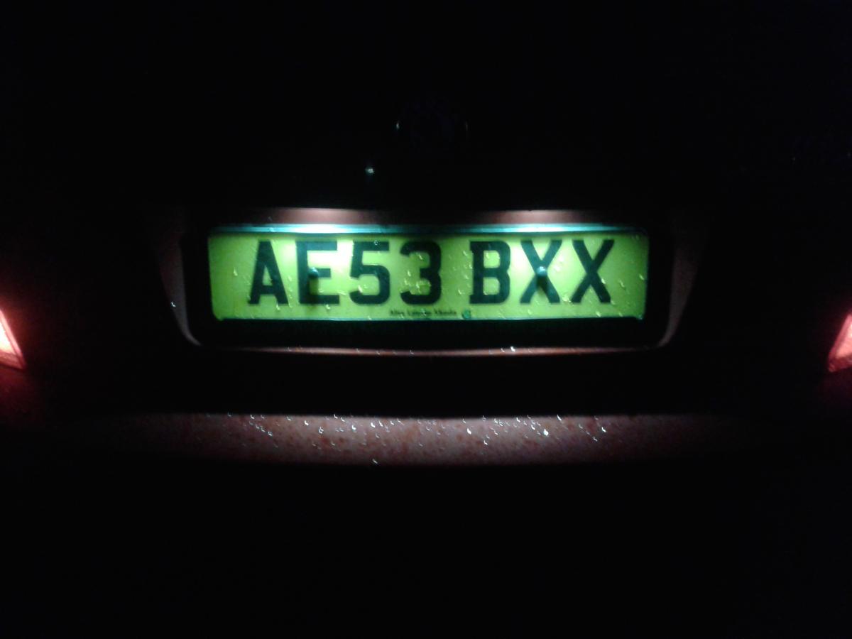

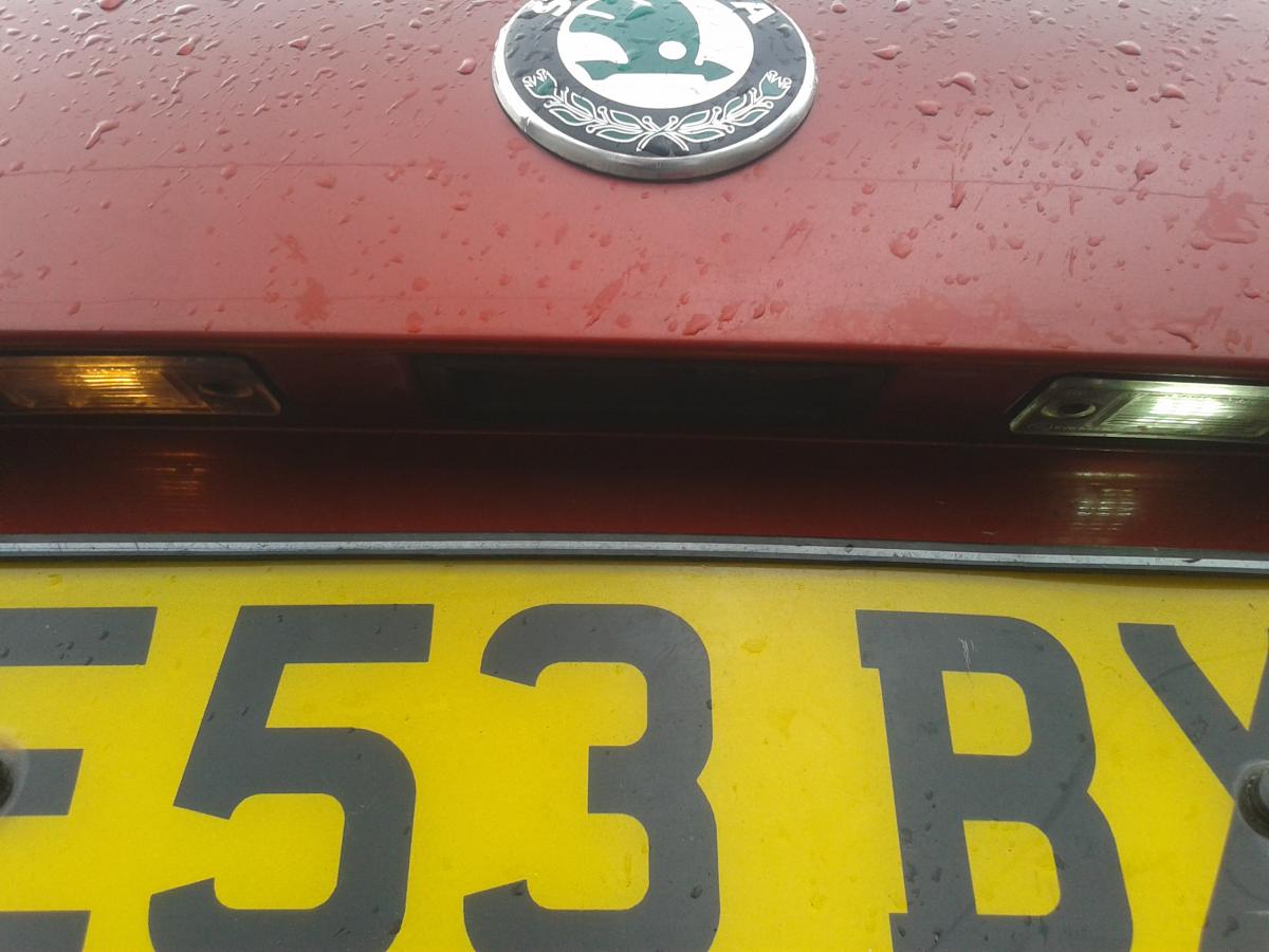

A quick five minute break in the rain and the number plate lights were done.
Night pics
The number plate lights shine like a heart :D

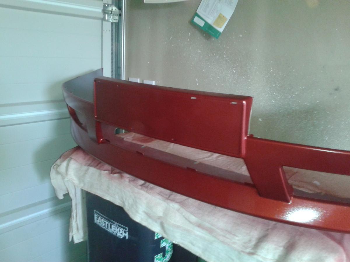

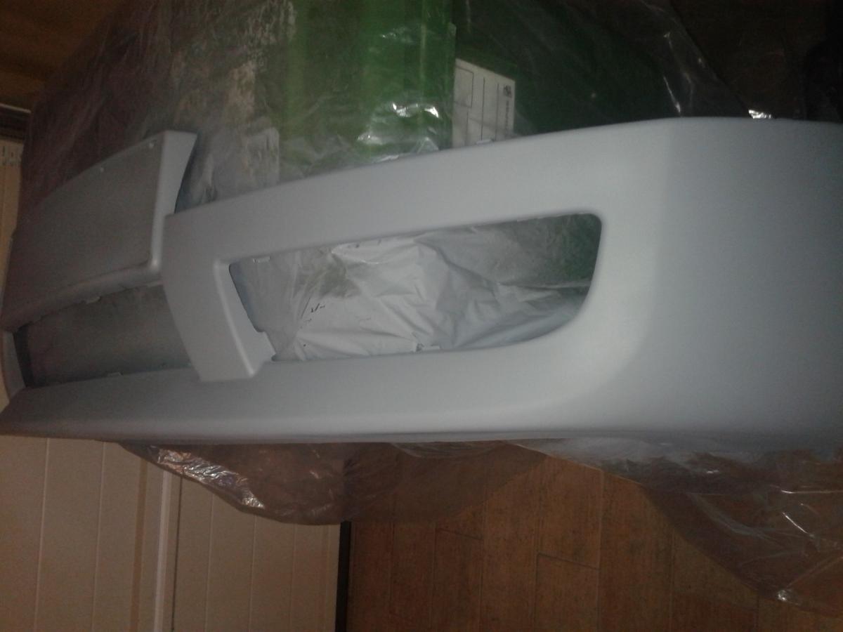

not much of an update but rattle canned the first coat of primer on the Sport bumper today. Quite pleased with the result TBH; no runs or other crap. Next coat of primer probably on monday.
Is it a straight forward to fit the sport bumper to your old one
yes, very easy. Remove the black trim and number plate holder, It then clips into where the trim etc was clipped in. Acouple of squirts of adhesice/ bonding agent and a few plastic screws. (Simplified but that's about all there is to it). I'll know for sure in the next week or two ;)
Nice - keep coats good and thin, and have patience with it.  Worth it in the long run :thumbup:
Cheers, Jase. That's the plan - hope it works out :sweat:  Third can of primer tomorrow!

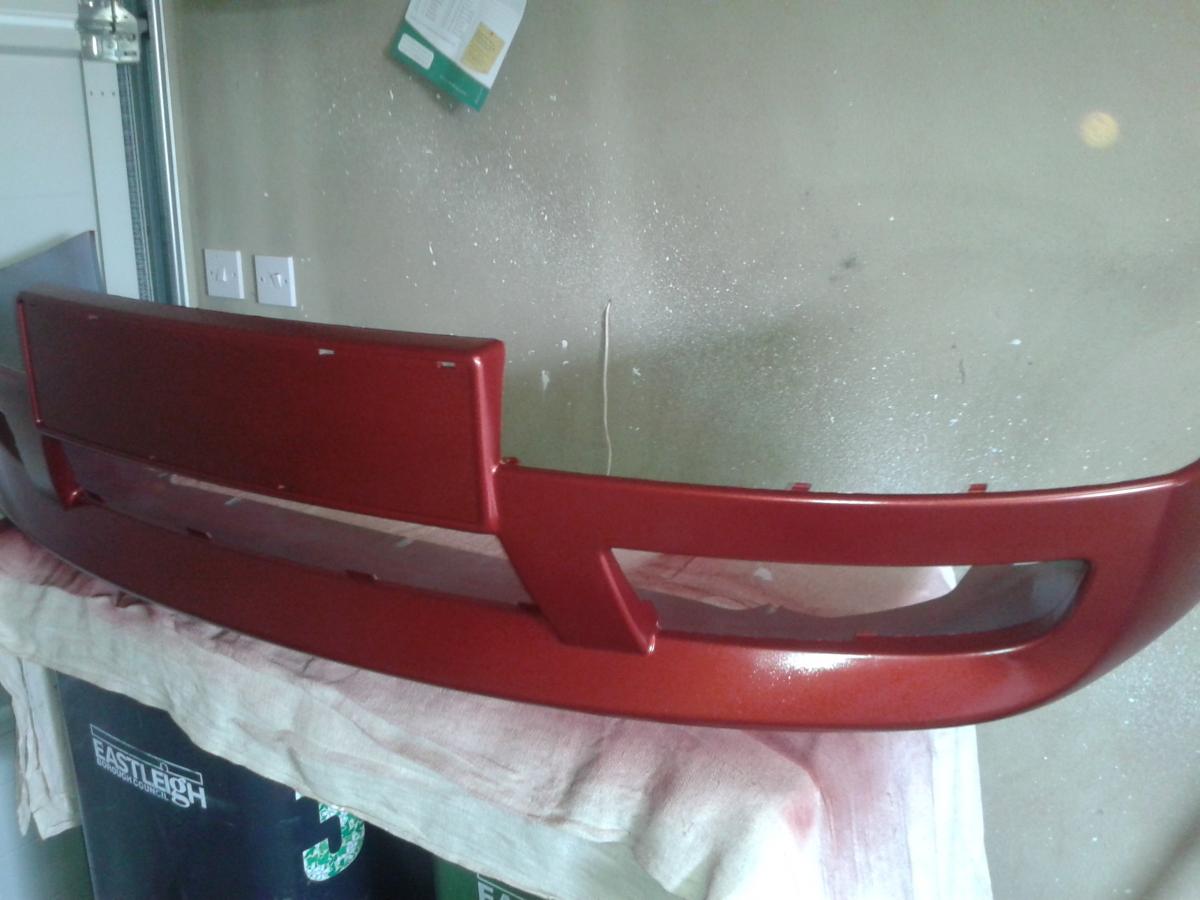

Got the first couple of coats on today, more paint on order. Still no runs which amazed me! Excuse the poor potato cam pic and the texture. The texture will be much better after polishing and possibly a rub down with some 1600 grit.
Looking good Lee.
Looking good Lee.
Thanks, Charlie. Slow n steady :)
Good job for doing it yourself too :)
Surprised myself TBH :D Mind you, half an hour rattle canning and my index finger is knackered and aches after keeping it on the spray nozzle :D
I found that when spraying the grille :D had to move to my left hand
It's something I thought of after I did the spraying :D will definitely get one myself next time I need to do anything :)
