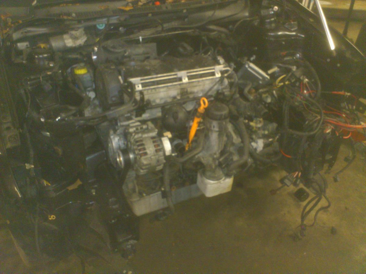

Update, well I have spent all weekend from sat lunchtime, till 9pm sunday doing bits, mainly prepping the engine to get it back in the car, fitted the new clutch and bolted gearbox on, spent ages drilling the turbo housing bolts with a 3mm drill so they can be sealed by the scrutineer, that was a right pig to do and I ended up changing then to m5 caphead bolts so they were easier to drill :@
I worked a deal with work for the bits I still needed off a 2.0 fabia we are breaking, so I had to dig that out and remove the driveshafts, gear change cables, slave cylinder and clutch pipework and starter motor. unfortunately I thought the 2.0 used a big gearbox and everything would fit but it uses the 02T which is different to what I have. the shafts do fit but I am unsure they are the correct length as I have nothing to compare to.. but the gear cables are good as long as you have the 02J bracket to bolt on the gearbox, starter doesn't fit either so I have to have a scrounge around tomorrow as that is the only thing stopping her from firing up now hopefully.
also if anyone else is thinking a asz from a golf is the same as fabia think again I spent a couple of hours on sat drilling and tapping the block as the golf uses a hydraulic cambelt tensioner and the fabia mount won't clear it so I had to swap the entire backing for the belt drive and found that there was a casting for the idler but no bloody hole  :devil: , this goes into the cylinder wall so I had to be very careful not to go too far  :whew: and had to mess around cutting a m8 tap as I only had a taper one and it had to thread the blind hole all the way down  :wall: . also the oil filter housing is different and uses a different filter (same filter as octavia) as well as having the pressure switch on the other side of the housing.

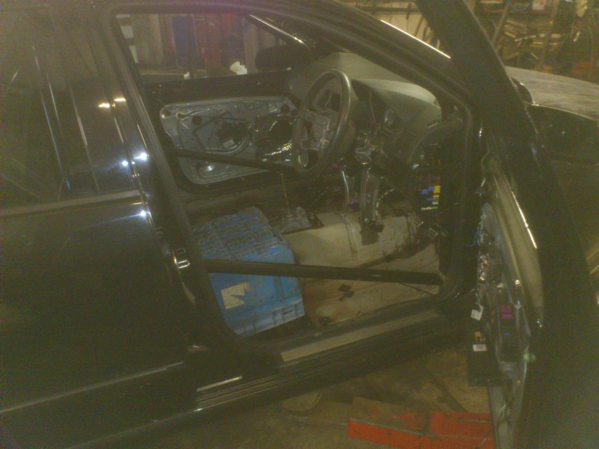

swapped the tinted glass out and replaced the electric front window mech with wind up ones and totally removed the rear inner doors and bolted the glass in place.
