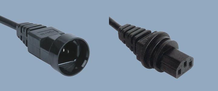

I have had a revelation with the plug problem.......I could use an IEC (kettle plug) connection. They are relatively compact and could conceivably be concealed behind the front bumper in a sheltered location. I would want to keep any 240v wiring runs to an absolute minimum on the car to guard against any chafing, so the front bumper would be my preferred location.
This is what the golf boys used.
The very thing I was thinking about!
Although it's not shown in the photo, there is bung with a finger loop on it. It keeps the socket watertight when the plug is not connected.
IIRC, they came as part of a kit that hinged the LH small, lower grill.
Even better. Sounds perfect......Seriously tempted to install one now.

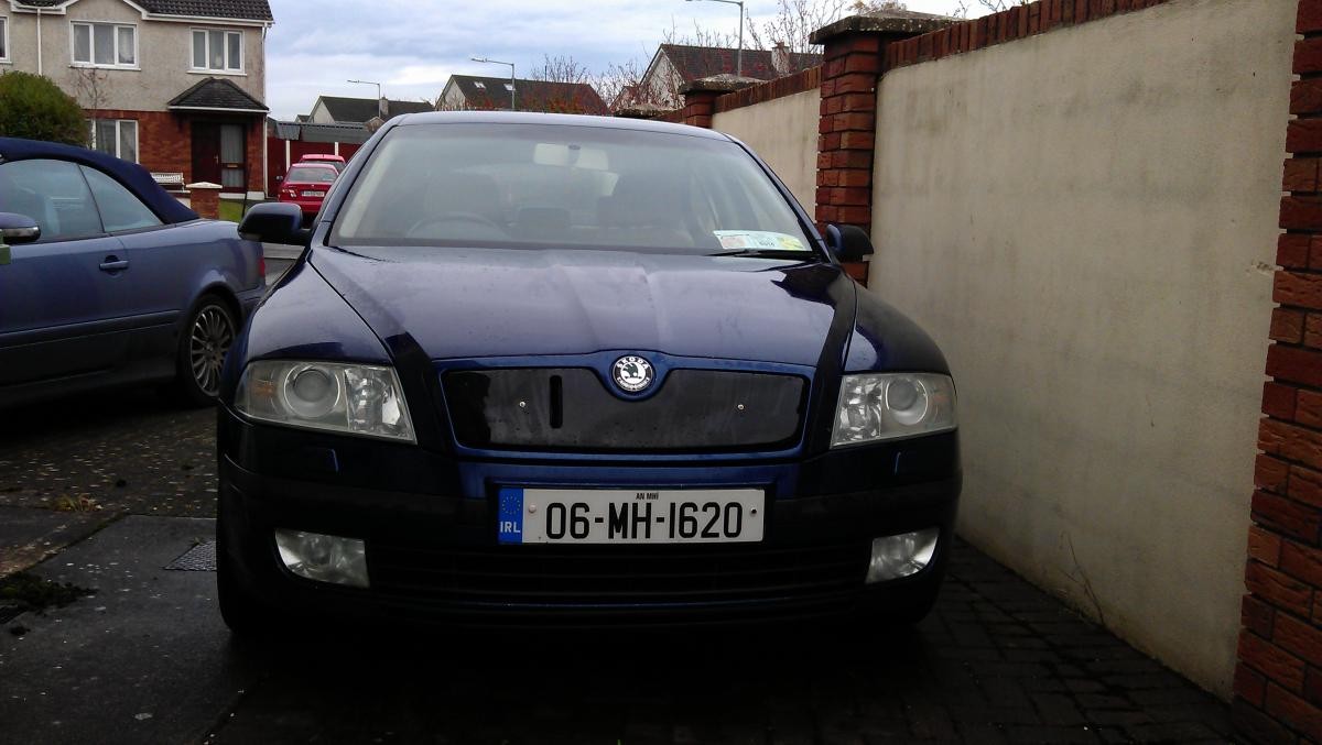

This is the Heko grill cover fitted to my pre-fl Octy. Goes on very easily but I would prefer it if the screws where black. I only fitted it today but I have a very early start in the morning so we'll see how it performs (or not)post-22824-0-29941700-1384700904_thumb.jpg
Looks good, maybe a bit of spray paint on the screws? Or find some anodized ones the same size
Thanks for the pics. No way I'd be leaving those screws as they are, would annoy the hell out of me, especially on a black car with a colour coded grille surround as well!
As said, a touch of black paint on them, or some black screws :thumbup:
