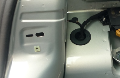

Our Feb13 build car had the holes in the metalwork already just needed to pull back the plastic trim to see where to drill for the clip.
That's a result then! Our Citigo is an early one. I see you still had to cut the plastic trim though
Owens. Reference to your previous 'posts' and 'thumbnail' pictures. When you say that the holes are already drilled, from the 'thumbnail' picture it looks as though you have had to drill another hole for the grommet?  I fail to see why it is necessary to remove the trim and cut a piece out. Why can't the upper hooks be just screwed straight through the trim and into the metal underneath with the self-tapping screw that comes in the kit? I think it would be secure and look neat and tidy. Unless there is some wiring or something else underneath the metal where you would drill I cannot see why it is so complicated a procedure just to fasten two plastic anchors for the top fastening of the rear net. Your views and advice would be most welcome, having been through the fitting process.
On early Citigo's you need to drill and file the hole to fit the screw insert. On our Feb 13 build the hole was already there. i just popped the insert in and cut the trim. The hook moulding has a lip that locates against the inside of the black trim for extra support strength.

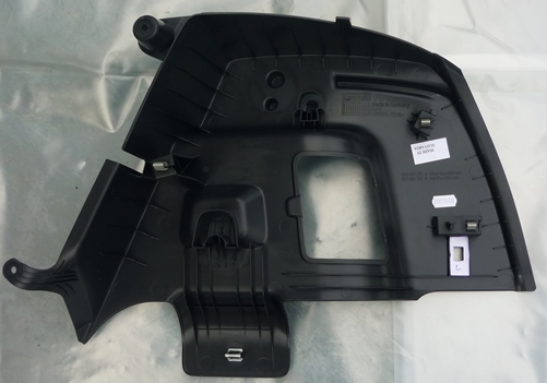

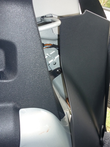

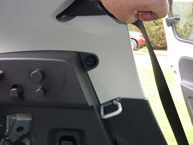

Owens. Thank you for the explanation. I now understand the pictures better. How does the trim come off please. Are there any screws? or is it just 'clipped' in place? JSRW.
There are two screws and a three push in/out clips that hold the moulding in place.
I fold down the rear seat and carefully pull the top of the trim by the door inwards (towards the other side of the car) see pic.
the other screw is at the top front of the moulding by the rear seat closed position.
On the boot side carefully pull the mounding towards the other side of the car to release the three clips see pic of reverse side of moulding
