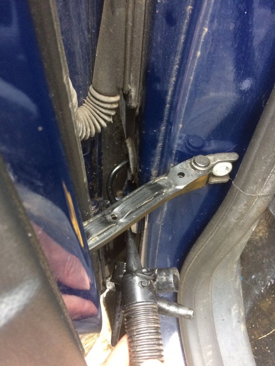

Issue with small drips in passenger foot well beside bonnet opening lever. After much looking found poor bonding on tube at upper joint of forward drain. Sealed with T7000 glue. The red tube was not bonded all round the white grommet. So far seems good.

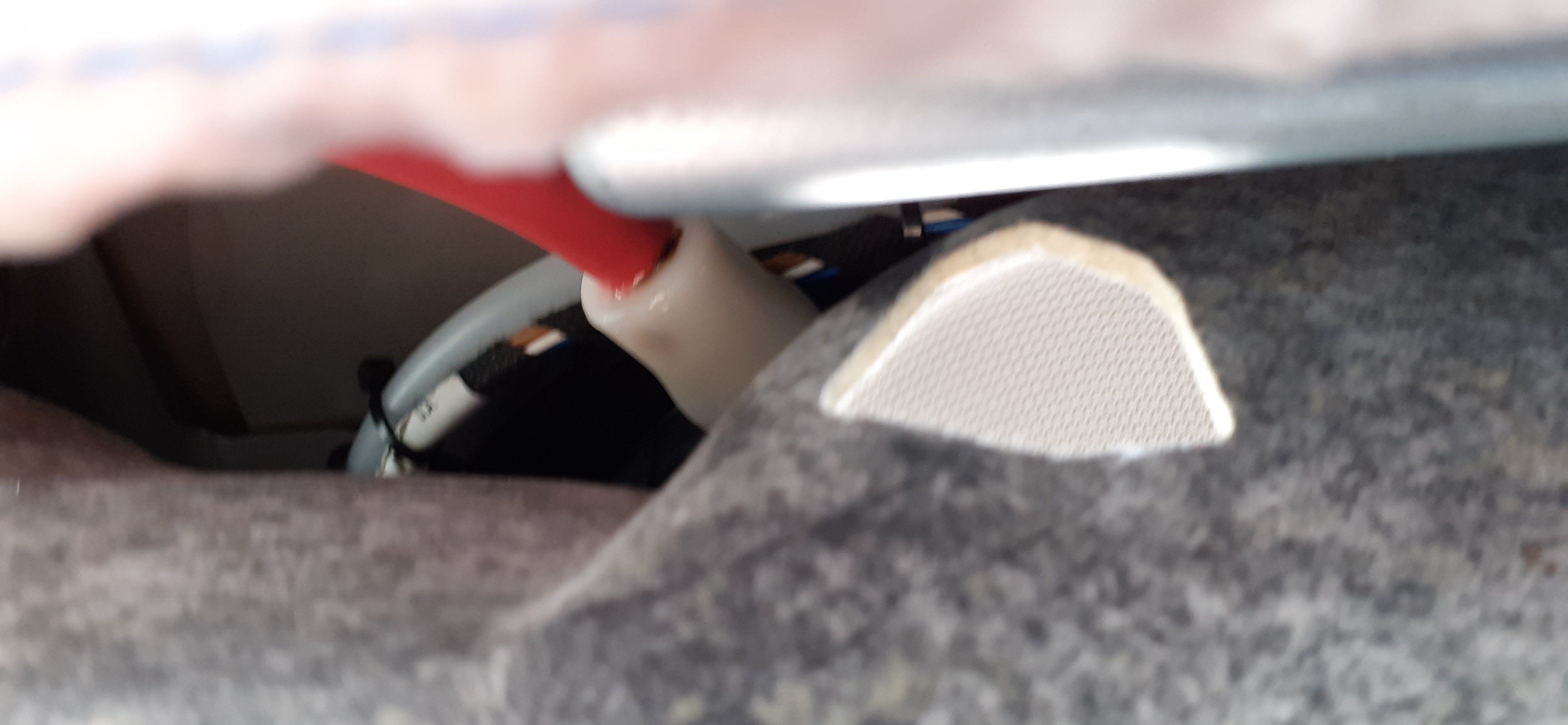

I've had the dreaded sunroof leak issues.
At this point (thanks to a guide found on this site) I have removed, fixed and re-installed the sunroof.

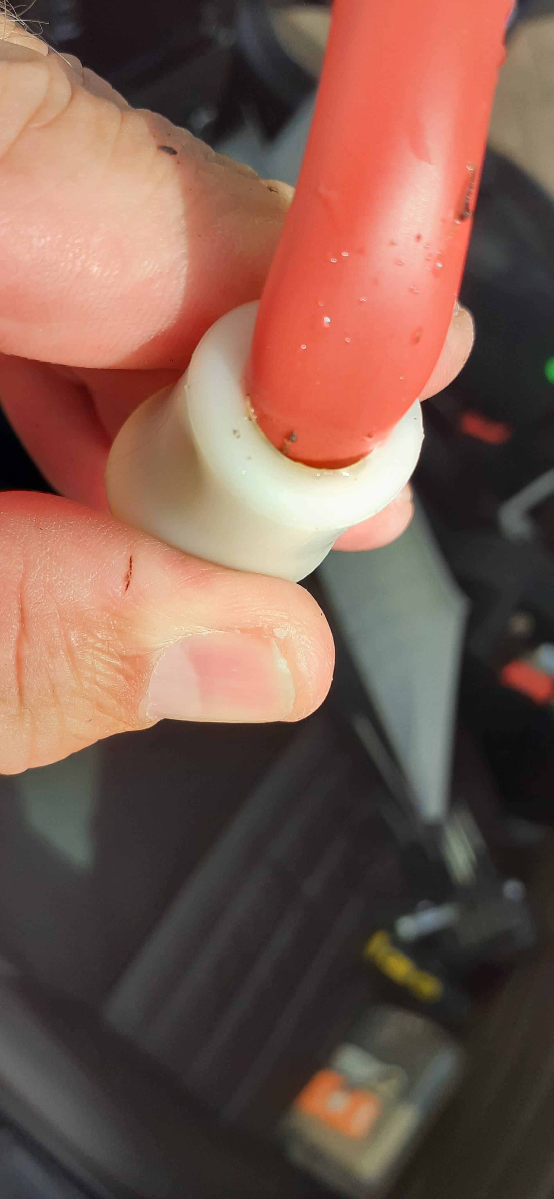

However the now the front right drain tube has detached from the rubber grommet on the door pillar.
I have taken the lower dash off and been able to get the drain tube back into the grommet - by feel only, I can't really see it.
However it seems to come out again really easily.
Are there any suggestion on how to secure this in place.
I've tried a cable tie, which I can get around it but can tighten, as I am doing it all by feel with my finger tips.
I'm wondering could I take out the grommet, push out the drain tube and then cable tie the tube to the grommet, and push them back in. My fear is that I won't be able to get the grommet back in - its a tight spot in between the pillar and the door.
Any thoughts ?
