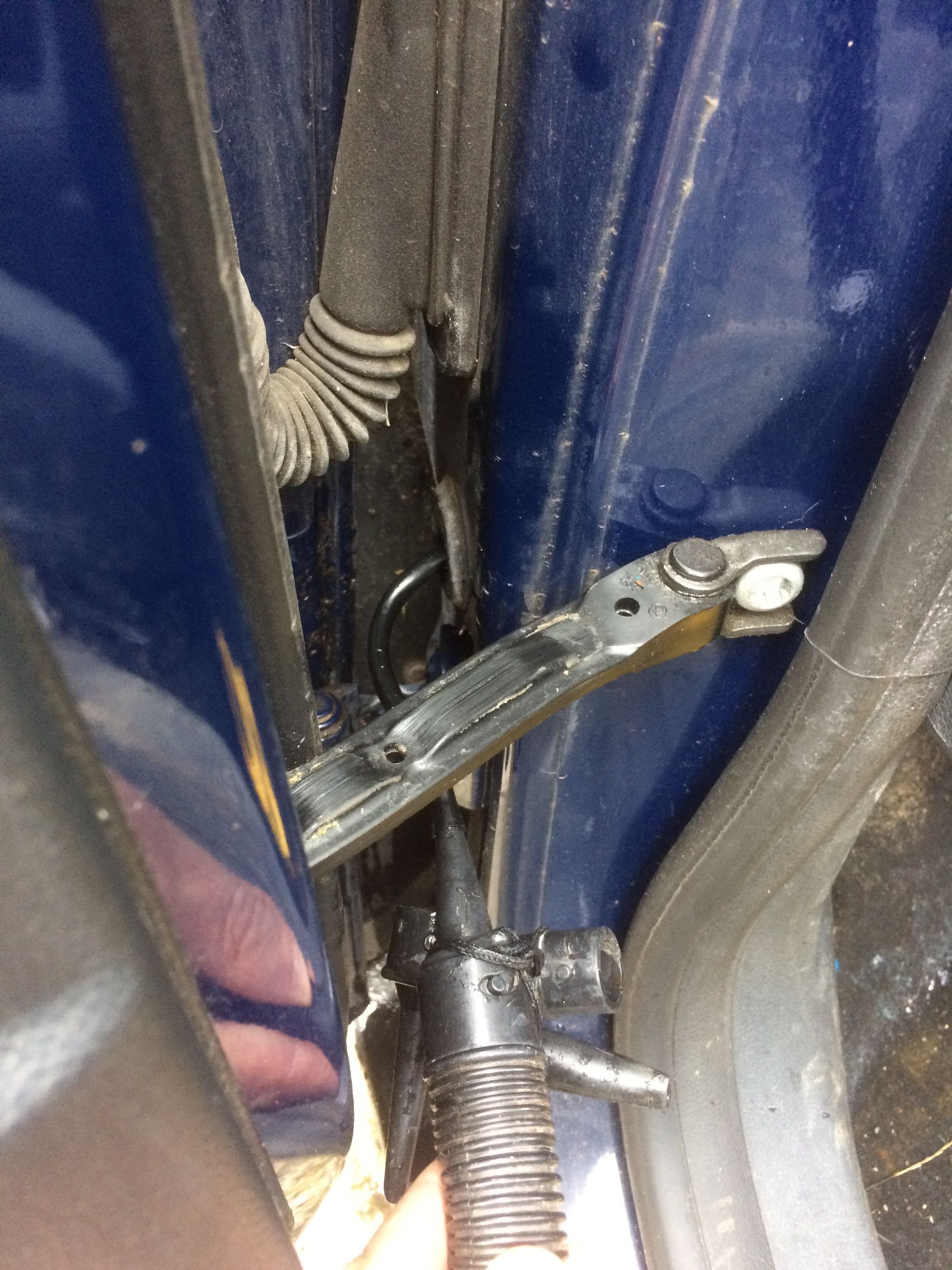

I fixed it with a cheap dingi pump that blows and sucks and forced a rubber tube over nozzle so i could get it around the corner. Push your finger to get a better seal on the hole. Works well enough.
I filled up the sill so it didnt overflow to soften up what ever was inside the tube and then spent about 30 minutes pumping and sucking the tube until it finally ran clear.
(this was how the water was getting in, not apparently the seal between the tray and the tube as this post thread opens with)
I had contemplated ripping the lining out, following the original thread suggestions, sending it in to be looked at, dry storing it, etc etc. Actually just comes down to mud in the tube and should probably be treated as a general maintenance job for these yetis.
Cant believe it was so simple all along. Absolutely drove me nuts.
Save your money, use a two handle suck blow dingi pump and a rubber tube.
Fill the tray a little and see what the rate of flow out of the outlet holes. Dont over fill it. If you look,  the water is getting in by this point overflowing into the door pillar even if it actually still drains a bit just not well enough. Dont stop pumping until it is clear that the noise is coming out of the top as well with a gurgle.  Bit of bicarb was my next point of call.  has a habit of appearing to be fixed and then blocking again while you are doing it so persevere.
Dust settles in the tray, get damp, sets hard, flakes and then accumulates in the tubes. - Inevitable.
Solved and for me at no cost at all.
