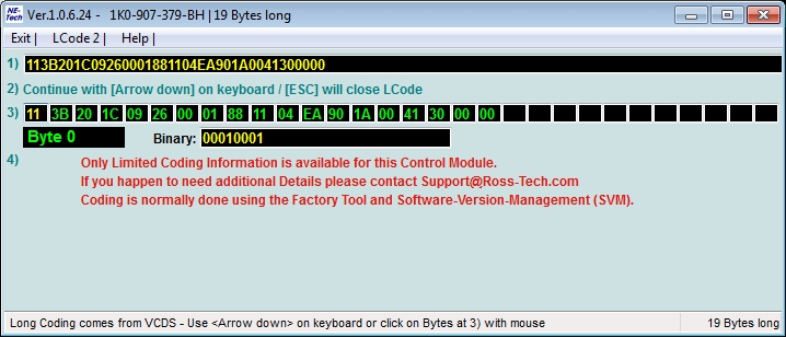

Hi Eddie,
do you have info on 1K0 907 379 BH  ABS unit whether HHC can be enabled on it or not?
Indirect TMPS without TMPS reset button, but with reset via Maxidot works on BH,

Thanks. In the meanwhile I've found this post of yours, so it's clear. What made me thinking: UG0/UG3. Is it posible to enable XDS without HHC?
If yes, how? I've only found Byte 17,  bit 3 in ABS, but it corresponds to UG3/UG4. Is there an option to enable XDS with UG0/UG3 PR code?
According to singh946, he has XDS without HHC. His Byte 17 is 08, which means bit3 is ticked, if I'm right. But I can't  check Byte0...Byte14, because Ross-Tech had hidden it.

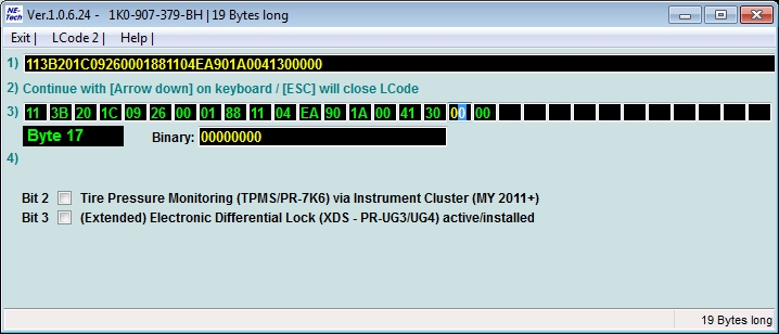

XDS should be possible on BH, only early versions of Mk60EC1 didn't support it
VCDS doesn't always give you the options that are possible
I've tried it (tick Byte17 bit 3) and the code was accepted.
I've also checked the XDS option in the Adaptation menu, it is active now (there options are available). Before ticking Byte17 bit 3 this adaptation option was not available.
Beside this is there anything else to doublecheck whether this coding is ok and doesn't have any infulence on other systems? I'm always a bit suspicious and anxious when it comes to mess with the ABS.
just set it to the level you want
