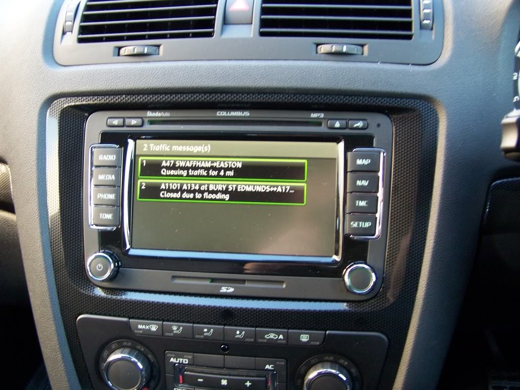

Columbus with Voice control
Shark fin GPS on the roof
5K0 or 3c8 bluetooth, not sure yet
mdi in the glovebox with fly lead
rear view camera

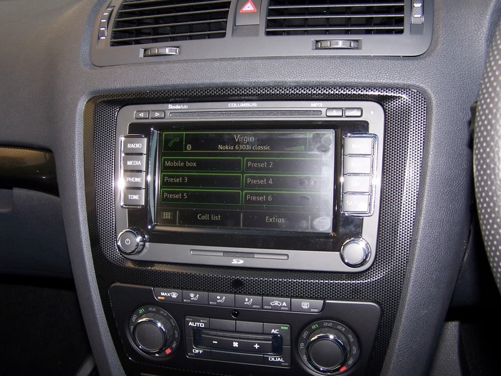

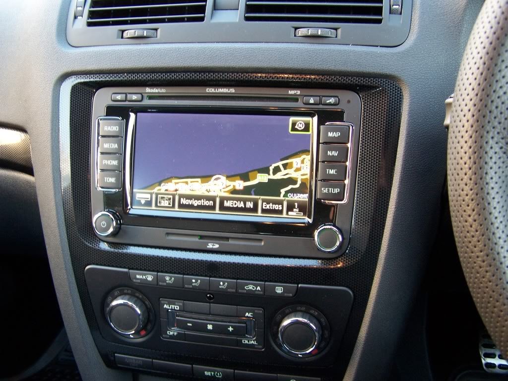

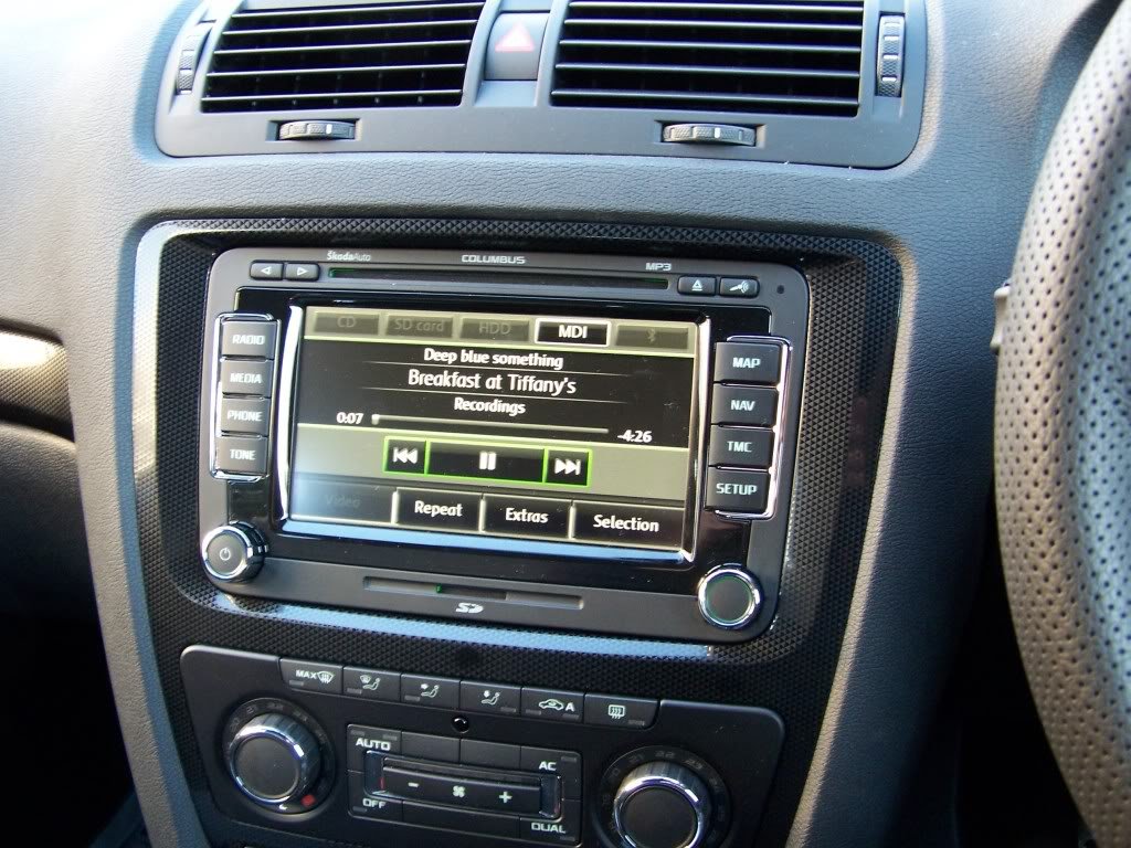

Columbus Nav with Voice control

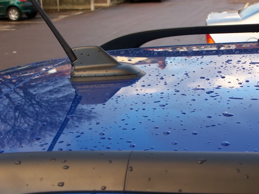

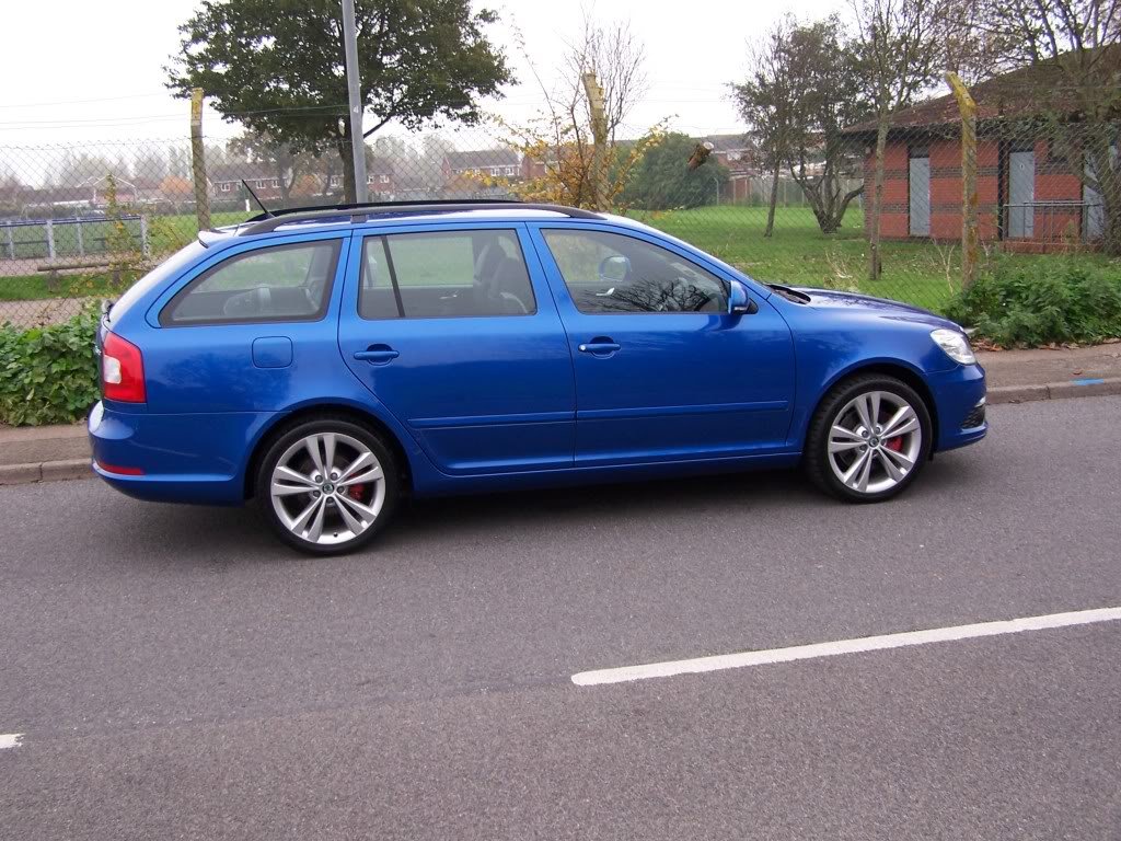

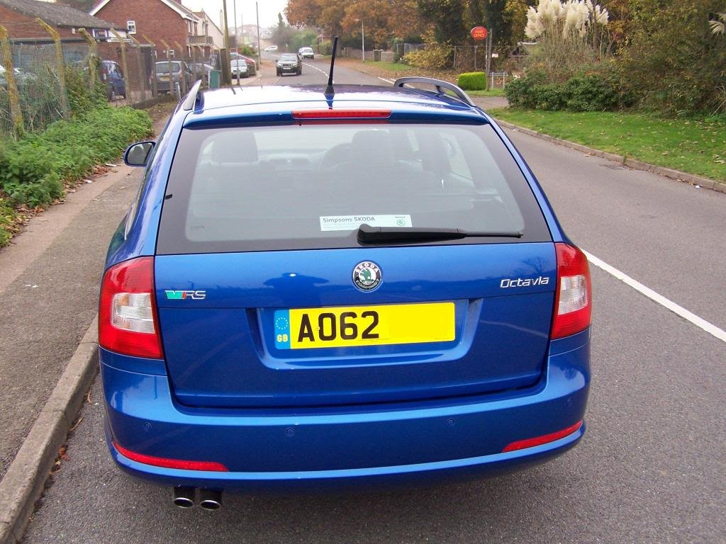

Shark fin on the roof

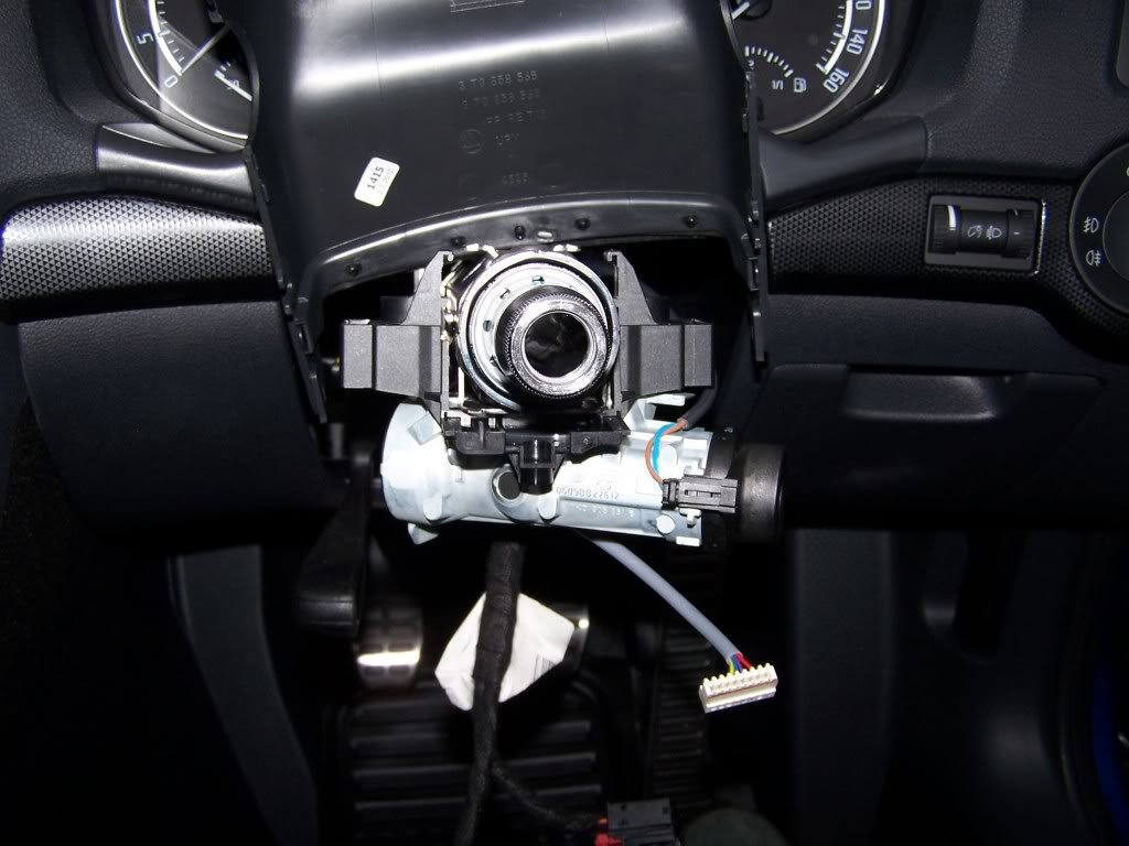

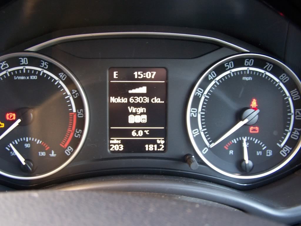

5K0 Phone kit with full maxidot and MFSW integration

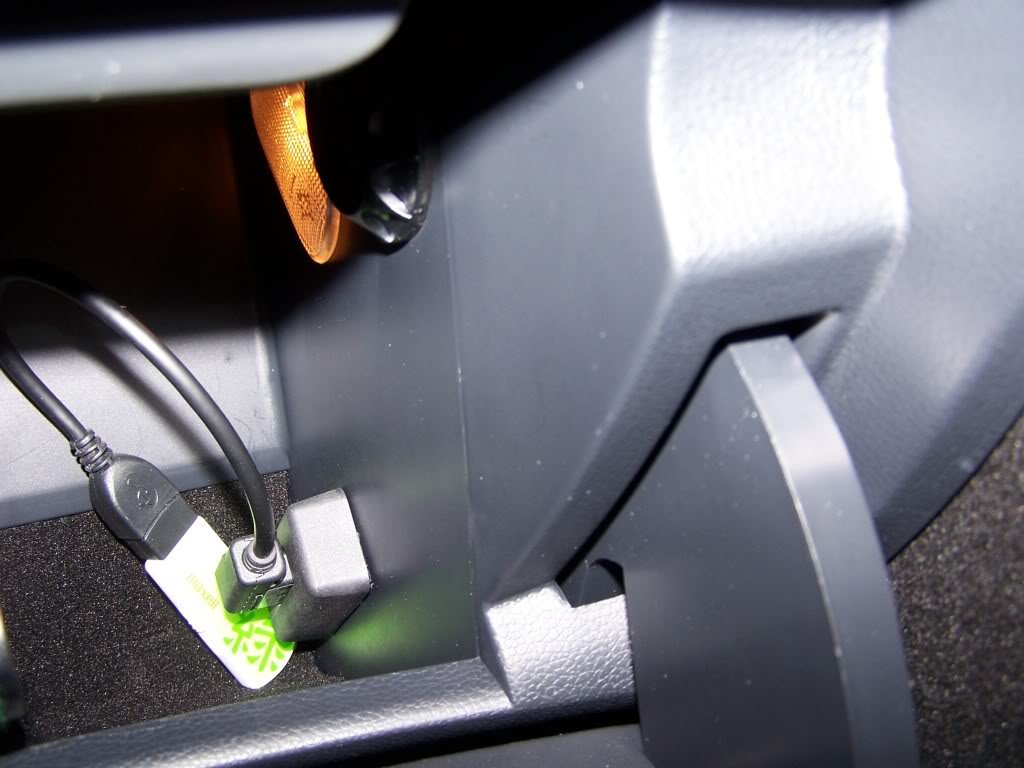

MDI Glovebox connection

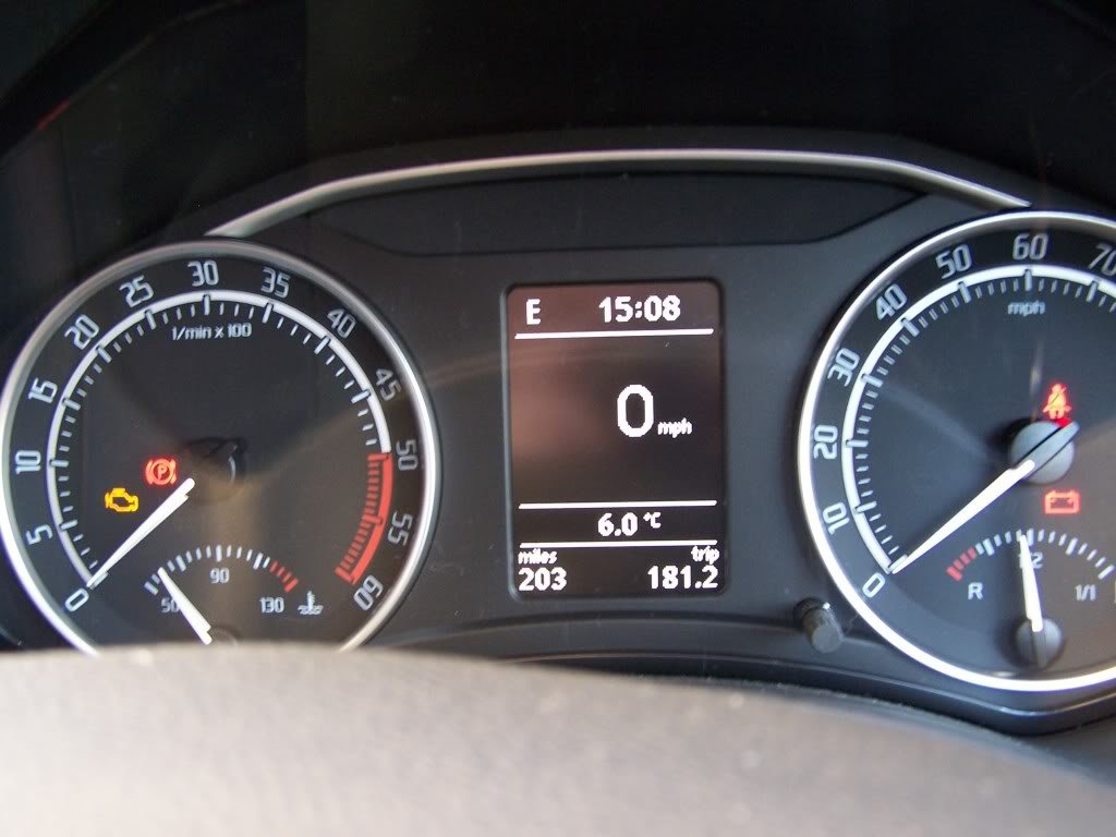

Large MPH Speed display enabled

Columbus Navigation
Roof Antenna
Oem Bluetooth

MDI Glovebox
Coding Large speed display

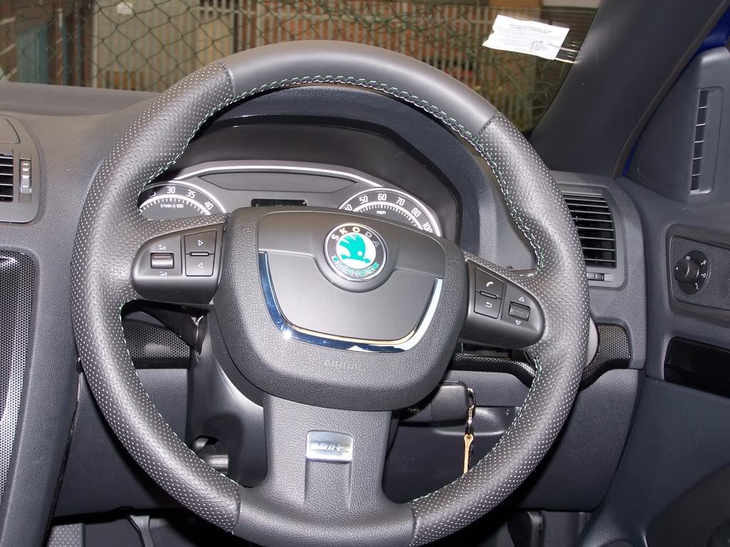

New Mfsw wheel that I fitted on the day I collected the car

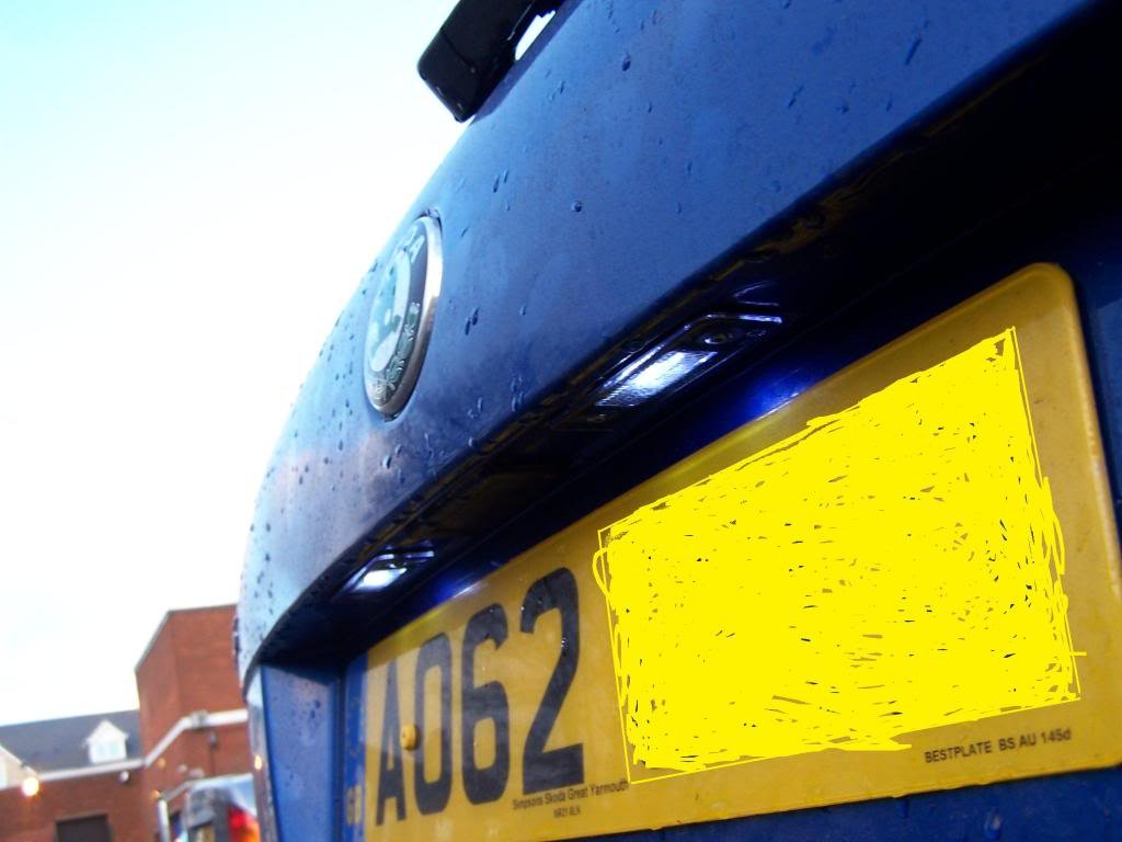

Hi how did u get round the warning on the dash when u changed the number plate bulbs to LEDs
I coded it out, there is an option in the long coding for LED number plate bulbs

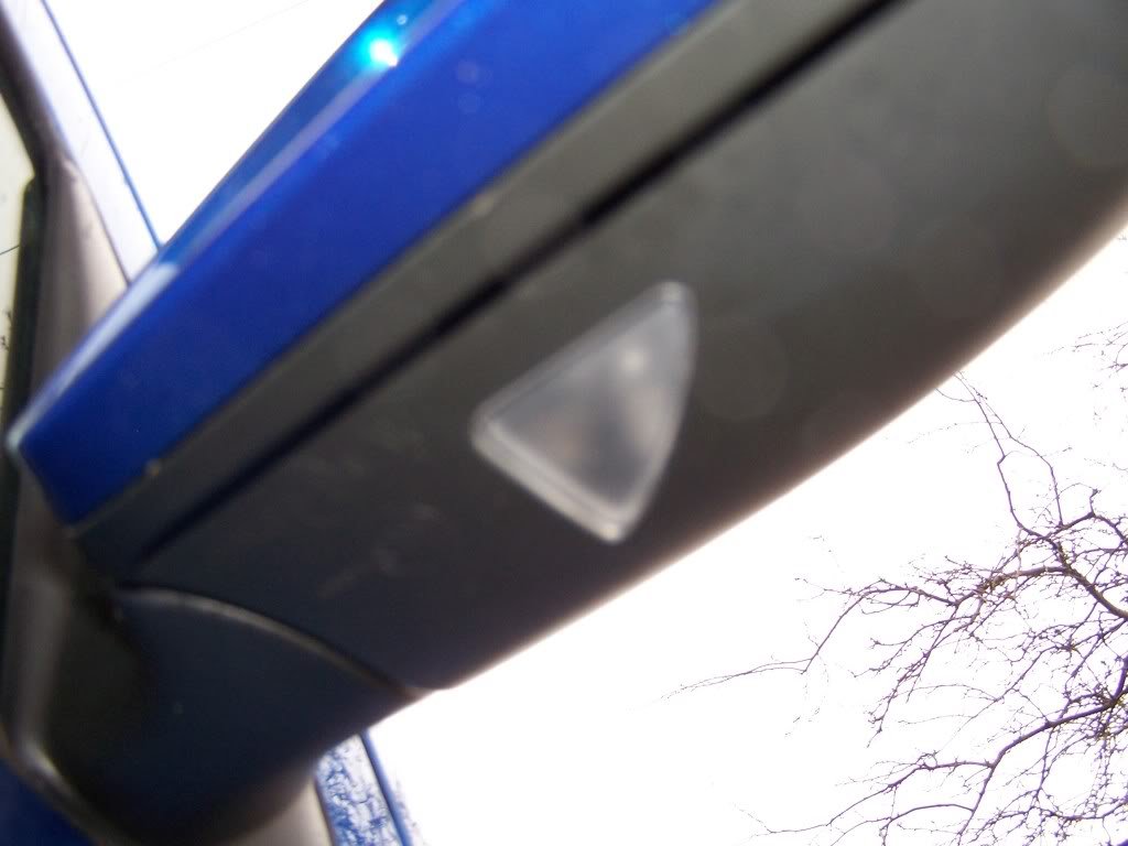

Outside Mirror ambient lighting

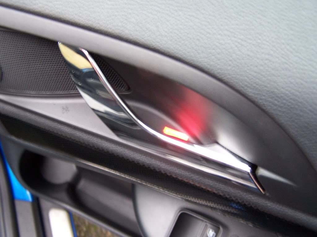

Interior Door handle illumination
Did you do all four doors and have you posted a 'How to' somewhere Eddie?

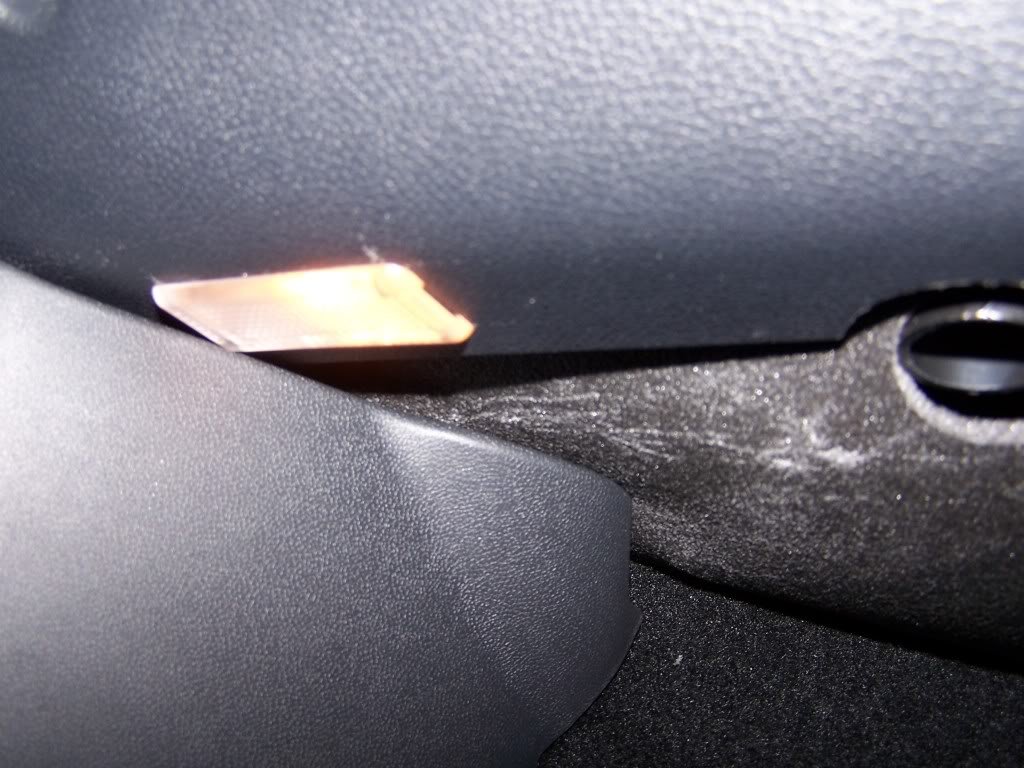

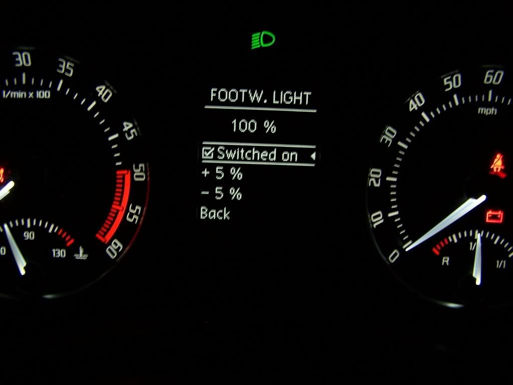

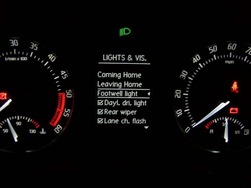

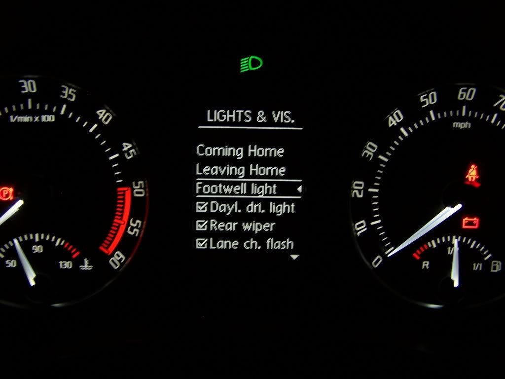

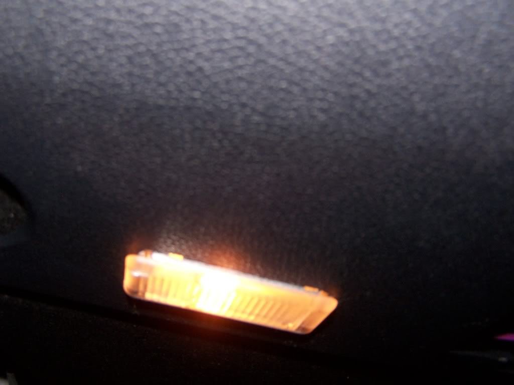

Footwell Lights Fitted today, Front and Rear
