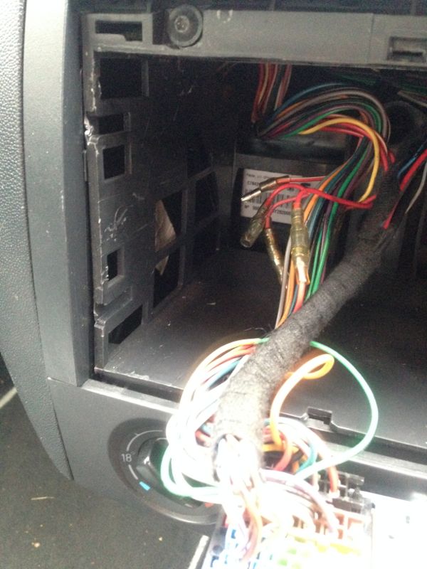

I pulled out the HU to check the wiring, all looks OK. Two cables aren't plugged in but It doesn't look like they have anywhere to go?

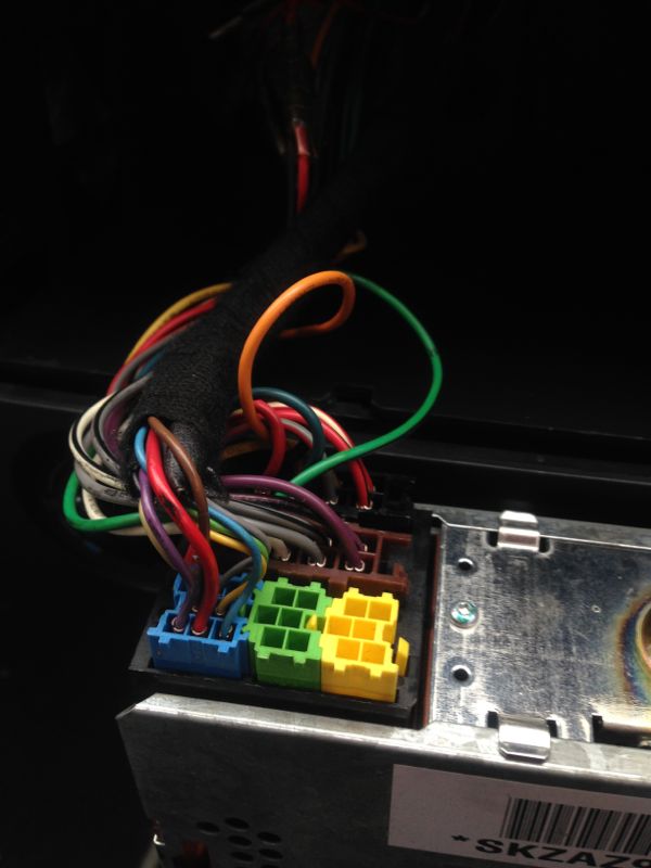

Those spare wires look very after market to me. Is there a wiring harness/adapter in there? From your piccies it looks like you're running a standard h/u.
I'm gonna say someone had a different set-up at some point and has reverted it to standard. Looks like some of the extra wiring is still there.

Possibly has had an after market in, although I don't know that.  The cables that run from the loom are all joined by connectors (same as the two visible ones in the photo)

http://www.tehnomagazin.com/Auto-radio-car-connector/SKODA-Car-Radio-Wiring-Connector.htm
^ Hopefully that might help. The blue connector is dedicated to the CDC. The brown one to the speaker outputs. Though if one speaker (or door set) is playing up, it's also possibly a problem with the connectors in the kick-panel or to the speaker(s) themselves.

The original wiring would not have had any inline connectors.
