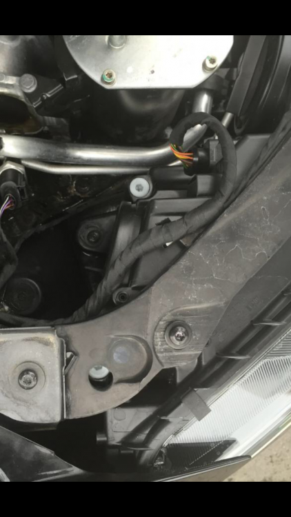

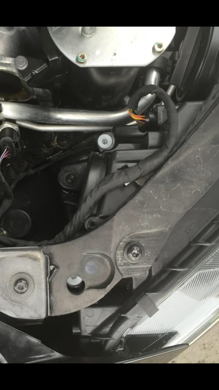

If you open the bonnet you'll see some white hex adjusters for the lights - the closest one to the wings is the height adjuster (you'll have to look carefully as it's hidden under a metal plate, but it's easy enough).
Just get the car on a flat surface and you'll be able to adjust up slightly - I did mine a couple of turns each. Still better to pop into a garage though, as they have proper beam alignment machines and they'll charge you pennies to do it.

You sure you have identified the right adjusters? I used the hex ones down by the bulb covers for vertical movement. I’m sure the ones by the wings are for horizontal movement.
Both sets of adjusters are are white and show up in the dark from light bleed when the headlights are on so you can see them.

Apologies, you may be right!
Not had the car for over 6 months now, was trying to jog my memory without seeing the car.

Worked a treat! Adjusted, working great, can see where I’m going now!
