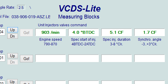

This is possibly a problem..does it look like the timing is out?

When I did mine, in the Meas blocks - 08, then click up into Group 004, and in the 4th window (Torsion Value) I set it to 0.00.
DB
Yea this is group 4 option 4 so from what your saying mine should be zero
