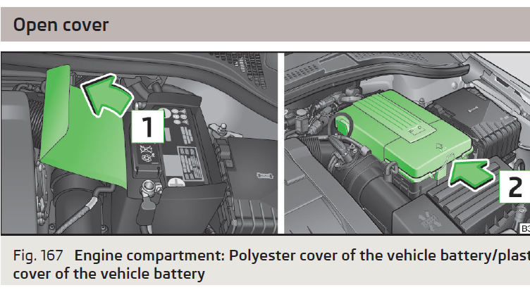

Are you sure it is in the boot, when i was looking at them in showroom the battery was under bonnet in engine bay. Unless older models where different of course. It was hidden under plastic mouldings as shown in pic below.
The battery in mine is under the bonnet. 2009 though so may have changed the design from normal and [practical to daft BMW style?
If it's a 3.6 V6, the battery is in the boot...
