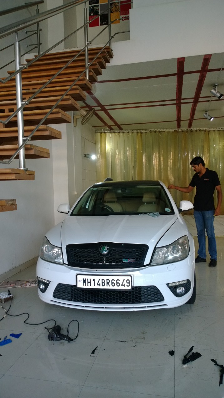

I recently bought a Used Skoda Octavia MK2 1.8 TSi (2009) also known as the Skoda Laura in India. I noticed that the suspensions are not good and make a squeaky sound on bumpy roads.
So I am looking for suggestions; I want to replace the entire suspension kit (every component - lower arms, springs, studs, bushes etc etc). I am new to the mechanics of Skoda cars and need expert opinion here.
Attached is the car pic for people wondering what car are we talking about.
