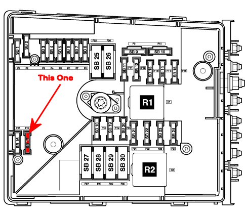

I thought it was fuse F17.

Just realised the manual lists 2 versions of the fuse list F5 in v1, F17 in v2, just gives two layout diagrams and says you can tell which one you have by lifting the cover and checking which diagram you match.

Have just looked in fuse box under the bonnet and there is no fuse in F17 and when I pulled F5 the horn still worked!! I have no idea why unless the continental ones are wired differently. Anyway thanks for the horn relay info I will do a Google translate and see if they are open to suggestions at the garage.
This is the fuse
Thanks for that have pulled it, now I can stop annoying everyone including the local Police who were waiting at the traffic lights in front of me when the horn tried its own version of La cuckeracha (excuse the spelling)
