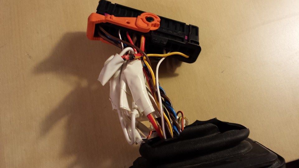

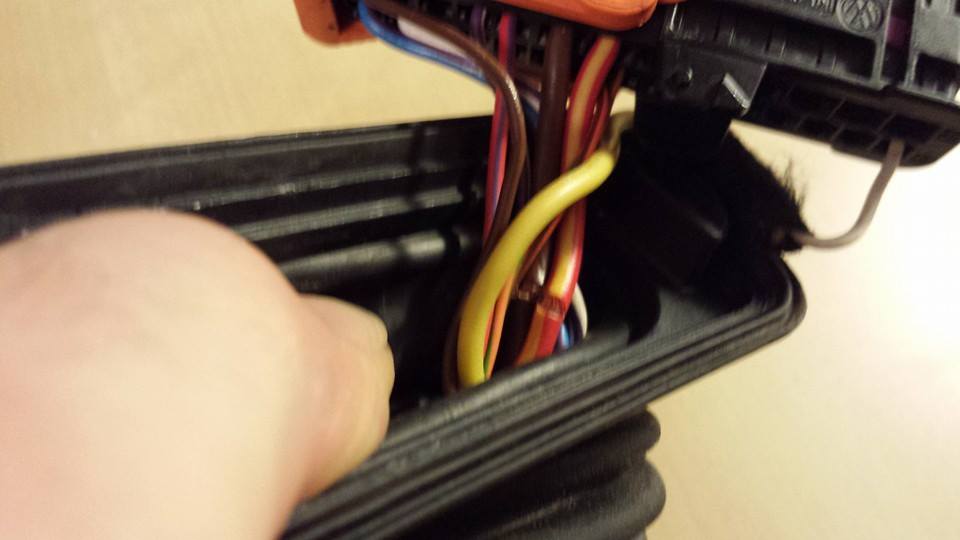

Can you post some photos of the damaged looms ?

photos, sorry about the quality.
I had to chop up the rubber gaiter on the driver side to get access to solder, the passenger side gaiter is intact.
