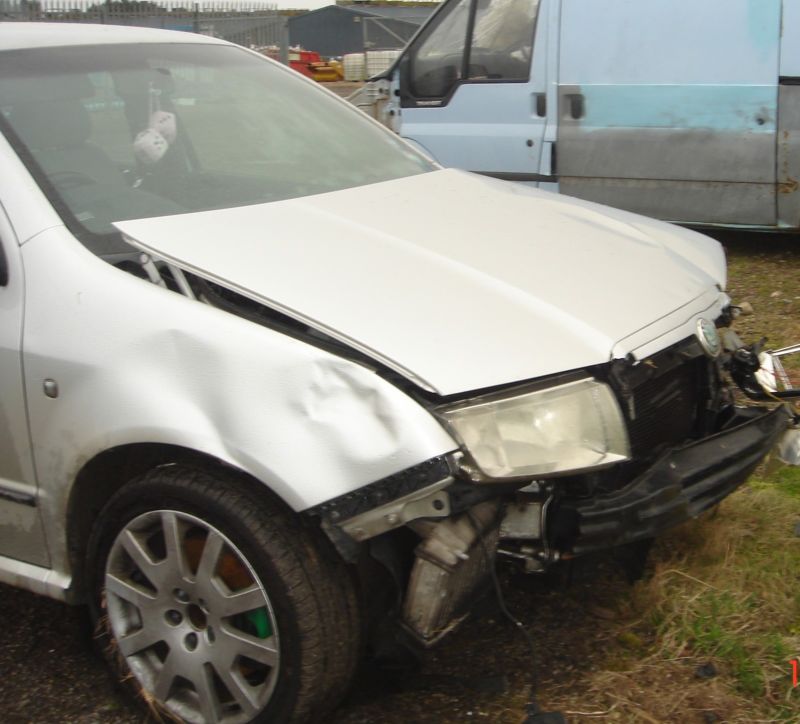

This is what I got:
unfortunately;

the car was stuck in 3rd, the cooling system (intercooler/radiator and ac) was smashed as was one of the alloys and both front wings, bonnet, grill, passenger headlight slam bar, crash bar and the plastic tray for the front end was beyond salvage.as well as a few bits of meal pipework.

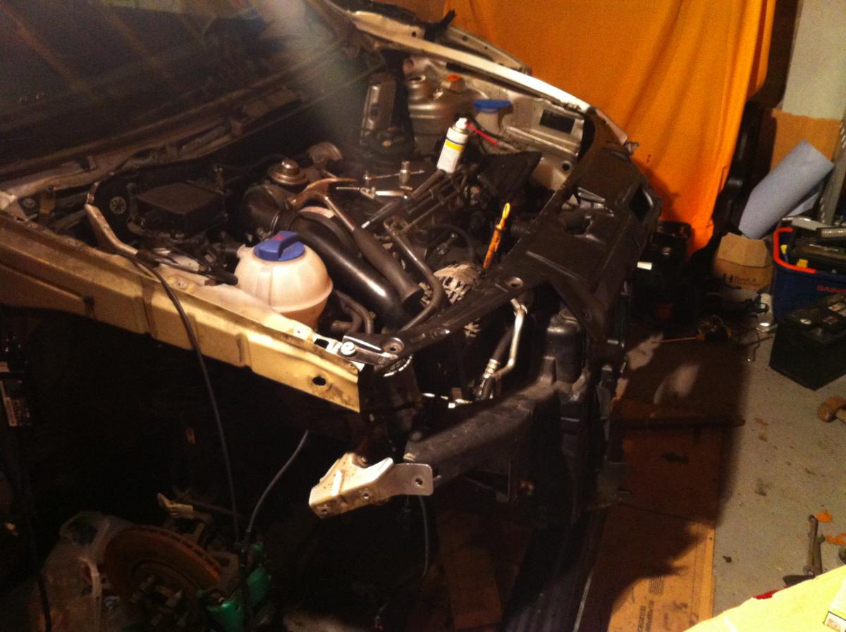

After stripping down the damaged parts, most of it is beyond repair, was stuck in 3rd as the fan was pushed back into the bay and blocking the metal (thingy) once the fan and radiator was out, I got a chance to check the gear selection and she feel perfect, so that is a huge weight off my mind. :whew:
then set about the entire engine bay checking as much of it as I possibly could, spent 6 hours, checking! bear in mind, this car is not just a quick fix then sell it on, this is going to be my baby and will become a hybrid at the end of 2014, first priority is to get it back on the road and get it looking like it should have out the factory, i.e dropped, plastic trim off, tinted lights and windows and wrap the grill. then we'll work on the power mods, one step at a time tho!

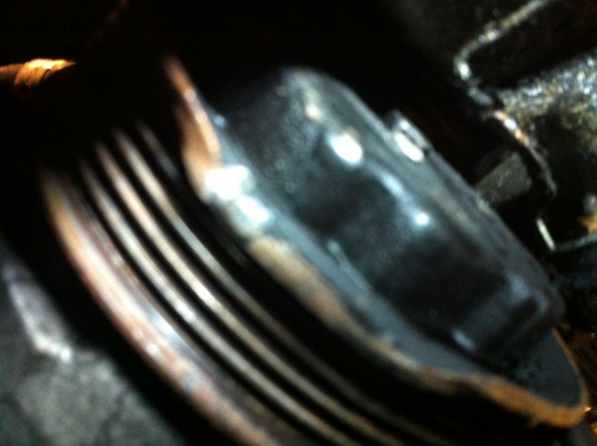

After it was stripped there wasn't much of her left! :sweat: and I noticed some damage to one of the pulleys at the bottom of the block.
do you think this is worth trying to bend it back or just replace the whole unit??????
it had also taken out the lower intercooler pipes but doesn't go any further back, :whew:
sadly the chassis legs were slight off so I used my persuading bar and got them bent back.... After slipping out the leg and hitting myself in the ribs breaking 3 of them things went a wee bit slower over the next couple of days! but I managed to pick up a new slam bar, crash bar and plastic surround for £36 from my local breakers i used this as a rough guide to get it to line up, but wasn't happy with it so I have had the car put on my mates dads jig and i'm much happier with the results!

I would replace that pulley!  Don't take risks with the car in any form, especially something rotating at several thousand RPM.  You want that perfectly balances. :)

I would replace that pulley!  Don't take risks with the car in any form, especially something rotating at several thousand RPM.  You want that perfectly balances. I've looked for one, to no prevail, but my local breakers do have about 3 or 4 mk1 Fabia's so there are plenty of parts just no bumpers, and my mate is a spayer
I've looked for one, but there is nothing local, plus there fast enough that you probably don't get much rear damaged ones! lol my local breakers are very reasonable and they have about 3 or 4 in the yard so parts aren't scarce, I would have been getting my mate to paint them anyways.
cool, I will look at getting the whole part replaced, am I right in thinking that if I take the tension off the belt, as long as I don't move any of the components I wouldn't have to re time it?
I think I'd be doing a full cambelt change, just in case.  Do you know the history of it?
Actually, just realised that's not the toothed belt, its the auxilliary belt.  Fine to just slacken off the tensioner to change.
