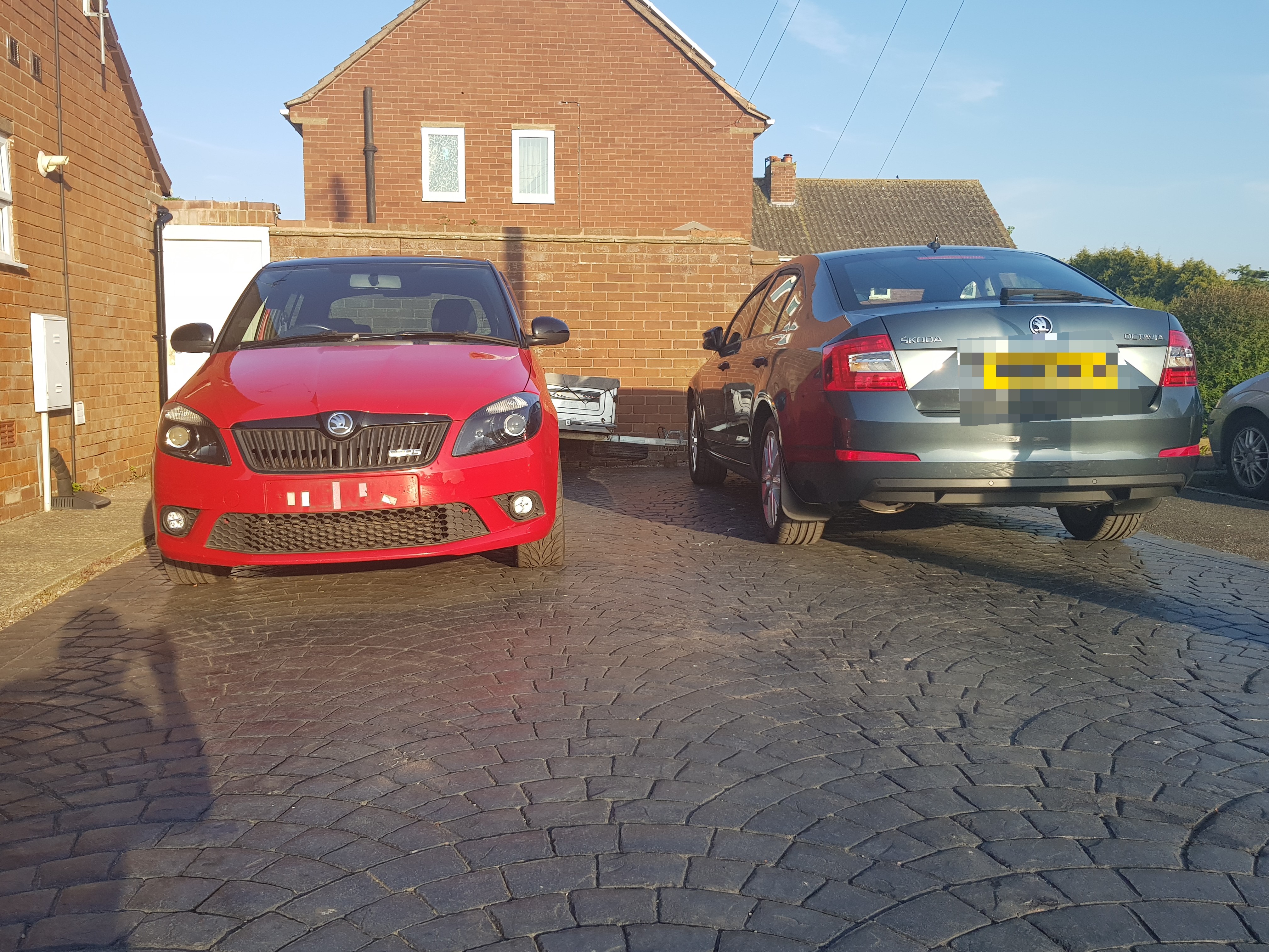

  • Ordered pressed plates last Wednesday and came the following day Really happy with them, all legal and above board.   Front one is in a temporary place for now. ignore the colour of the car, was ge
