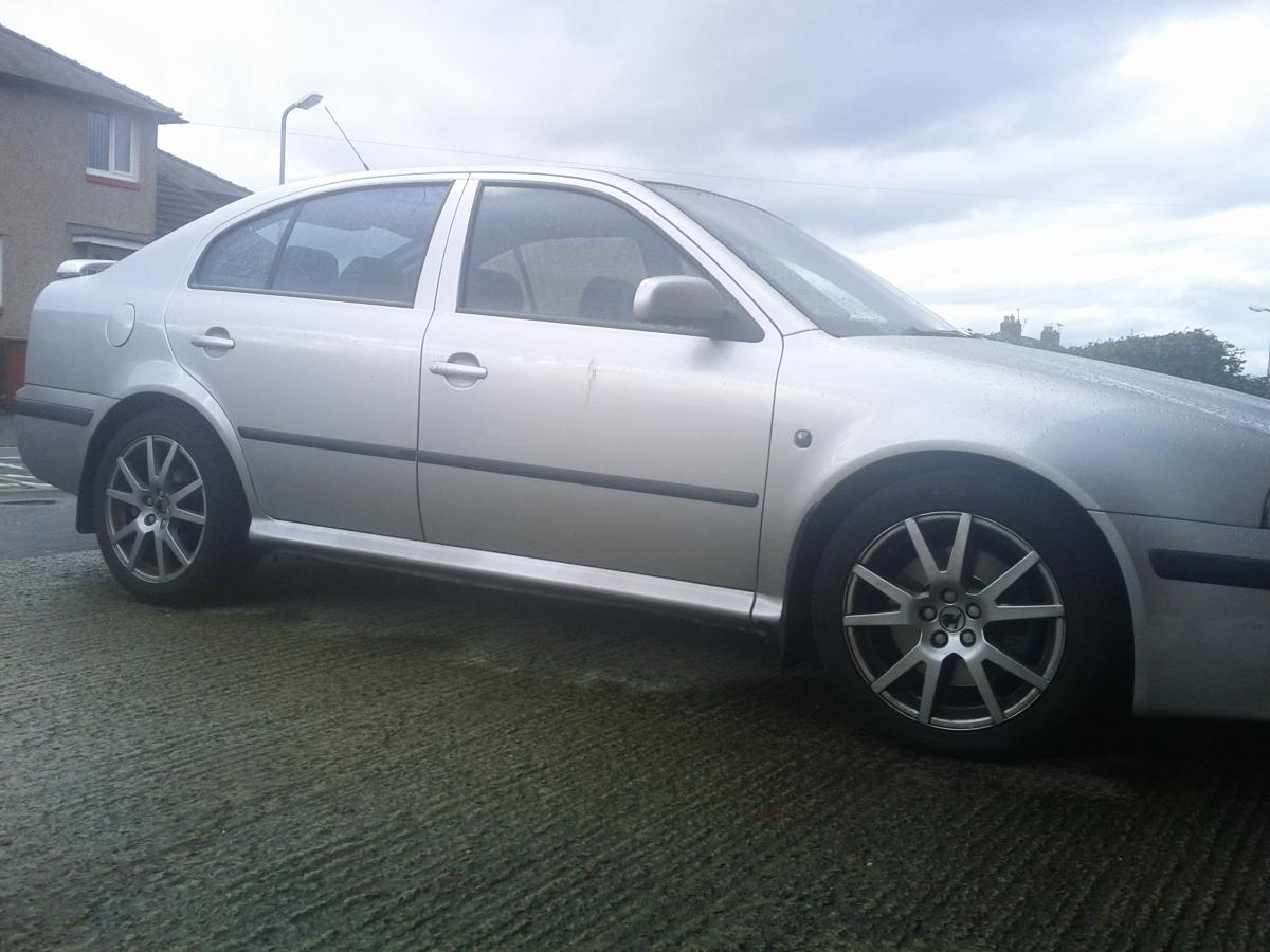

This is how mine was sitting 3 weeks after fitting 4 new shock absorbers with
the old vrs springs. I didn't actually measure anything but the height went up a
fair bit. Your shocks must be correct, as far I know the bracket on the shock where
the anti roll bar bolts to is specific to the vrs. So if that's where its attached
to they must be the right ones.
its almost like mine , maybe 1 cm lower anyway , as far as i will change back to 17" than i can compare better.

Finally got the suspension finished today raised the rear, as no one likes a saggy back end  :giggle:  Took it in to a mates garage and set the tracking up so she drives straight, all was well until the abs and asr lights came on at 70 mph gutted :wonder: Found the O/S/F wiring to the abs had rubbed through on the wheel, it was clipped to the shock in the correct place but as the wire is the same size but the new coli over is shorter. This created a loop in the wire that stuck out and fouled the wheel, so after a solder and heat shrink repair the lights are gone  :whew:  2hqqq8l.jpg
I'm pretty happy with the height and doesn't rub even with the kids and my sub box result. :rock:
