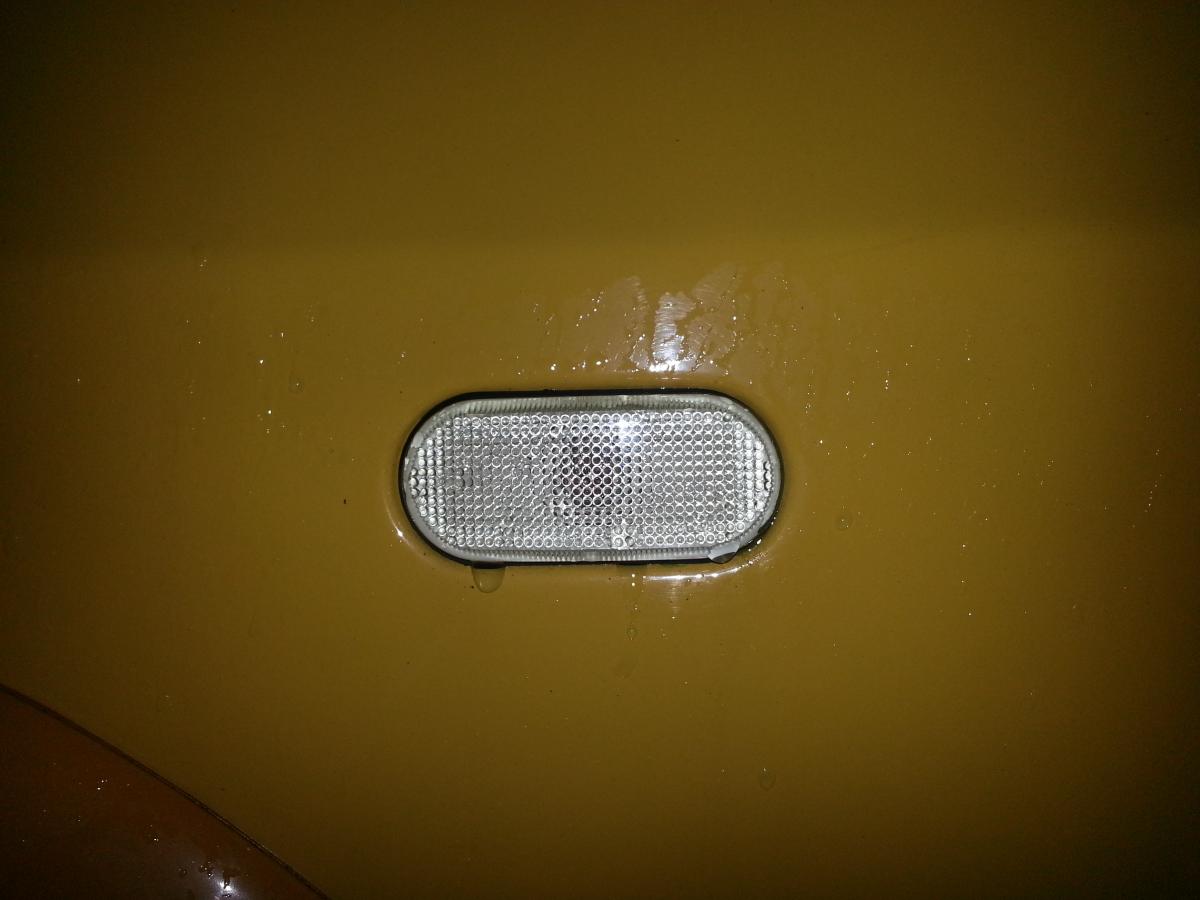

Same as a lot of vags. Mine were on a polo 6n.
and the 6n ones were the same as the original ones,because you can get the polo ones on ebay.
Other vag ones will fit but you will need to open hole and swap holders over with wire I have done this before I got mine from ebay you can use number plate lights but dont look that good
The 6n2 polo ones look nice, but as above, you need to open up the hole a bit with a file or a dremel.
Fair point I used the truck's holders. I did notice they weren't the best of fits in the polo but seem ok on the skoda, so I'm guessing it was a happy accident and they were a poor pattern fit on the polo.
