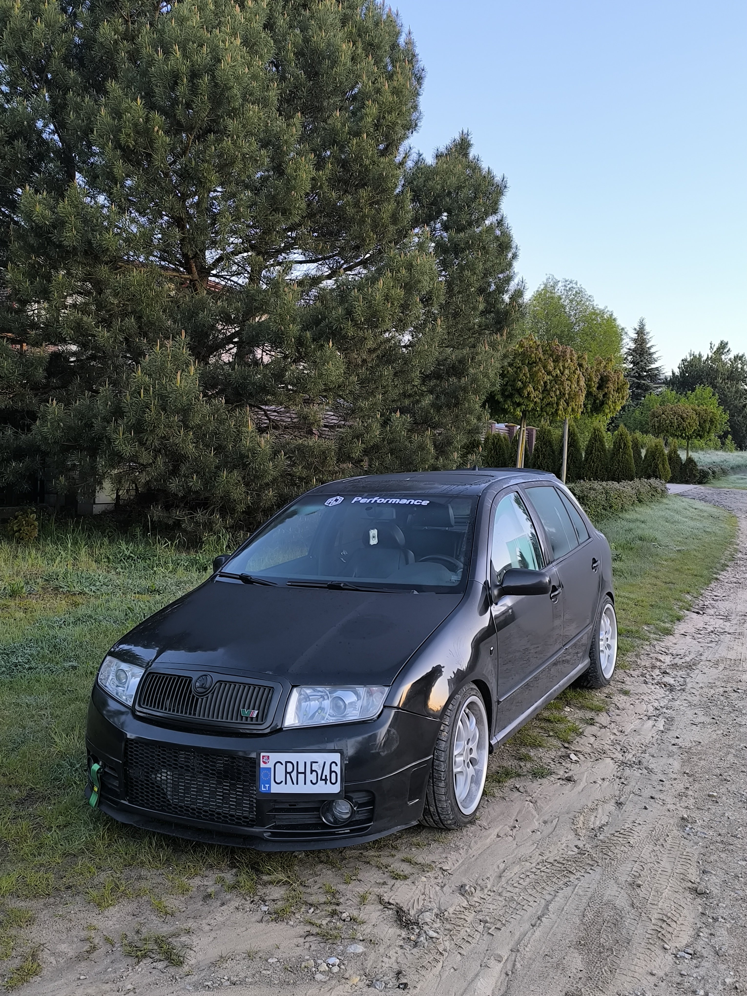

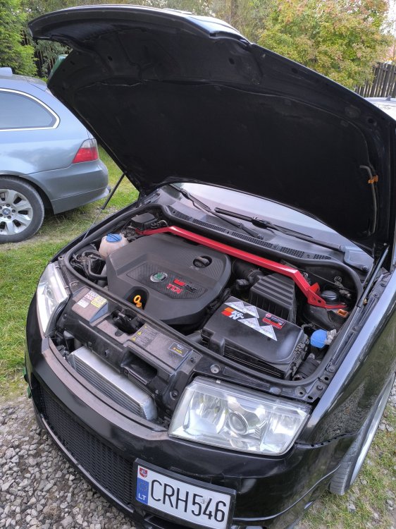

Hello all. I've seen this topic a lot of times, and I can say what rare parts I got, and retrofitting that i've done to my Fabia 6Y VRS
Exterior:
• OEM Xenon headlights,
• H7 LED lights in high beam,
• Double rear parking lights (one in oem position, and one T10 lamp in stop light section),
• Double rear led blinker and reversing lights (done from front blinker drl lights from AliExpress),
• Spoiler extension done from universal AliExpress spoiler,
• Front bumper chopped for intercooler air feeding in centre and side square license plate,
• Front and rear (80mm and 70mm) new style škoda black badges,
• Osram DRL/Foglights,
• Led stripes in bottom of headlights,
• TA Technics coilovers
• Soon will install auto tinting rearview mirror
Interior:
• OEM Fabia VRS steering wheel with Seat Leon 1M sport airbag, and small metal vrs logo in bottom,
• Seat Ibiza sport black leather heated seats,
• Audi TT metal knee bars,
• OEM Sunroof,
• OEM Maxidot cluster (from petrol version converted to be VRS),
• OEM all four electric windows,
• Fabia 2gen front speakers (rubber, 6Y was made from paper),
• 8inch AliExpress 2din android,
• Shortened gearstick and Golf 7 GTI gearknob installed,
• Airvents and smoker box covered in unpolished carbon film,
• All lights in interior LED,

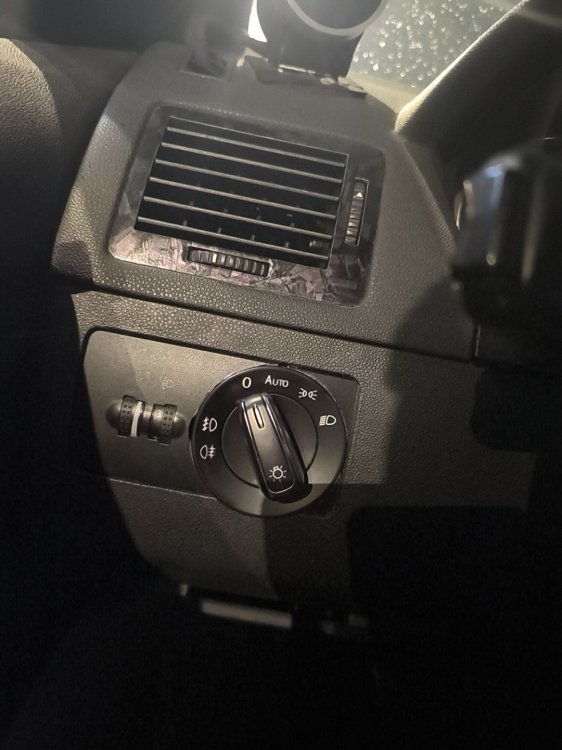

• Auto lights from Aliexpress with green lights and integrated brightness sensor
Engine:
• K&N sport filter in OEM filter box,
• 4 bar MAP sensor,
• Seat Sport Ibiza intercooler with all metal piping,
• GTB2056VZK turbo from BMW 3.0d F10 190kw,
• Full 80mm exhaust with RS6 style tip,
• Softcut limiter (OEM style)
Now pushing 165kw and 485nm, will be more after installing +100% nozzles. Aiming to 300hp. My project is to build Fabia VRS hothatch, that it would be from factory, with all of OEM options that was available and options that was unavaible like power folding mirrors, auto tinting reaviev mirror, maybe rain sensor and etc. I've changed my phone recently, so I don't have a lot of photos of my car, so that's all I have😅. Have scratch on my front bumper because of E39 driver that not noticed my car while parking

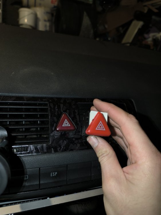

Some photos, that I can't upload to first post. And I found one modification is missing
• Hazard light button in darker "vine" color from T5 facelift (bolt on)

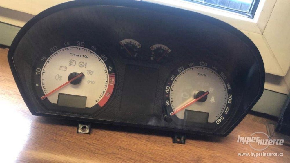

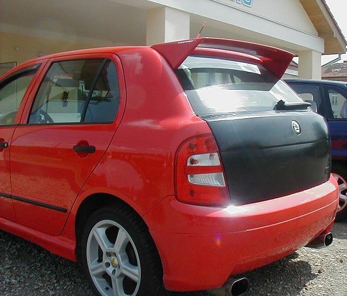

There's photo of spoiler that I'm thinking to install to my Fabia. Also I've found photo of VRS prototype cluster
