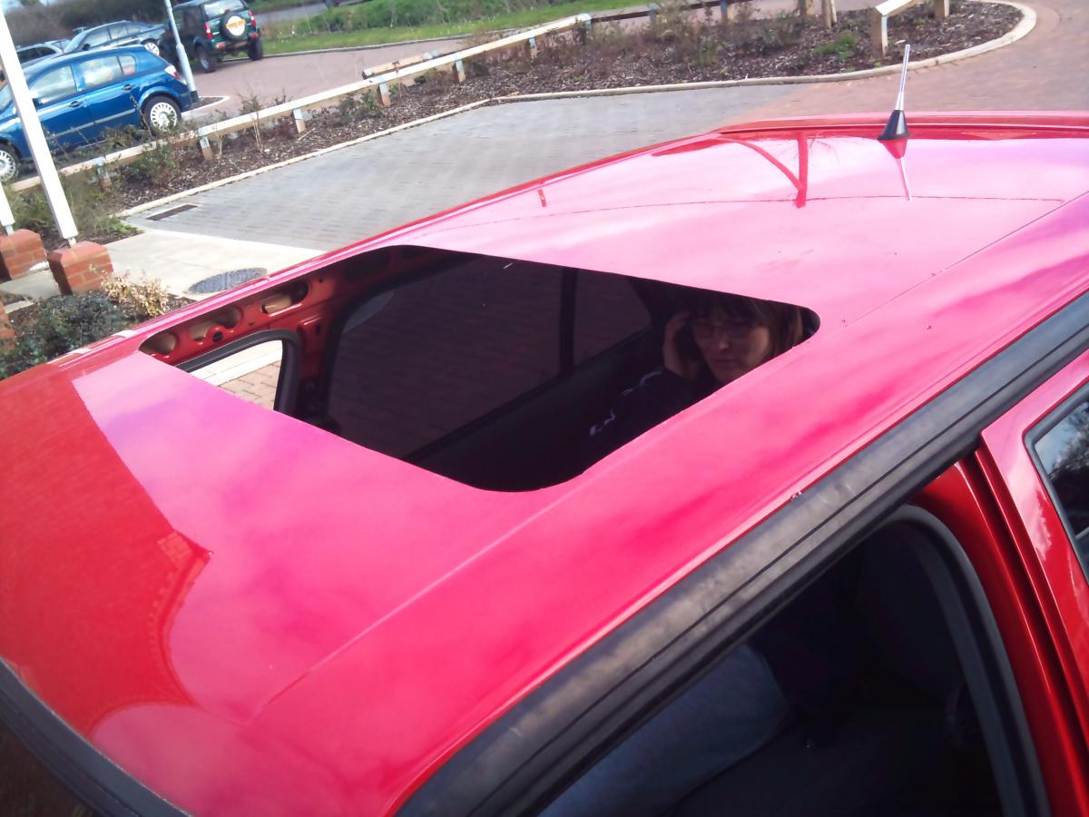

Well this news has rather pee'd me off, this morning I email sparshatts about a sunroof seal and they have told me it's not in stock and no longer made :/ they have given me this part number if this is any use? 6u0877941
Does anyone know where I can get on from? Pretty soonish too.
If it's between the frame and the car I unscrewed the frame, laid down a good thick layer of mastic and bolted it back in on top and it's not leaked since.
If it's between glass and frame that's leaking mine is better if I don't wind it fully down, don't know why, probably out of alignment. I just close it all the way then back it off a fraction of a turn. The original roof in mine was masticked shut. The one in it now is off one of my previous cars. A lot of people do just seal them down but I like it to open.
Mine leaks like crazy too, they all do I think, must have been a factory fitted leak. I don't know of anywhere you can get the seals any more now sadly..
Been ages since i did mine but bending the little pivot thingy a few mm worked for me
I fitted one to my slxi conversion from car years ago and sealed frame to car then found ot leaked on the seal prob because it sat for years I just ajusted the hocks bits been leak free ever since
not the best idea as ended up with air con....
