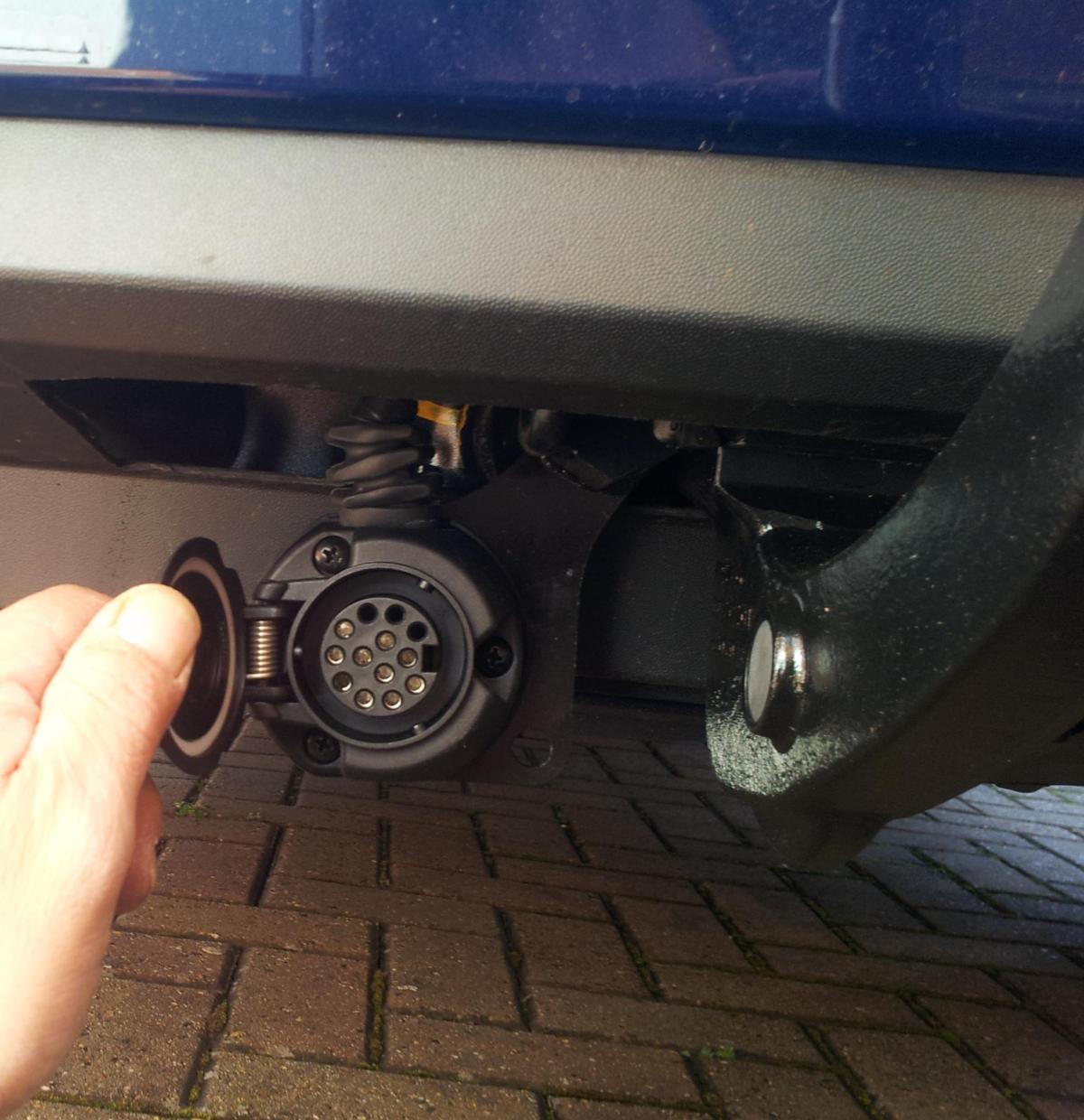

Nice smooth bumper cutting job :s

Not sure how to include picture in quote.
If you look at the picture in the original post of themanwithnoaim above you will see that several sockets have no brass contacts. They are not wired. These missing pins are for the split charge etc used for caravan towing. If you just tow a small trailer or use it for a bike carrier this is fine. If you want to charge a caravan battery and keep fridge cold while towing it you will need a fully wired socket.
Good point, we've only got a retro 80's style foldup caravan (called Mabel) and a dump run trailer so, it works for us but its gonna be no good for the big boys toys.  Either way the car's on a PCP so we went the dealer route to avoid any handback problems.
