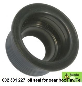

I´ve been driving with Skoda Felicias about 5 years, and by now I had absolutely no problems with gear box leaks. Until this summer. First I had a 96-Felicia spi in which there was that older type oil seal and gaiter, and it worked well in this sense, no leaks. It is now at countryside being a spare part car for my 98-mpi-Felicia that has now begun to leak.
At least in Finland it seems quite impossible to get that kind of old and little parts to a twenty-year-old Felicia. I  was in dark despair as I found out that that kind of parts were sold only in eastern Europe countries as: Poland, Czech Republic, Hungary, Turkey etc. And only the Czech company Skoda-Parts.com had sites in English. But they wanted 33,88 euros about the shipment to Finland, as the parts did cost 3,88 euros :)
But finally I could get that  transportation with only 10 euros, so today I ordered two pieces of part 002 301 227  and  one piece of part 115 292 800     So, now I am waiting for the parts to come from the deep south to this faraway polar area. But I mus say, that I personally believe that the older system was better. The gaiter in my old Fellow  protected that axle against stones, salt and so on, so it never began to leak, I suppose. Would anybody have anything to comment about those parts or the work that has to be done while removing the old seal and oils and then replacing the new parts and new oils? Any comment is welcome :)

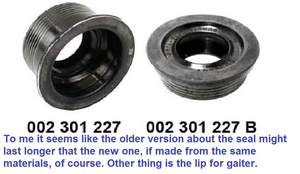

Hi Jussi
I vote for the older seal. Better design, lip for the gaiter.
Hi Ricardo, nice to hear about you :) It really seems, that at lest in this case the old seal is better as the new one.

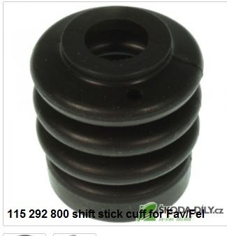

I just put one big photo here as a comic strip here to show how NOT to do this job. Naturally I also changed the gear oils (API-4  and semi-synthetic 80W-90 oil), but as the very honored member R_U_A_F_A has made a complete manual to this job, I just describe the seal and gaiter job. And because in Continent it seems rather difficult to get new OEM- parts, I thus share the links of the parts here directly. Both parts are for Favorit Skodas, but I believe that they today work better as the Felicia ones: https://www.skoda-parts.com/spare-part/115222290-seal-14x24-30x15-cz-11334.html for the seal and https://www.skoda-parts.com/spare-part/115292800-shift-stick-cuff-cz-1156.html for the gaiter.

Pic8 - that hole is there to avoid pumping effect of gaiter. When it get clogged, it can pull some oil from gearbox. That may be reason why Skoda switched to newer type.

the hole in the gaiter is to leak the gearbox oil when the seal fails
and:
Quote
This is the way I see these two arguments:
Ricardo thinks, the oil is not supposed to stay inside the gaiter, because it may damage the rubber. And also the oil might cause dust, sand etc. to gather round the axle.
Papez thinks, the hole is there to avoid a vacuum-effect so that it would not pull oil from gearbox.
And 4 years ago R_U_AFA thought: "Fitting the gaiter I noticed that it had a hole in it, presumably to let the air out when it's compressed. So I've put the hole facing the underbody,to keep out road dirt." So, I assume that he presumed the gaiter being so tight that it would not let the air out, which is a relative to the vacuum-theory.
I think that all the 3 theories are good and acceptable. But the question remains the same: Must the hole be directed up or down? Or, as a compromise, to the left/right? :)
The crucial thing is, however, to keep the hole open, I suppose!
