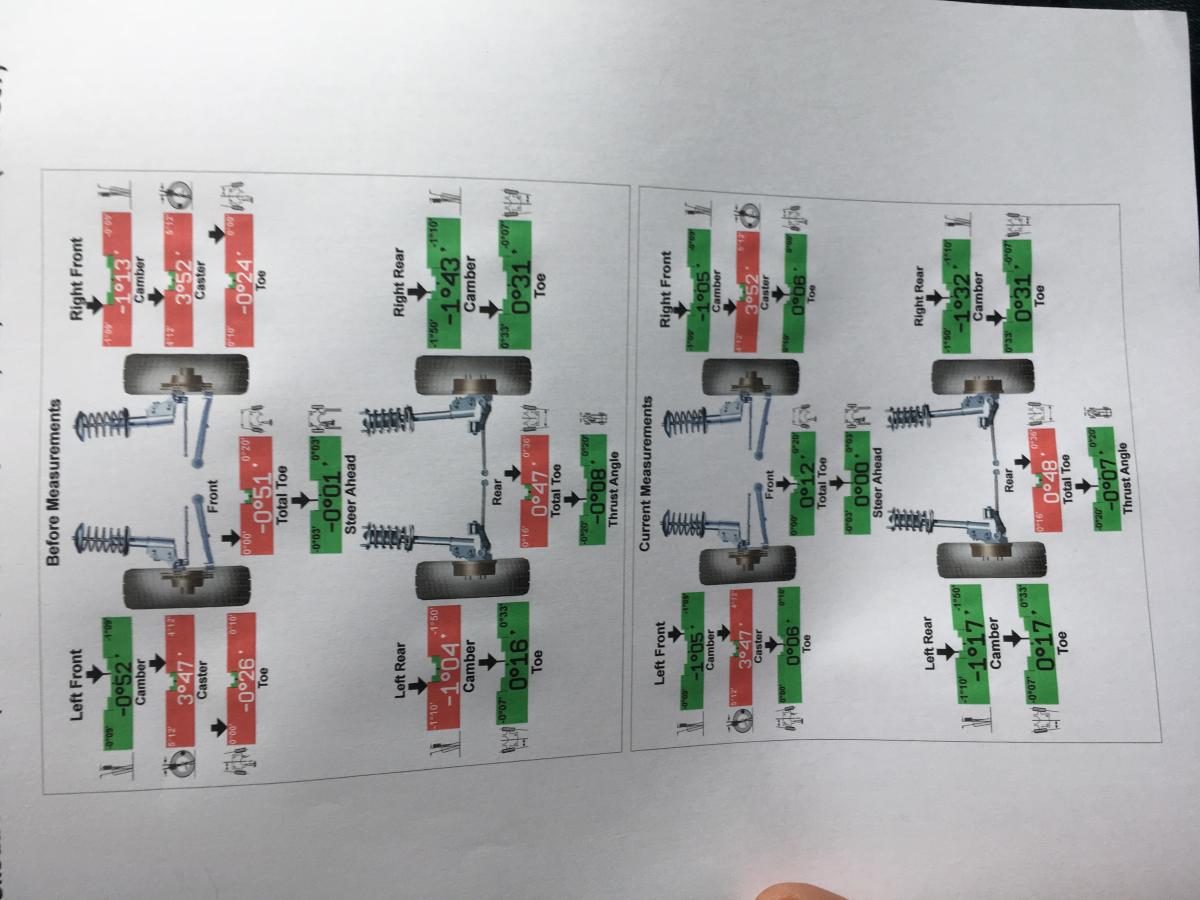

Mine was pulling to left when I brought it, so asked dealer to do it and when I collected it. Still pulling. Tyres on front were slightly different in wear rates so swapped them and it did help.. however went for a hunter alignment and it's now completely straight and drives lovely

A tyre change does not fix misalignment just disguises it.
Which was why Skoda UK paid to have the harder sidewall Pirelli Zero Nero fitted rather than fix the cars with pulling to the left.

Simples really. so to explain in easy to understand terms.
The Directional tyres are not at fault, they just show up the fault in the alignment and the none directional tyres disguise it.
As offski said I had my car setup at 2 well known garages locally and it still did it  :peek:
Soon as I switched tyres the car drove spot on  :dull:
