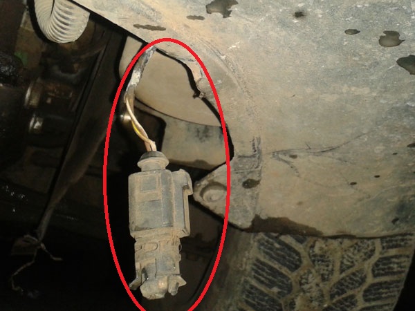

I looked under my car last night and saw this plug sticking out. It's sticking out just behind the front bumber on the drivers side, just under the battery area. Is this what's causing the issue? If not what is it? I can't find where to plug it back in to,

Concerning the picture I posted above (not the best pic), anyone know what that is? 'Cause I tried looking for where it fit in but just couldn't find any.

The stuff in the pic is the Airbag sensor BTW. That got hooked back too.
