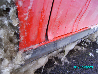

Water retention in the door sills is not normal. Golf 5 had a similar problem. And in winter when that water froze, the door would bent when you tried to open it.
I highly doubt that, I can't see a human having the strength to bend the door because it's frozen shut. You'd break the handle off first, if you had the strength.
And it is normal, every VAG car I've know has done it and even SUK say it's normal.
I'm highly sure of that, having owned a golf mk5. This is what happens and next time you see a golf 5, check out the front doors.
And if you're still not sure just google "golf mk5 ice doors". There are many more pictures like these and posts on vw forums. golfmkv.com has plenty of them.
VW even admitted to this problem and even issued a service bulletin on this. Whoever wanted and knew of this service info could take his golf, if it was still in warranty, and the service would mount some water stoppers in doors that would prevent water retention at the front of the door. But although they admitted this problem, they did not change the production line. Golf 5 were all produced without those additional water stoppers.
That's quite some damage but I guess it's no different to freezing water splitting pipes; don't think many people realise water expands 10% when frozen compared to only 4% when heated up to boiling point.
