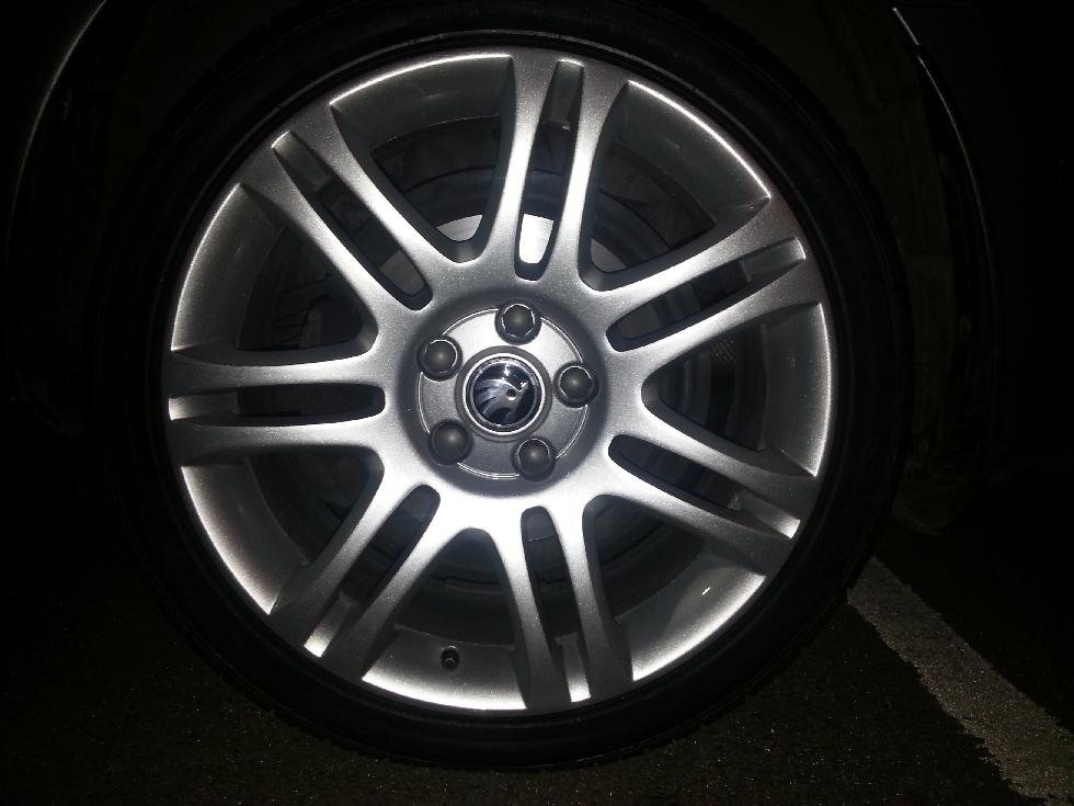

My Thermisto's were shot, one in particular, once the laquer has come of diamond cut alloys they corrode like mad, I had had a quote to have them re-diamond cut but it was £150 a wheel, nearly the price of a new wheel! My Dad works at a crash repair centre and they sudgested having them painted, I was a bit unsure about this as I love the look of Diamond Cut wheels but only when they are new! They did say that with primer, base coat, 2 top coats and laquer they would be a lot better protected and also the fact they would do all 4 wheels for me for £150 instead of the usual £50 - £60 a wheel, it was a bit of a no brainer so had them done last week! So glad I had them done now as they look brilliant and you wouldn't know they shouldn't be painted wheels!
Image added below now
Edited by bryanp
This is how they look painted, sorry its at night but I think you'll still see how good they look, worth it I think, what you think?
Edited by bryanp
^^^ For £150 for 4, looks really good Bryan.

Those look sweet fair play Bryan.  Better than the originals if you ask me lol
