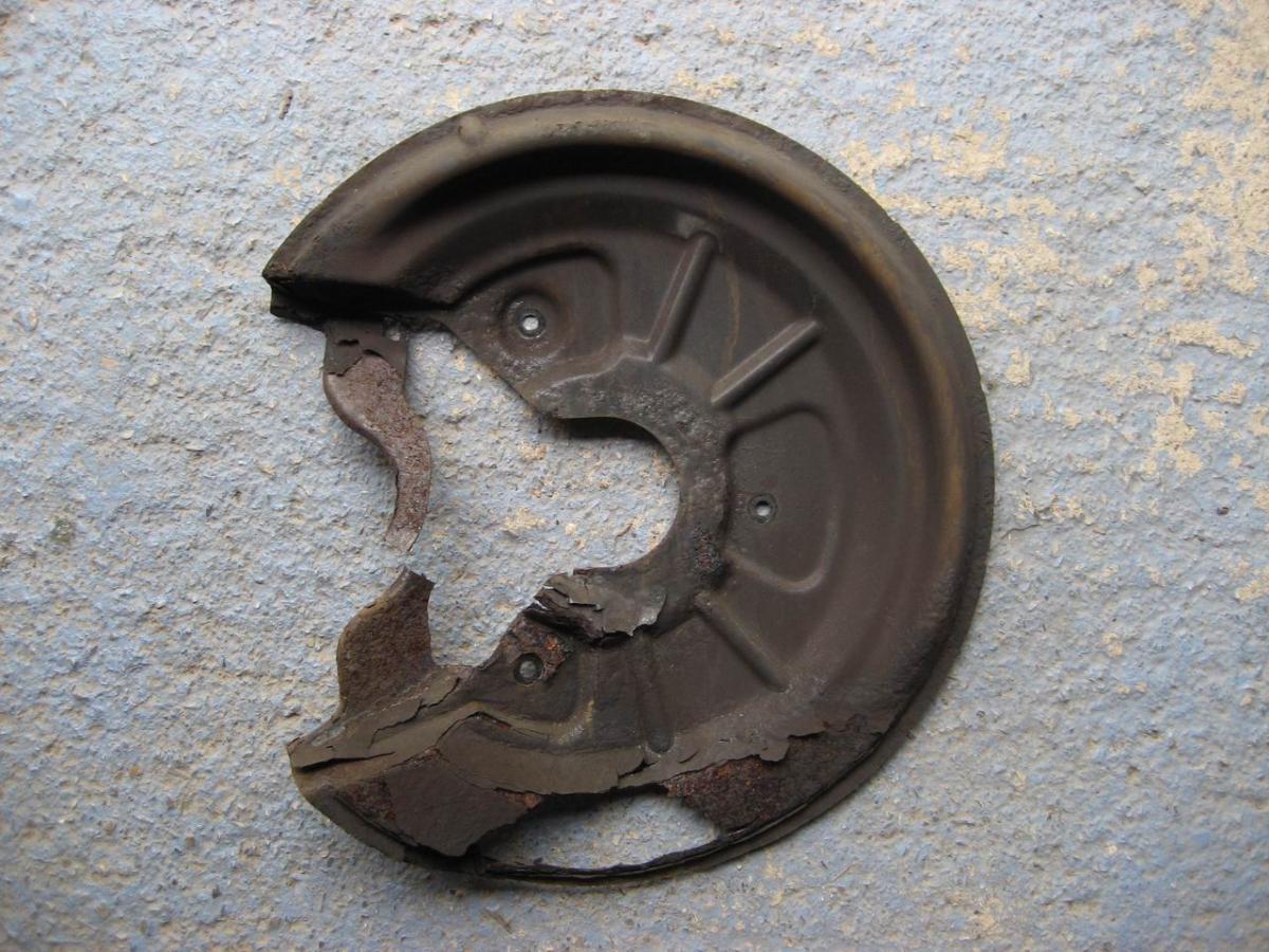

All 4 of my brake disc shields have badly corroded. I have replaced the front ones which was quite straightforward. I have now started on the rears but discovered that to do them properly you have to remove the hub.
The front shields are shaped like the letter 'C' and can be slid behind the hub without removing it. The rear shields have a large hole in the middle rather than being 'C' shaped but the hole is not large enough to fit over the hub. See the attached pictures.

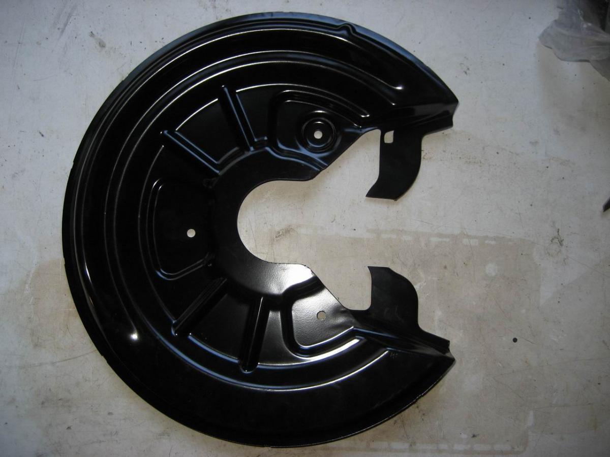

Thanks for the info guys. I'm going to cut the new shields and avoid interfering with the hub. I'll try to take some pictures and post them after I've done the job.
I did the job today; it probably took me about 1 hour per side. Here is the procedure on a 2005 Octavia 2.0 TDi.

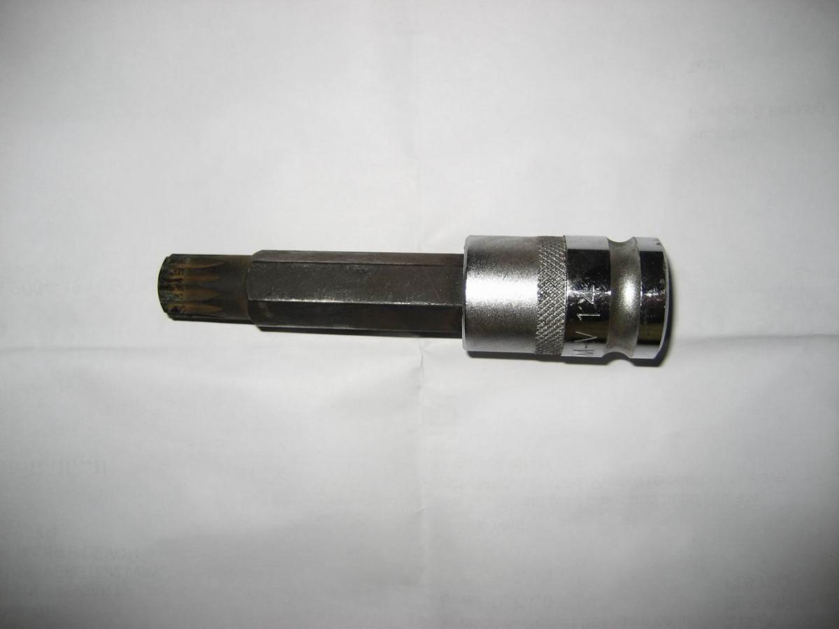

  4. Remove the brake calliper carrier mounting bolts (M14 splined tool). These bolts are very tight so make sure that the tool is FULLY inserted before applying any force. If you are doing the job on axle stands then you will need to be cunning with how you loosen them. I had a long M14 spline bit (see photo) which allowed me to attach a ratchet at one end on a long extension and fit a large adjustable spanner across the flats of the bit. I pre-load the ratchet using a trolley jack under the handle to apply the force. I then used a small lump hammer to hit the handle of the adjustable until the bolt finally 'gave'.

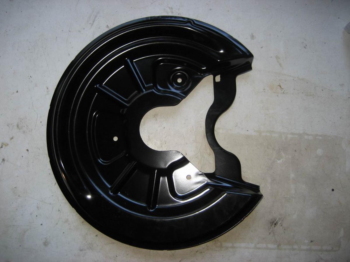

  12. Cut a 55mm section out of the new shield (see photo), de-burr and paint the cut edges.

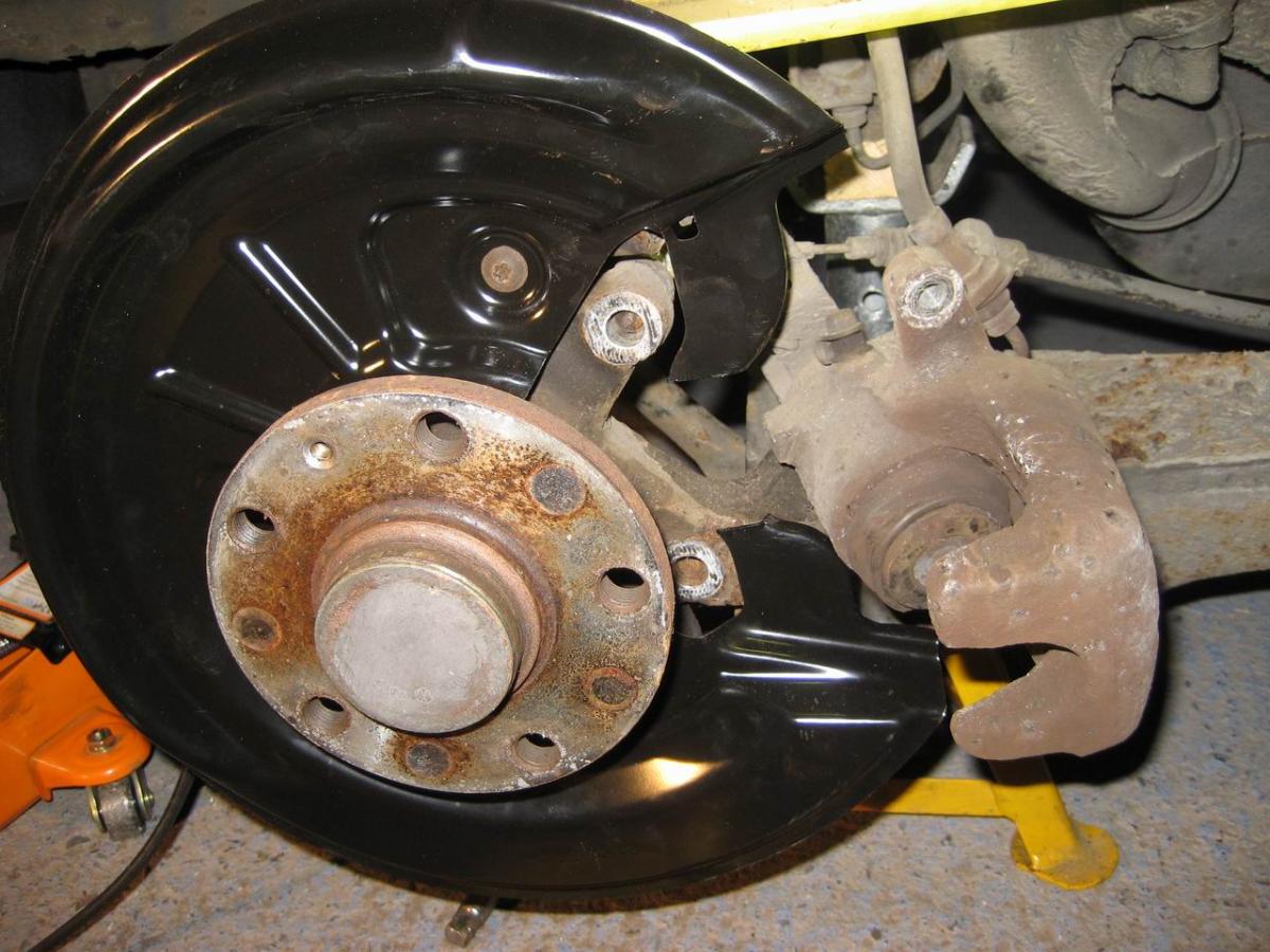

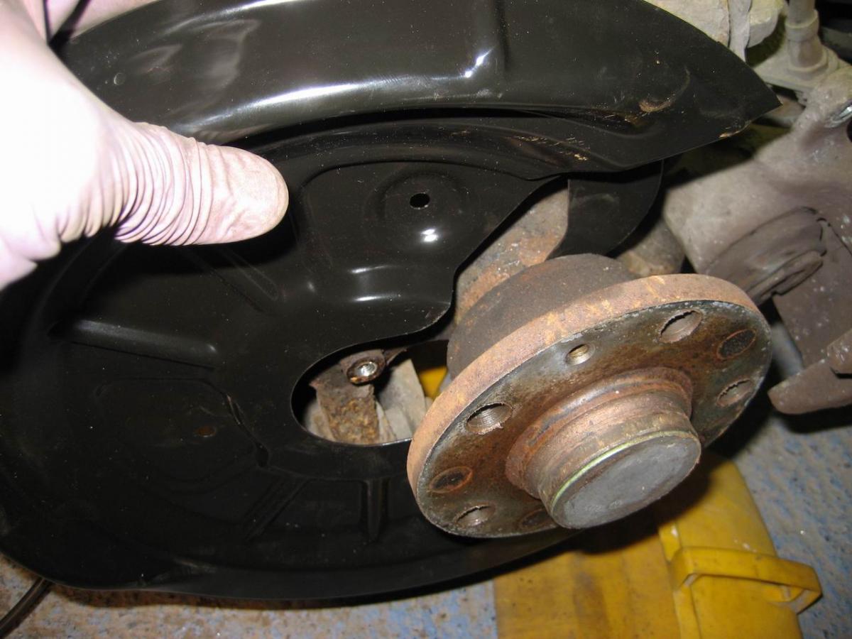

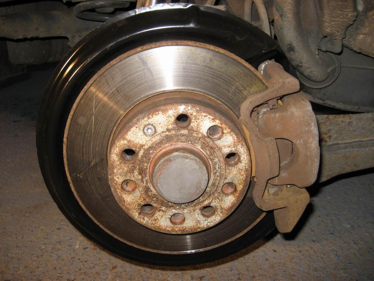

  14. Slide the new shield in place and reassemble.
  15. post-72827-0-66359500-1397145577_thumb.jpgpost-72827-0-90444100-1397145585_thumb.jpgpost-72827-0-72240200-1397145596_thumb.jpgpost-72827-0-15672600-1397145621_thumb.jpg
This procedure avoids having to undo the hub bolt which requires an M18 splined bit which needs to be replaced when refitting. I am unsure as to the purpose of the disc shields but the manufacturer would not have bothered to add weight and cost to the car had their engineers not believed there was good reason.

The only thing I found is you need an M14 spline bit with a relatively short spline on it else if fouls on the hub / wishbone or somthing (can't remember now). The one I bought originally had a 80mm length which was too long.
