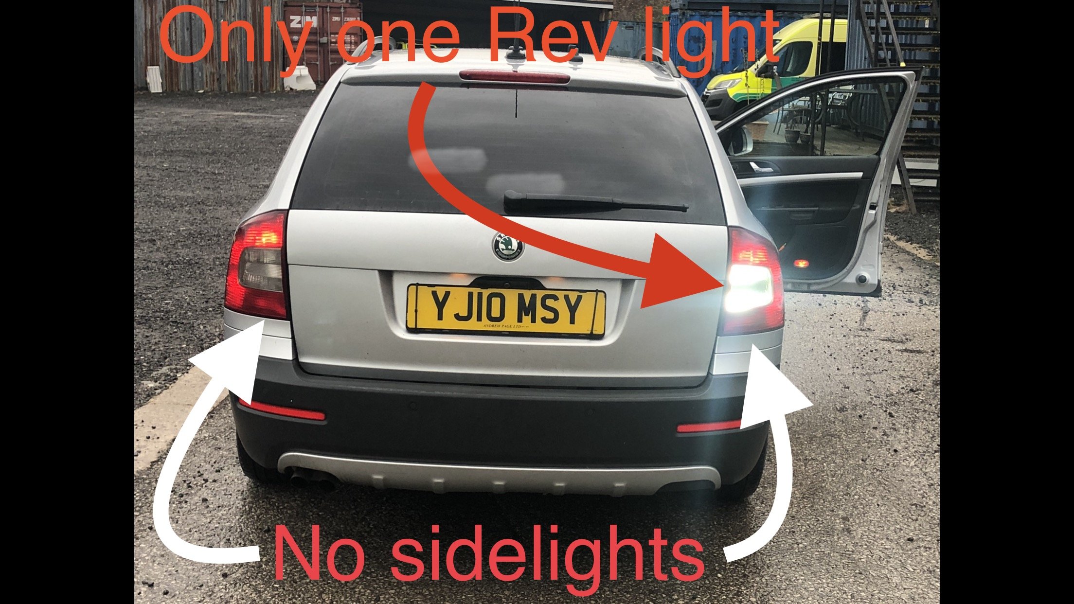

Hi do you have the codes or the number or the no how to make my Octavia rear lights light up properly?? Long story short I’ve some how messed settings up using my snap on Ethos Edge on latest software... I was playing in central electronics then functional tests, then selected parking light activation menu and just messed about... stupidly now (my own fault) on side light it’s just the top and sides NOT the full Skoda “c” for rear sidelights, also when I open the boot the side parts turn off till I close boot lid, oh and I also lost passenger side reverse light. NO bulb failure warnings so I tried the same on a sister Octavia thinking I could copy setting but I cocked that up aswell, any help greatly appreciated.
 Many thanks
FINALLY  managed to sort it out, noticed side lights/tail lights have been quite dim since cocking the settings up and loosing the lower half... so on the diagnostic and changed vehicle type from Octavia sedan too superb combi/station wagon and all rear lights are fine, brighter, full Skoda “C” for sides/tails and also both reverse lights and everything stays illuminated when I open the tailgate.
 The only real difference is that it now has both rear fog lights working instead of just the driver side.
