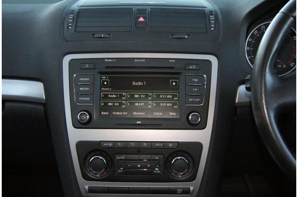

Hi,
I would like to get hands free in my car and do do this I have a few options.
Retro fit a parrot blue tooth kit which I dont really want to do as I like a clean dash board!
Replace the existing head unit (picture attached) with an after market option or Skoda original kit.
Has anyone done this and got instructions?
Would you go after market brand or Skoda?
If I have a head unit with satnav I guess I will need to run a GPS areal does anyone know or have instruction on how to do this?
Thanks
Mat
You can get handsfree with the Bolero you have by adding an OEM module, loom and mic.  Loads of threads on here which give instructions on how to do that, which costs around £150.  For satnav you would need a new unit, apparently some of the OEM Amundsen+ units also do bluetooth, and some also do DAB, or you could go for a Columbus head unit, but like your Bolero, it would need the separate module fitting.  Otherwise its mainly aftermarket, but there are plenty of reviews of those on here too, and they are all reasonably easily fitted I believe.
The GPS antenna simply fits behind the unit, many are magnetic and are very easily fitted.  Users on here report good results with this.
