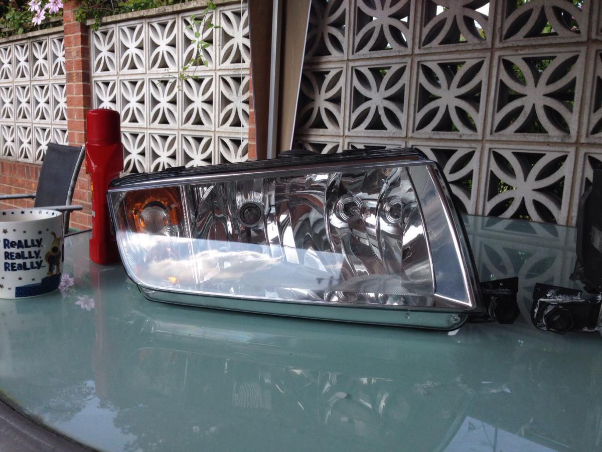

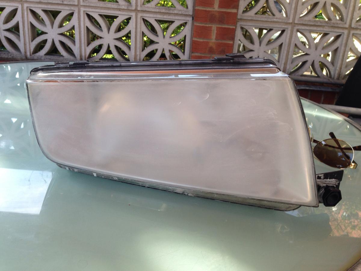

Polished the chips out of the headlights
Well after 116,000 motorway miles the headlights get rather peppered so a Polish was in order. Well I say polish!! Da sanded with 320 grit, then 400, 800, 1200, 3000 wet and dry and then polishing mop.
Struggling to get both photos on so will try and post other photo with a reply. Not too smart at this tech stuff lol.
A fare transformation me thinks.
Oh no will have to try and shrink the file size!! Will be worth the wait honest.

Here we go.

Very good.
Did you try buffing with T Cut first ( unsuccessfully p'raps)?
Incredible. Look brand new! :)?
that is one good looking headlight!
Great job!
Headlamp looks amazing!

No didn't,t t cut as wanted to sand most of the deep chip marks left by all the motorway miles.
They look fab I must admit. Really pleased with them.
