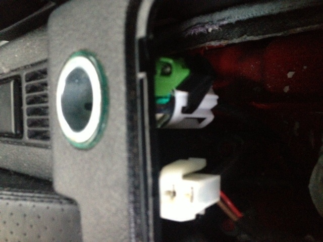

Hopefully someone can set me straight and rescue my scratched hands. My son ripped a gadget out the cigarette lighter and the end got solidly lodged. I started to take the whole unit out figuring I can work at it or replace it that way. After working my way into access it and unplugging the power I realised that that fuse protruding from the side seems to stop the unit popping straight out the top. I've tried turning and pressing it from all angles but can't for the life of me work out how to seperate this and get the thing out. Any suggestions gratefully received.post-117376-0-87565900-1400529071_thumb.jpg

The white block in the photo is the power leads which were removed from the bottom of the lighter. Don't think I can get a screwdriver underneath it though without taking the whole console out :(

the fuse  on the side is the tiny bulb for lighting up the unit.
the easiest way it take the centre console cover out, then turn it upside down to get at it.
the bulb holder unclips - gently or it WILL break, then you have to prise the entire unit up through the top o the cover to get it out.
