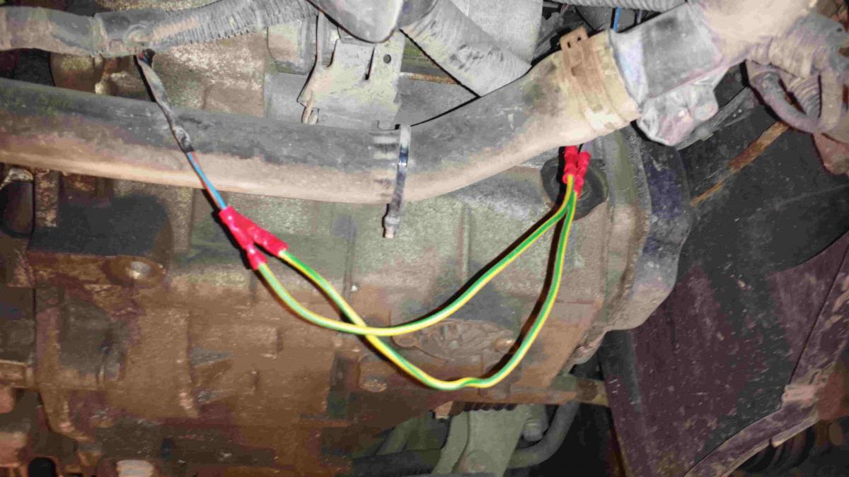

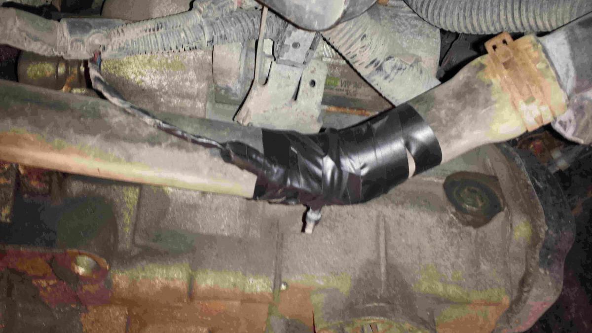

ESP problem SOLVED!!I have now found and sorted the esp problem! It was a broken wire as you linked to! The wire and connector is located behind the radiator. You have to remove the plastic cover under the engine but in my case is it missing so i found it dangeling immediately. I realized that I saw it a few month ago when the car was at the yearly safety inspection.
how to fix it!
I just removed the connector and put a straight cable between instead :)
I post a few pics so you can see
